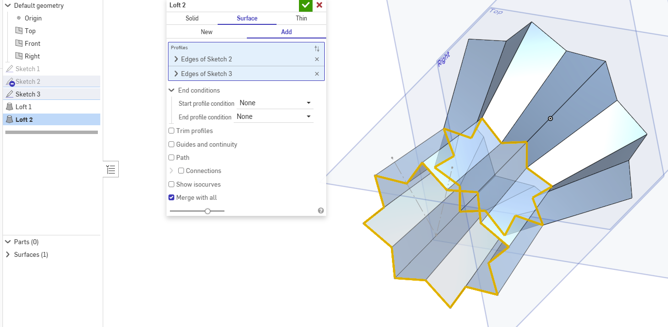

Can anyone tell me why I can't loft this again? They are both surface lofts, if I do solid they generate, but surface do not.

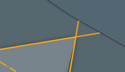

Your "sketch6" has overlapping segments and you didn't select it the same way.
It worked on for the first loft because you picked a "face" (and onshape uses the boundary of that face), but you selected the sketch from the feature tree on the second loft which adds all the "edges" in the sketch, which overlap.

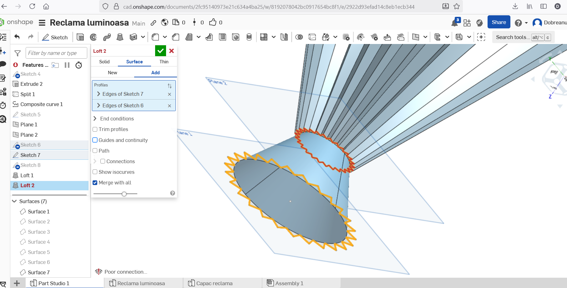

Not sure what the problem is. If you could provide a link to your public document.
this is the file
https://cad.onshape.com/documents/2fc95140973e21c634a4ba25/w/8192078042bc0917654bc8f1/e/2922d93efad14c8eb1ecb344
Thank you! I didn't see the overlapping.
