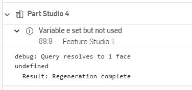

I don't seem to be able to get the form featurescript to work. Any ideas what I am doing wrong???
I am importing a form part studio TEST_FORM::
var pointSketch = newSketch(context, id + "points", {
"sketchPlane" : qCreatedBy(makeId("Top"), EntityType.FACE)
skPoint(pointSketch, "point1", {
"position" : vector(1, 2) * inch
skSolve(pointSketch);
var formLocation = qSketchFilter(qCreatedBy(id + "sketch1", EntityType.VERTEX), SketchObject.YES);
var targetFaces = qContainsPoint(qActiveSheetMetalFilter(qEverything(EntityType.FACE), ActiveSheetMetal.YES), vector(1 * inch, 2 * inch, 0 * millimeter));
debug(context, targetFaces, DebugColor.RED);
try
var form = sheetMetalFormed(context, id + "TEST_FORM", {
"formPartStudio" : {
"buildFunction" : TEST_FORM::build,
"configuration" : {
"thickness" : 1 * millimeter },
"partQuery" : qEverything(EntityType.BODY),
} as PartStudioData,
"locations" : formLocation,
"flipDirection" : false,
"targetFaces" : targetFaces
println(form);
catch (e)
println("Form Feature Failed");

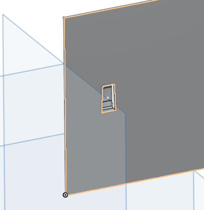

This returns the part with the location on it
But throws no error, even though the form is not made

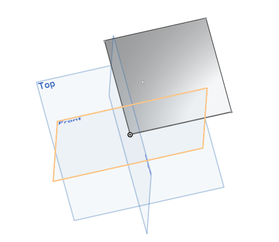

The code as you posted it has some errors with the formLocation. The sketch id is incorrect and formLocation is an empty query.
I think the location parameter also need to be on a sheet metal face, just based on the sheet metal form feature.www.smartbenchsoftware.com --- Renaissance --- Kestrel -- SmartLink
