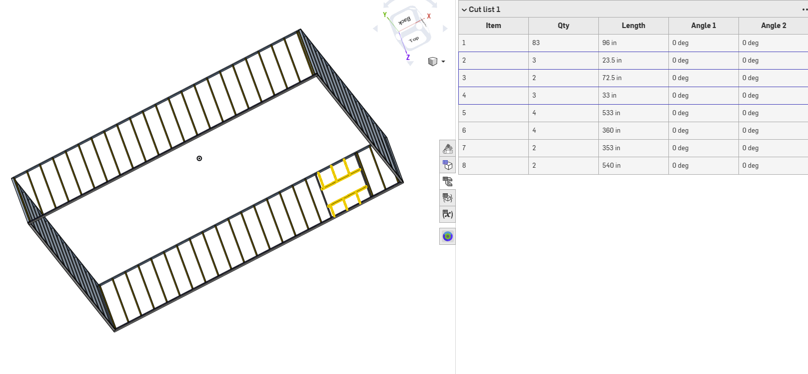

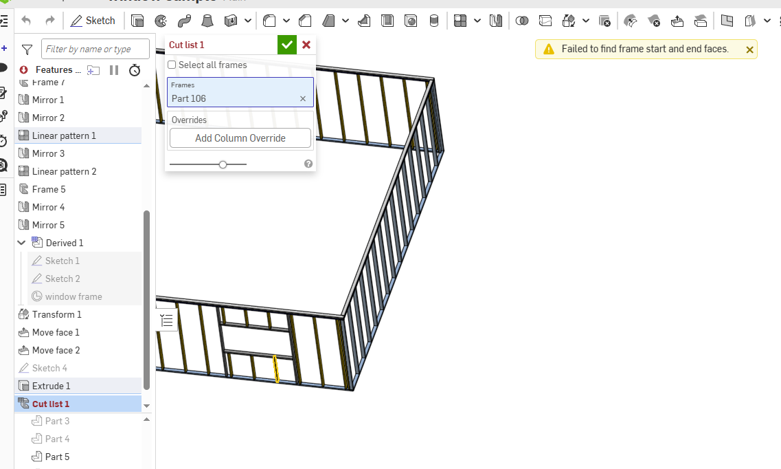

Here is an option for you to look over and decide if it's something you would like to try. Window parts are derived into framing and adjusted there. Don't fallow the framing methods I know that are not exactly kosher.
Some of the trimmed studs are problematic for making a cut list. Maybe someone can make a suggestion. I'm too tired tonight to continue.

With some changes to method I got a cut list. Will be a bunch of work to cut out window openings by this method. Not my favourite yet. I'll spend more time later to simplify since I may have to do some of this myself over the winter. Would be convenient to work in feet and inches for this kind of stuff until everyone gets converted to metric. LOL
