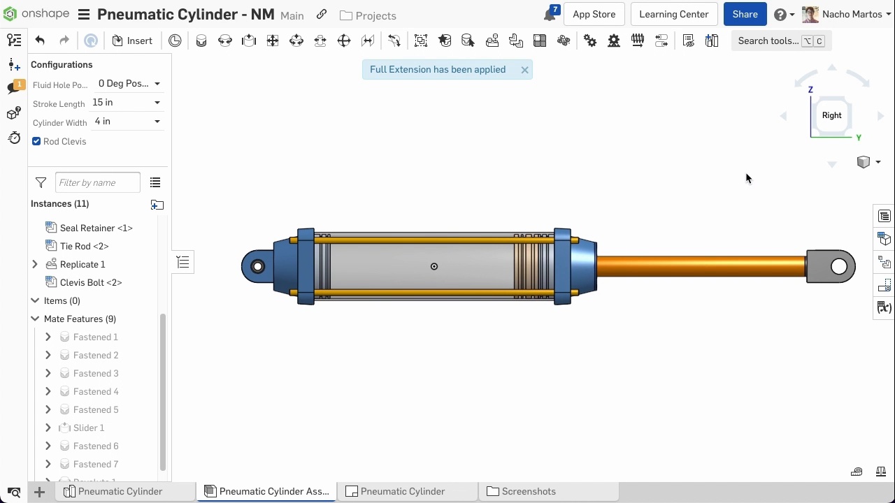

    You can definitely show more than one named position on the same drawing (see improvement video below), but to do two in the same view I would probably create a separate dummy assembly which does it.
    a7a255375ce94d58e74a30fcdcc0ef2fd5cff33f.jpg?image_play_button_size=2x&image_crop_resized=960x540&image_play_button_rounded=1&image_play_button_color=00890be0
    Improvements to Onshape - June 27th, 2022 — Onshape
