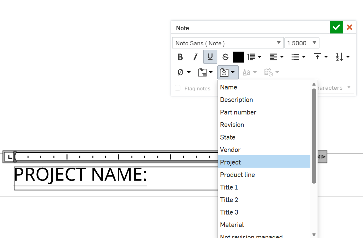

Hi,
I would like to automatically link my project name attribute into my drawing, however when I try and do this it doesn't seem to link, I just get '——'
Where is the 'Project' attribute stored? Ideally i would like to link the document name as the project. I might be missing something…

    For individual parts you can find the project property by right clicking the part in the part tree and going to properties… or right clicking the part studio tab and clicking properties then expand the tree and click on part. For assemblies you can right click the assembly tab go to properties or you can right click the top level assembly in the tab and go to properties

    Thank you!
