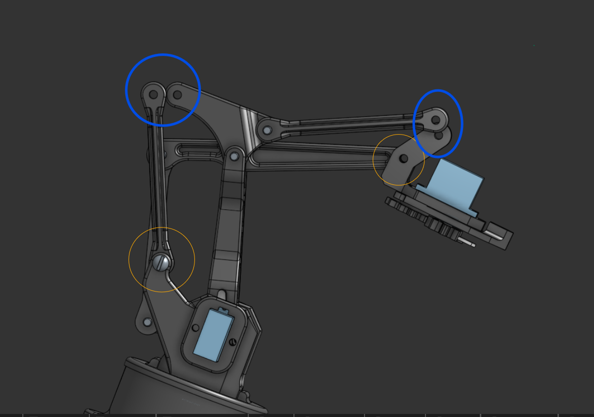

Why does this assembly fail when I add one more revolute mate?
This is a robot arm design I created based on a reference design I found online. However, when I try to connect any two of these blue-colored parts using revolute mates, one of the joints (circled in orange) fails to work properly. They move in a different way, losing the revolute mate-connecting the joint…
Does anyone have an idea why this happens or how I can fix it?
Thank you… I’m still learning and would really appreciate any guidance!

    I would probably change how you approach mates a little. Let the bolts be the last thing you mate. connect the holes to each other first so that you can easier troubleshoot where the problem may lie.
  • eric_pesty
    The revolutes are likely "fighting" each other in the "Z" direction.
    Change some of your revolutes to cylindrical to fix the issue
