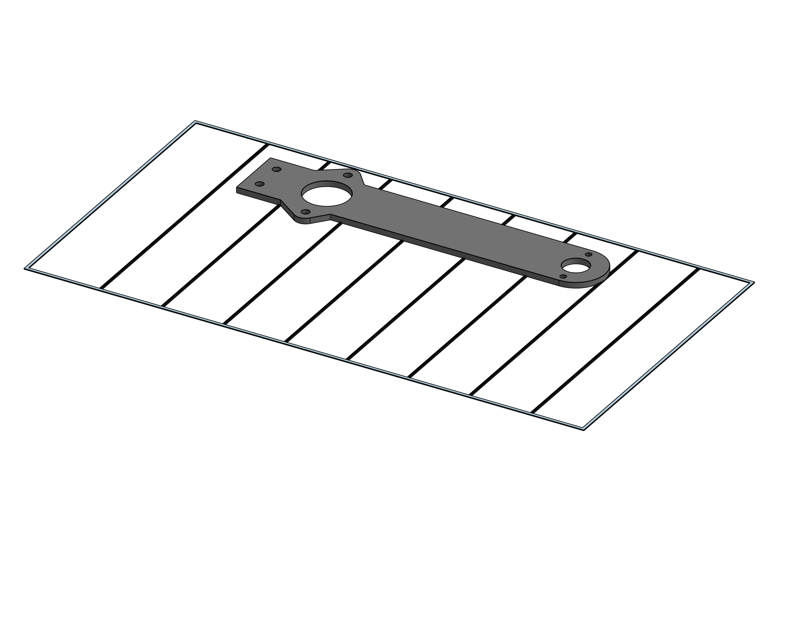

    So far, CAM Studio has been promising for single-part workflows. However, when I import more than one part at a time, each part is placed relative to its own origin and cannot be moved. Currently, we use HSMWorks, and for multi-part operations we create an assembly and then generate the CAM from there. In the assembly, we can sketch the work area and position parts exactly where we want them.
    I’m wondering if there is an easy way to do multi-part operations in CAM Studio without having all the parts in the same Part Studio, since our team often has subsystems in separate documents. Another issue is when we want to machine multiple copies of the same part—such as gussets—each imported instance ends up in the exact same location because they all reference their original origin.
    Assemblies also help because not every part is modeled from the same reference plane, but for manufacturing the orientation must be correct. In assemblies, we can reorient the parts so they match the correct manufacturing planes before creating the CAM. I’m trying to figure out if CAM Studio has a similar workflow or workaround for this.
  • ross_pettingerross_pettinger Member Posts: 9
    I agree with this 100%. Sometimes we are trying to make 16 copies of the same part out of one piece of sheet metal stock. It would be nice if parts in the CAM studio could have x/y offsets, rotations about z and maybe even be flipped over so they can be placed for the most efficient use of stock material. It would be great if they could be drug around and rotated almost like parts on an assembly tab, but manually entered offsets would also work.

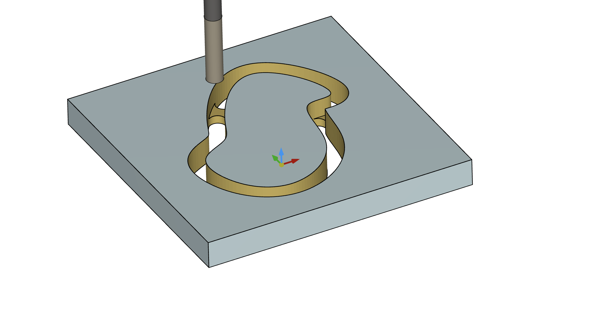

    I have a simple 2D part that I would normally use V-Carve and a ShopBot2418 to cut. After lots of trial and error in CAM Studio, I'm stuck trying to figure out how to 1) place the work at the machine center and 2) how to get the toolpath to cut an Outside cut instead of an Inside cut (which is a checkbox in V-Carve).
    Solution: Choose Loop, not Contour, and then use the directional arrow to change innie or outie

    I'm going to start with a little background, I have been writing computer software for more than 35 years. I do a little mechanical design and manufacturing to help a few different high school teams, primarily FRC teams but not just FRC. I don't have a machining background so some of the terminology used is strange to me and I may say some things that don't make sense to people that are more familiar with this stuff.
    These comments are intended to be helpful feedback with the understanding that the CAM Studio is still in beta.
    I have spent a lot of time over the past several days trying to become comfortable using CAM Studio so I can teach students how to use it. I have mostly been focusing on use with a CNC Router -- cutting parts out of sheet metal.
    To me it seems like the software is close to functional, with some appreciated yet less than ideal solutions and workarounds for current shortcomings provided by people in this forum.
    From a software interface perspective, it feels like the CAM Studio was written by a different organization than those that wrote the CAD side of OnShape. Some items that could change to make the software parts seem more integrated:
    - Use the view cube from the part studios and assemblies instead of the collection of buttons for changing between different views
    - Make the "feature tree" more closely match those from the parts and assemblies, same font and styling, the eye on the right for hiding and showing things (instead of a checkbox), right-click on the feature name to get a popup menu (instead of the ellipses), don't number the items in the feature tree, etc.
    - When editing a feature, open in a dialog box that can be moved around, instead of taking over the feature tree, the dialog should look like other OnShape dialogs
    - Allow for the selection of parts (components) and multiple parts from the feature tree
    - Start with an origin, allow for mates (maybe only fasten mates) between the origin, the stock, and the parts to be made with all of the normal mate capabilities (flip, rotate, offset, etc). I think connecting the stock to an origin would server the same purpose as defining a position, directions and offsets in the setup, Would probably want a warning or error if a part extends beyond the bounds of the stock.
    - Allow for inserting multiple parts at the same time -- just like inserting parts into an assembly
    - The icon used for "Post child operations" to export the gcode is not obvious
    - Allow individual tool paths to be exported, maybe also allow paths that use the same tool to be exported together -- I think this makes it easier to do manual tool changes
    I know most of this isn't changing functionality, but I think consistency in the interface will make it easier for people to learn and use.
