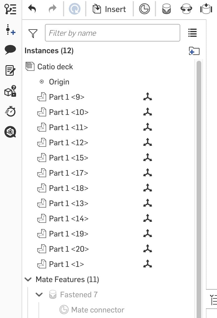

Hi,
Still a newbie!
In an assembly it would be useful to see the name of the parts in the instance list. At the moment all I see is Part 1 <9>, Part 1 <10>, etc when it would be useful to see the actual name I gave it in the part (i.e. the names I see in the tabs along the bottom).
Any help to get on how to display the name in the instance list would be great.
Many thanks.

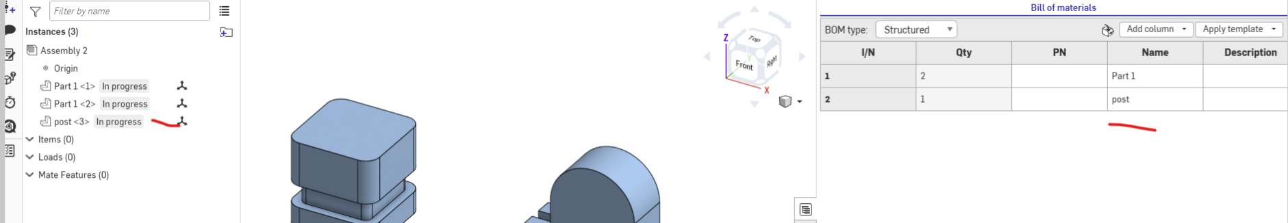

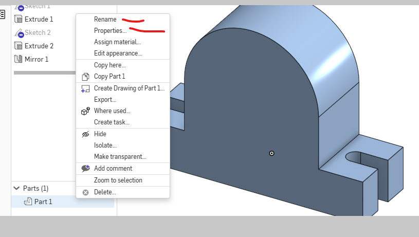

    The most direct way is to rename part1 to what ever you need it to be. Right click on part.
    This can be done from assembly as well using the BOM.
