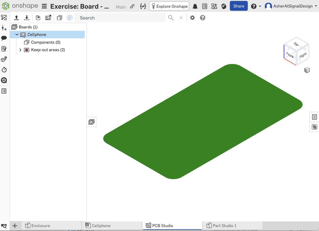

I'm trying to do "Exercise: Creating a PCB Board" from section 3 of the tutorial. I am not getting results that match what is shown.
I've gone through each step multiple times and tried to verify every tiny detail, but I can't find what is different.
I continue to end up with a PCB Studio that reports 0 components and 2 keep-out areas, but then only shows the green outline of the PCB and no visual for either of the keep-out areas.
Not surprisingly, the export contents also do not correspond, so it's not just a display issue.
I imagine it's something simple, but I'm at a loss for the moment. Any help would be much appreciated!
