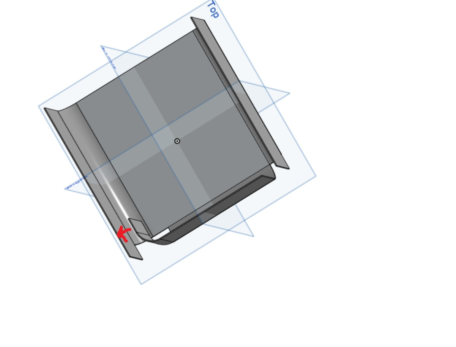

I'm lost on how to get the flange to meet or at least come close to perpendicular wall.

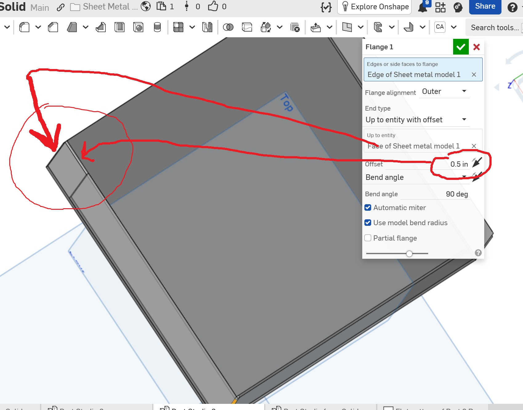

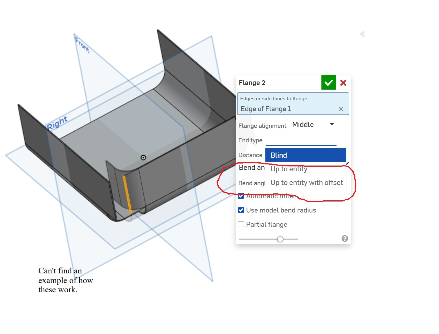

Also, I am unable to find any examples using the "up to entity" or "up to entity with offset" selections.

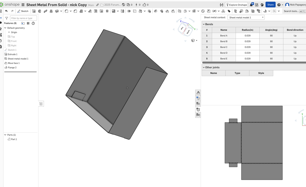

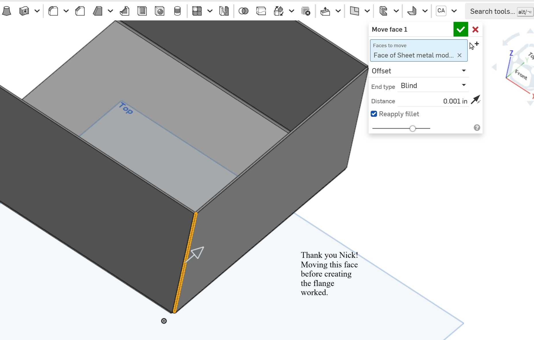

    IDK why it does this, but if you do a move face just a tiny amount before the flange, it works. Screenshot and link below.
    https://cad.onshape.com/documents/28c4766a249de270773b61b8/v/86be792abe19e74adc973658/e/6d4e33de8525984f1ac535a7?renderMode=0&uiState=69263ef1233f9d4e023e6c83
