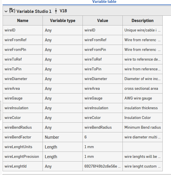

Hey Guys,
I wanted to use the automatic wire routing custom feature in onshape for the first time in a project. I did the CSV file manually (not exported from somewhere) in Excel and exported it as CSV file. Then I imported it into Onshape without any problems. But after creating a part studio in context (inside an assembly) and using the "wire data" feature, the following error message pops up.
Below you can also see my Excel sheet with the names of the column headers and the variable studio which i am using currently. Is there a way to fix this? Do i have to rename my column headers or smth.?
Greetings Samuel
  • NeilCooke
    You have a capital I in your wireFromPin variable 😬
