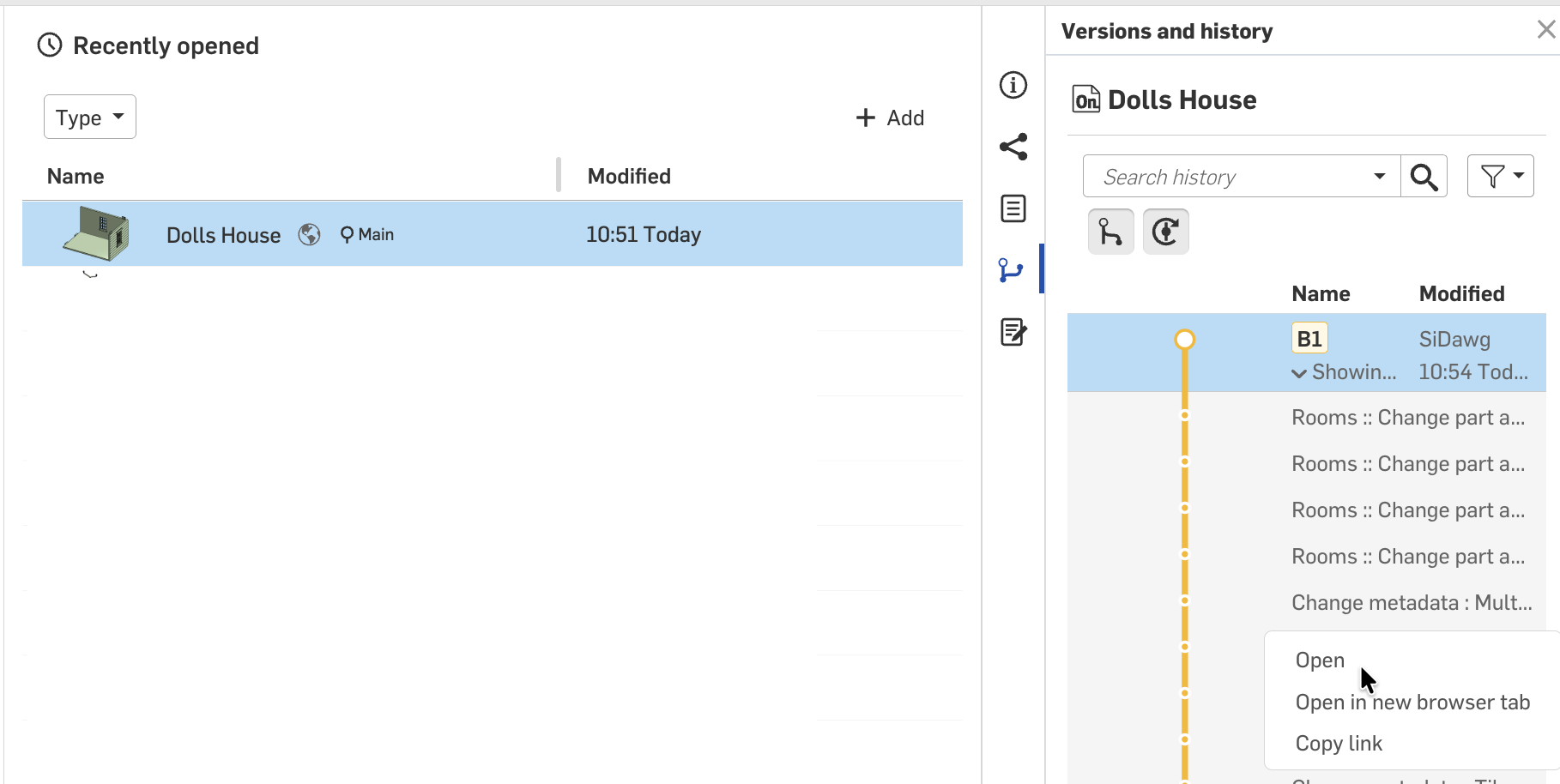

    Looks like you fixed it, but if you get an infinite spinner chances are you entered a large pattern number. In general, the way to fix this is to open from before the last change like this:
