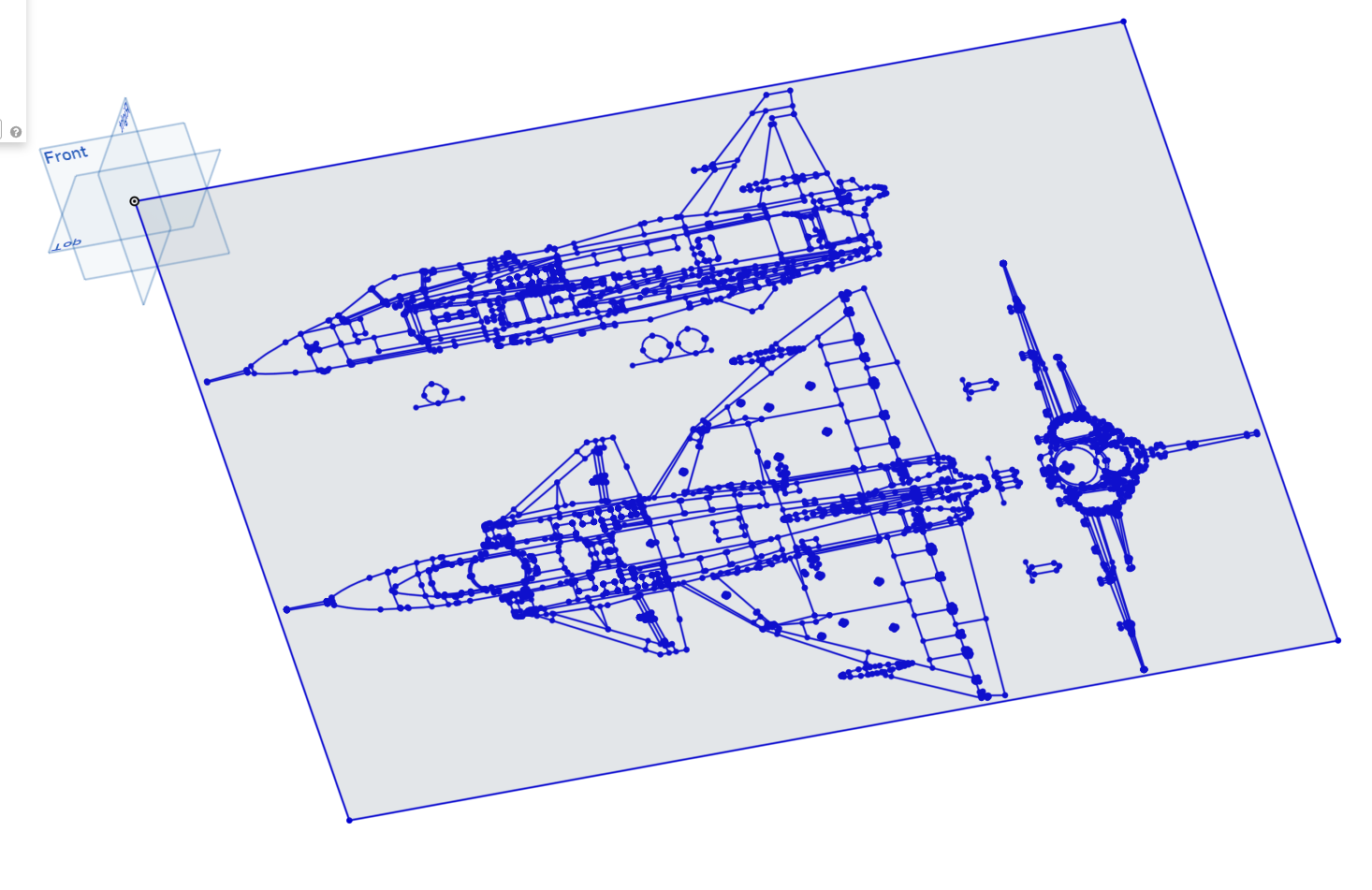

I've imported a DXF; a three-view of an airplane. To be able to draw a geometry i three dimensions i need to freeze the DXF in size and constrain all elements within it so that I can use the same DXF on all three planes and maintain correlation between the views.

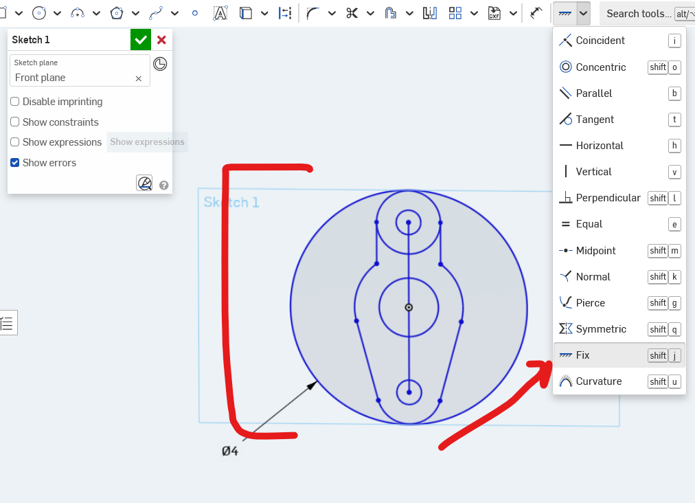

    The first dimension you add to the DXF will scale the entire sketch. So if you dimension the line of the top of the box, and set that dimension equally in all 3 planes, it will be the same scale. You can then transform all of the sketch entities around as needed. Also helpful is the "Fix" tool, which will simply fix a sketch entity (or bulk select them all!)

    You can create a sketch on a plane and insert this in, delete the two other projections and the border.
    Now create ONE known dimension. By editing this dimension, it will scale everything in the sketch equally. As soon as there is a second dimension this will only lengthen the object that the dimension is connected to.

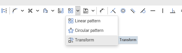

    Then you can window select everything and use the transform tool to move the first view over the origin as needed:
    Then close the sketch, the sketch will remain locked until you edit it again.
    Now create a view on the other planes and do the same dimension trick as before to scale it, then window select & transform each projection where it belongs relative to the first sketch.

    When using the transform tool move the origin of the manipulator over the point you want to reference, then use the arrows or boxes on the manipulator to drag the selected geometry. Then when the origin point of the manipulator is close to something you want to attach to, it will snap to that point.

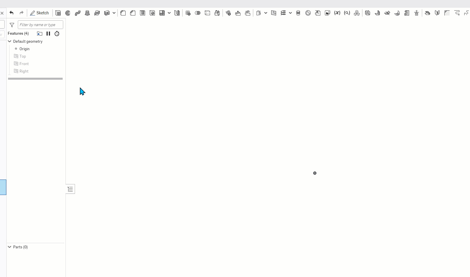

    here is a gif showing that workflow with some random sketch clutter that isn't constrained.
    You can do this same workflow with images too which I show the result of in the last part of the gif
