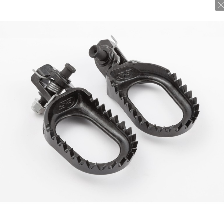

I'm trying to create "spikes" on the top of my dirtbike footpeg sketch.
tiago_martins657
Member Posts: 4 ✭
Hi there,
I'm very new to both drawing and onshape, in fact it's the first time I'm trying to create something.
I'm trying to create some dirtbike footpegs and I want to add spikes to the top similar to the S3 punk model. Here's an image for context:
Here is what I've created so far:

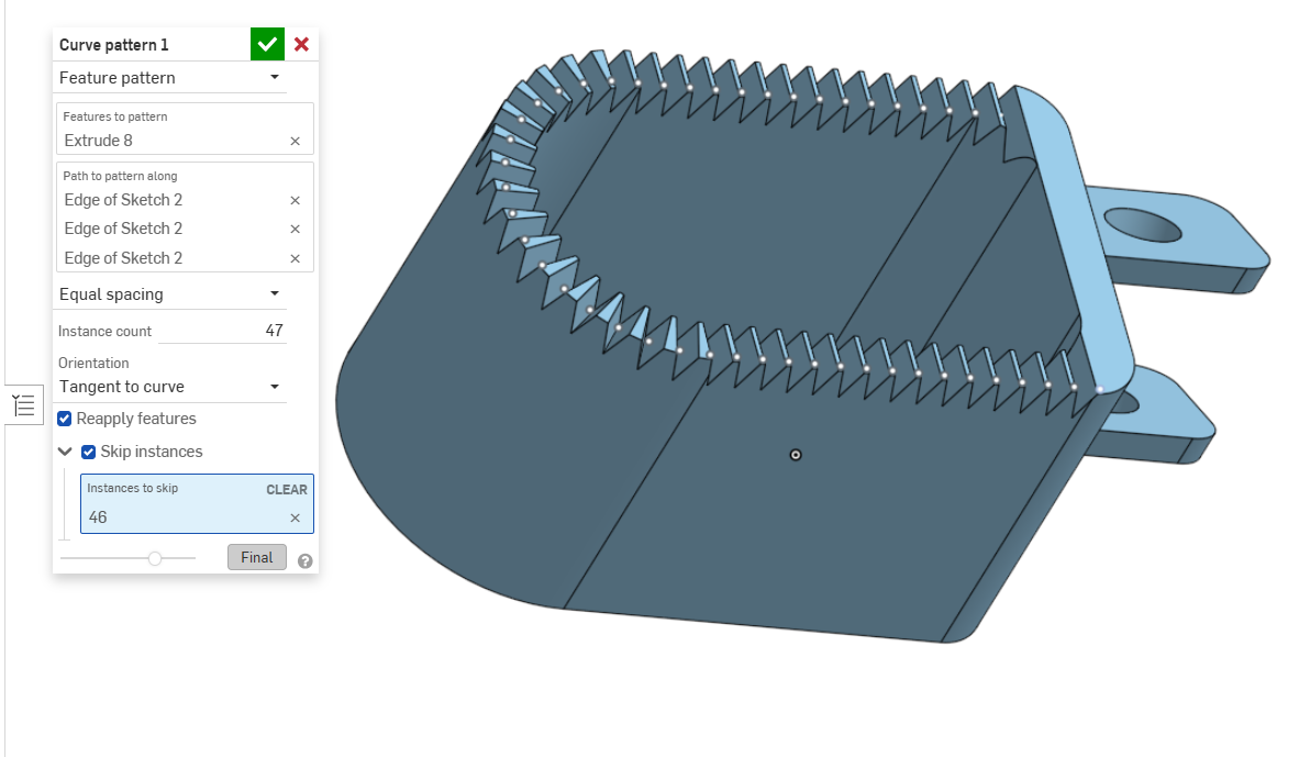

This may help to get started with the curve pattern using an extrude remove for the teeth.
https://cad.onshape.com/documents/11dbe21a93b1d1903601ec50/w/ead6bfea61f45e38504f198b/e/501ed0314388cfeec25cf491

Here's my attempt using @glen_dewsbury's suggestion - although I used an elliptical path which didn't turn out symmetrical for some reason, so I ended up doing half, then mirroring.
https://cad.onshape.com/documents/fa163101e608cba93ccb2f05/w/28fd13390ad555c236aeb0cf/e/61cd6f329b00a7572ae2cbac?renderMode=0&uiState=6978d8d1571e62ba4bcbf2ca
Unemployed Onshaper- Operating on European time - More of me here ➤➤ https://linktr.ee/Liam.GHere is a sample to clean up some small things using like one sketch for main body instead of 2 and two extrudes. Assemble avoids duplicate parts in the feature tree with cleaner updates. Feature tree is down from 24 items to 14. Some time in the help center can't hurt.
https://learn.onshape.com/?hostDomain=cad
https://cad.onshape.com/documents/11dbe21a93b1d1903601ec50/w/ead6bfea61f45e38504f198b/e/9ef53852a9eda0cda29c35eb
