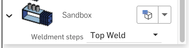

I'm making a custom table that is created by a custom feature that is similar to Cutlist. The tables it produces are associated with parts in the part studio. However, when I go to insert it into the drawing, unlike Cutlist tables, which are inserted by choosing the composite part they create, it seems like I can only insert the custom table by clicking the whole part studio, and it will bring in all tables from that studio, even ones from parts not in the drawing. Is this a limitation of custom tables or is there a way to set it up to work like Cutlist Tables when inserting? Here's what it looks like when choosing a composite part to insert a cutlist.
