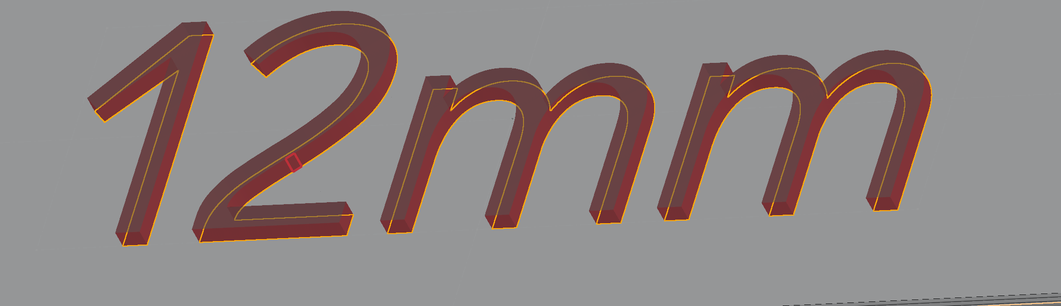

    No problem for me - see below

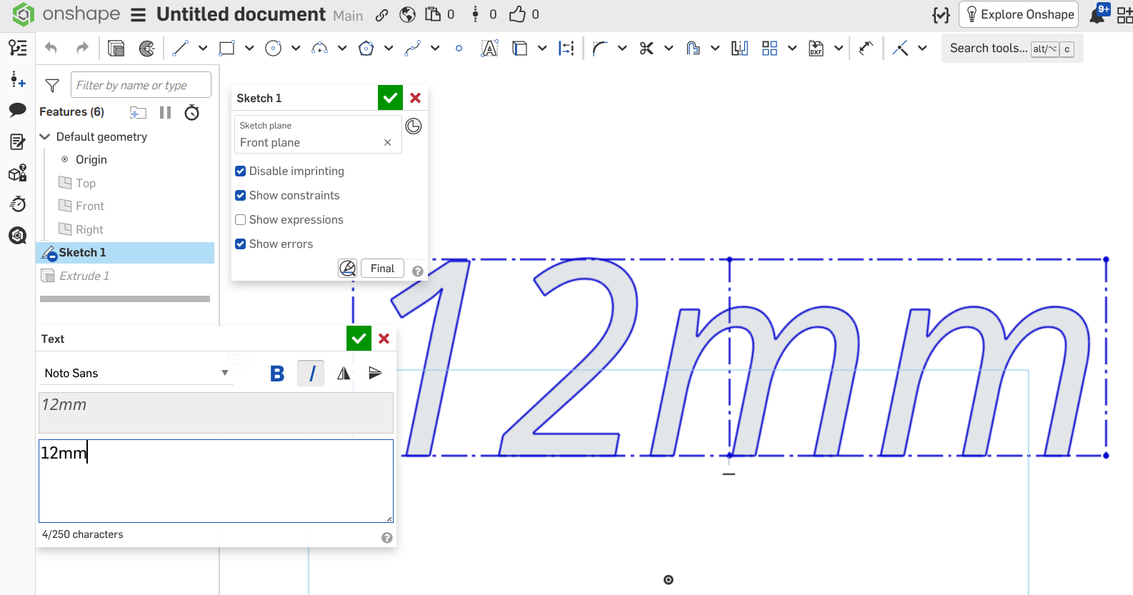

    Your text looks skewed, made to look italic, but I'm not seeing that option in the official text tool. Did you use some third-party Featurescript?

    Try again using the official text tool, but use Noto Sans as your font, which looks similar but it does support Italic - not all of them do.
    Bit confusing TBH - there should be an option to filter that font list in some way, or maybe make it more obvious which fonts do/don't support bold and/or italic.
