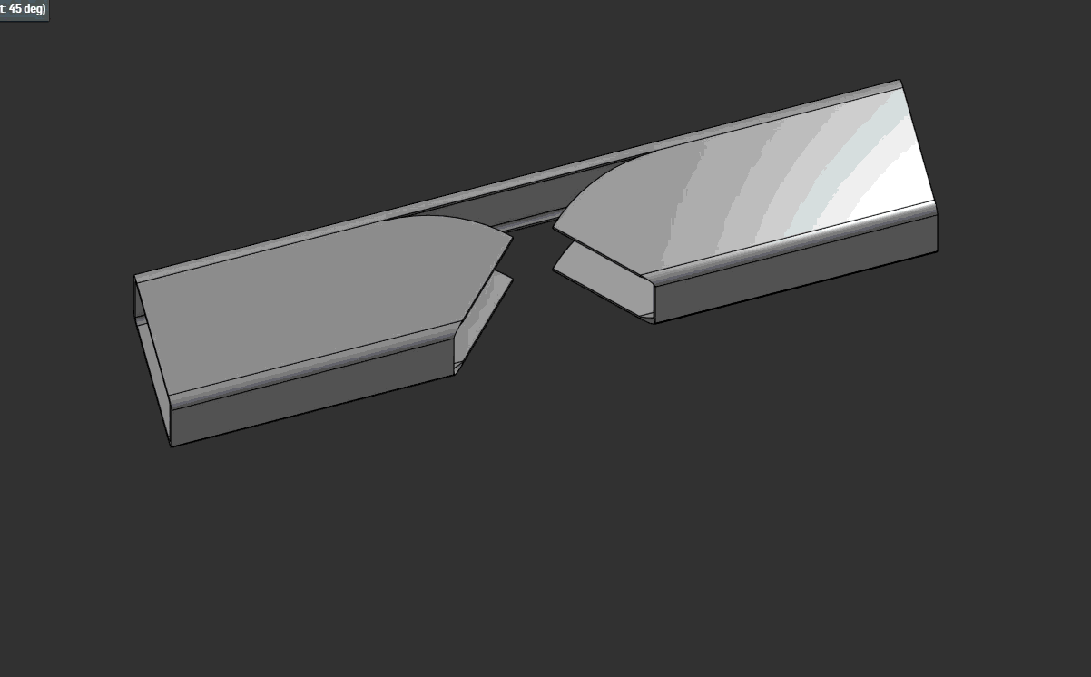

    Not a ton of traffic yet for the first week of the competition, but that's partly expected due to the subject matter of this month being a more difficult challenge than the last CAD Battle. I suppose I'll share my work in progress without revealing the methods. I'm going to be attempting to tackle some tube bending joints for laser cutting since my Instagram feed is absolutely poisoned with reels of these right now:

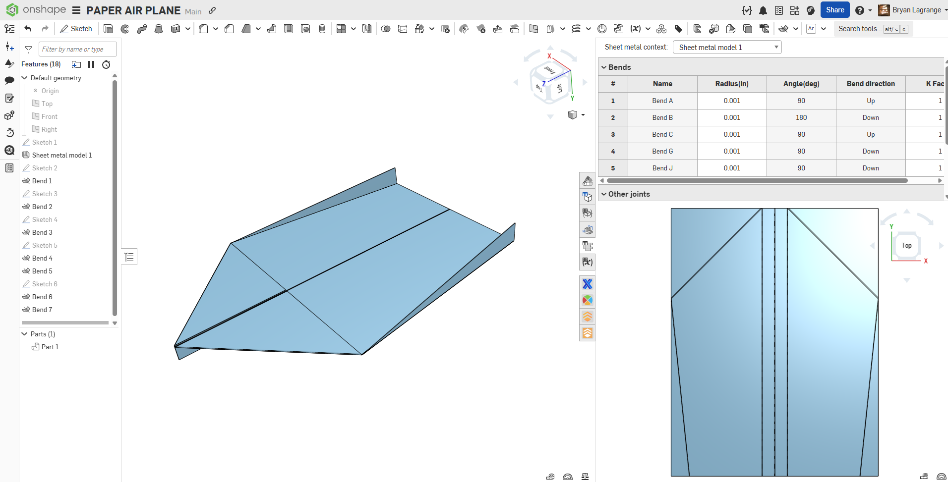

    Would a paper airplane, but better than shown, apply??? Asking for a friend.:)

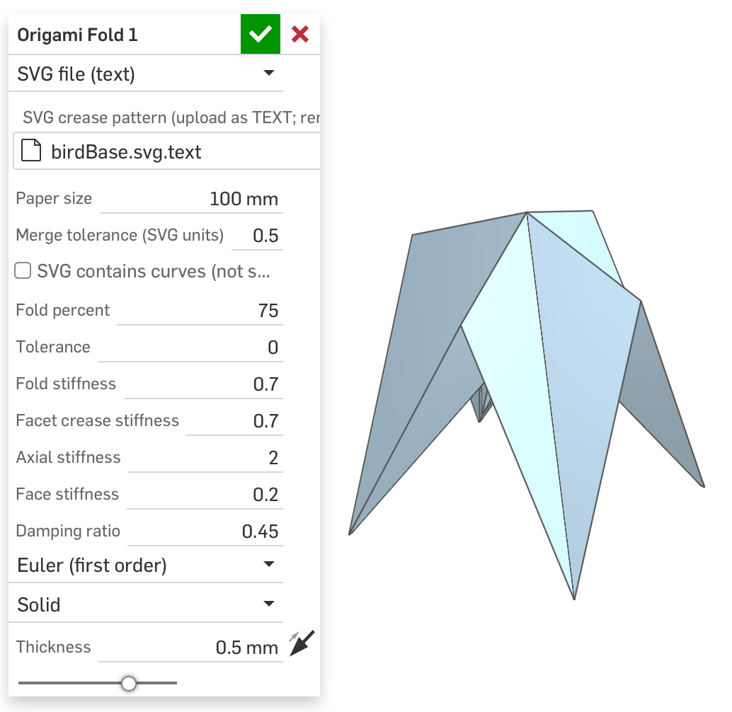

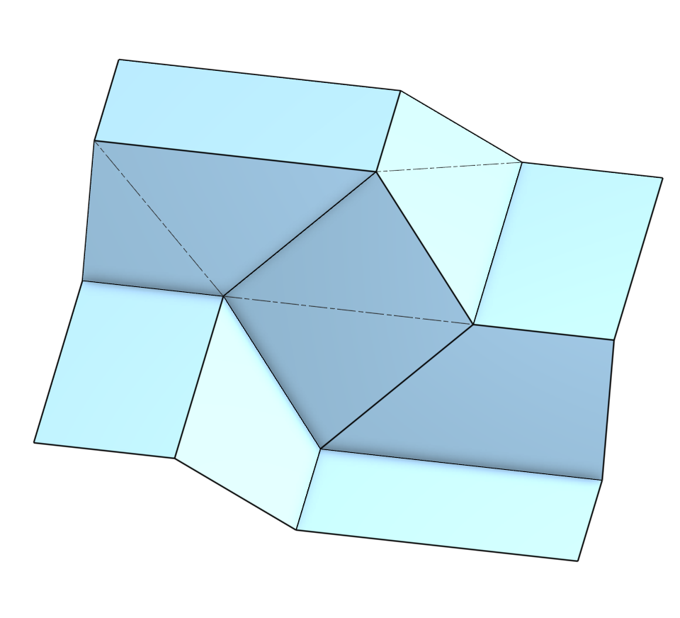

  • S1monS1mon Member Posts: 4,054 PRO
    Hmmm. @bryan_lagrange, are you peeking at my homework? I'm working on an adaptation of Origami Simulator for Onshape

    @bryan_lagrange a purely sheet metal features workflow would fall short of criteria 3 of the competition because it lacks complexity in the 3rd dimension when flattened, but could be a good starting point for some other kind of foldable. I did get in trouble at work one time for spending time making a paper airplane using Solidworks' sheet metal tools but it got used for the paper airplane launcher product renders and the design team thanked me for saving them the effort in their other software.
    @S1mon same applies to this example although once you've got an origami simulator constructed it's not a huge leap to turn it into an ACM unfolder engine by applying extrudes with draft. (Crazy work already by the way, can't wait to see how it turns out)
    I'm not using sheetmetal. It's all solver simulation stuff. The interesting thing is that it can flatten things that start in 3D that you can't flatten with sheet metal or the flatten analysis tool. It's not something I would use for production since the solver introduces a lot of error over time. It's more of a fun toy so far. Unlike the Origami Simulator that inspired it, FS doesn't get to use the GPU, so it's much much slower.
    I'll think more about rule #3, and if there's a way to make this go beyond. I do have a thicken option built in, so having it do that with draft per face is not out of the question. Anything that's not a triangular face to begin with gets faceted to do the simulation - with slight dihedrals sometimes - so it would be tricky to get it to pretend to be the ACM thing for non-triangular faces.
    I'm still planning to get this running better for my own amusement anyway…
