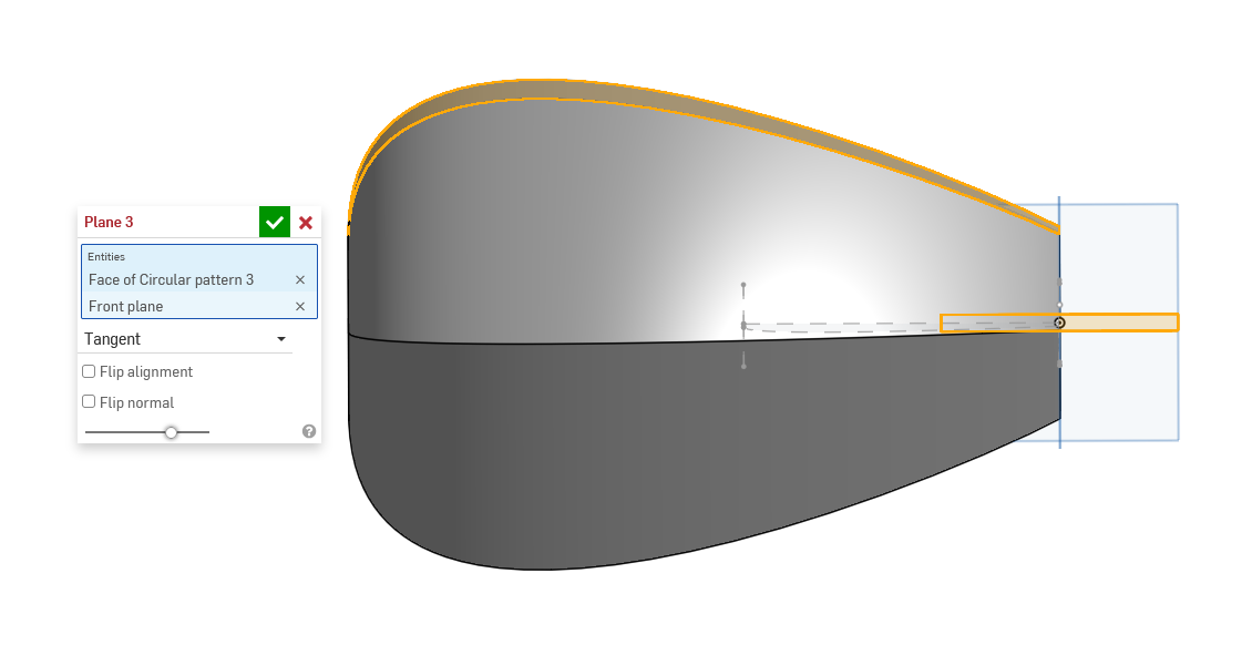

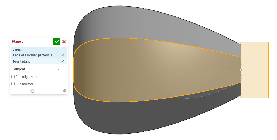

So I see that the tangent plane feature seems to only work with cylinders which seems quite limited. I would love to get a tangent plane to a general curved surface. It seems like if I make a minimum bounding cylinder, make the plane around that, then suppress that part I could get the desired plane, but I also cannot figure out the easiest way to make that minimum bounding cylinder.

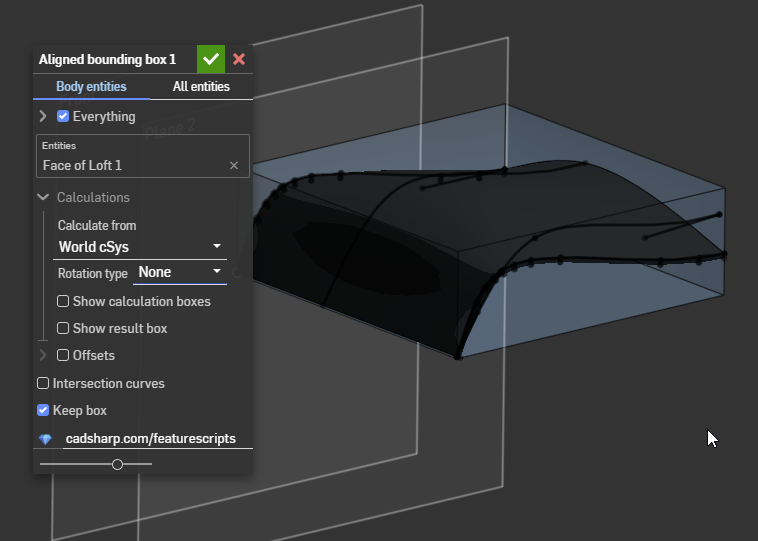

    You could try using the bounding box FS, although it's an approximation so may not be precise enough depending on what you are trying to do…

    Ok so the way I ended up doing it was by using an isocline. Generating an isocline with the faces and the bottom plane can generate the "equator" which is where the plane would be anchored, because that is inherently the inflection point
  • EvanReese
    Try my 3D points feature, which can produce tangent planes on faces. Just click the face as the reference.
