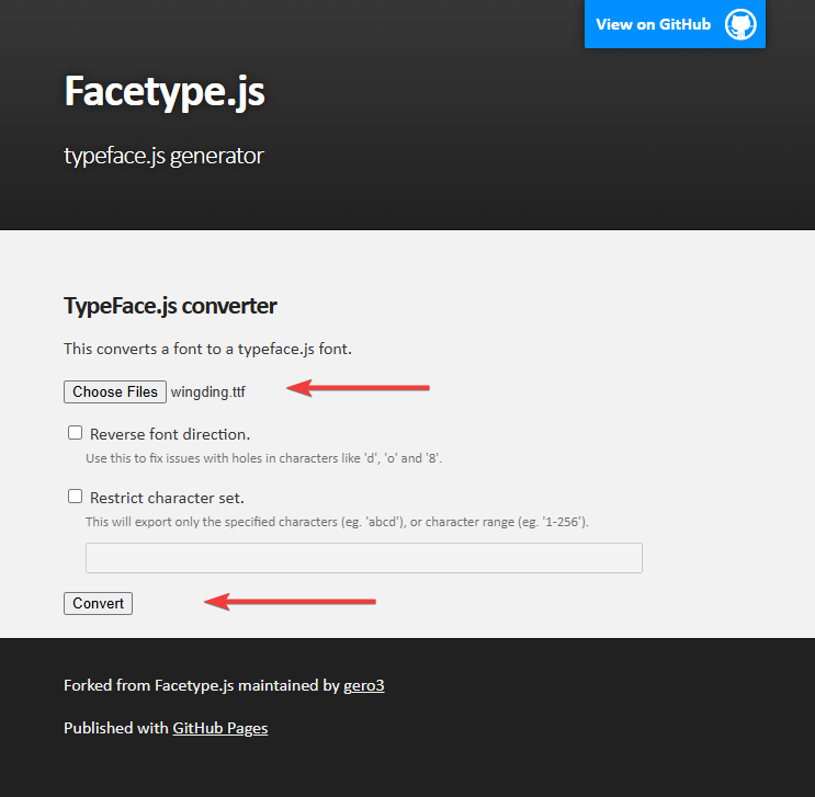

- Visit to convert a TTF font to a JSON file.
- Import the JSON file into your document.

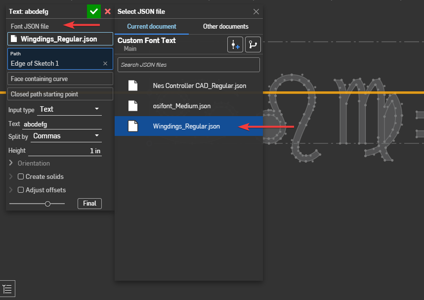

- Add a Custom Font Text feature and select the JSON file
- Configure the rest of the Custom Font Text feature like you would the Text feature.

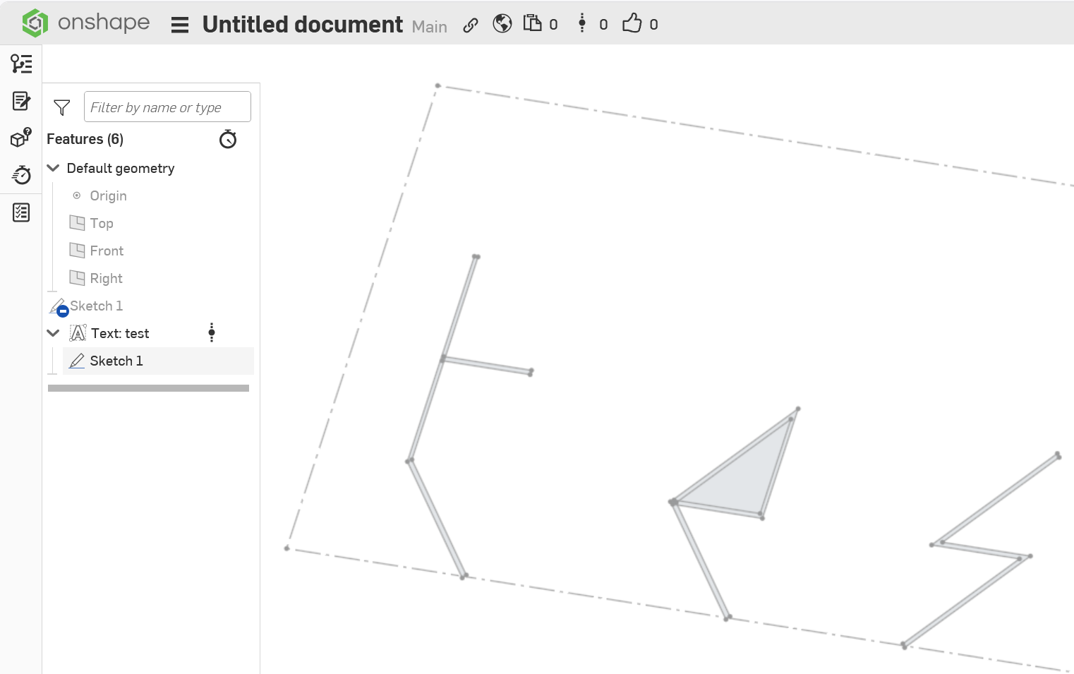

Assuming you mean open contours, that's not supported by TTF. However this custom feature technically doesn't care about contours being closed. I could add support for converting SVG fonts to JSON which would allow for this if that is what you are looking for.
I added support for converting SVGs to the web page. I tested it with some of these single stroke fonts.
I couldn't find a good way to make my own. Fontforge doesn't support them. Inkscape's old typography extension kind of supports them but is quite broken. Inkscape's new svg font editor doesn't support them. When making my own for testing I ended up closing each contour and manually editing the SVG by hand to open them.
Query variables+ makes it pretty easy to work with the edges to do stuff like this. I'm sure if I spent some more time on it I could smooth out those corners. https://cad.onshape.com/documents/54c2b2dbcad2d9a233387ec4/w/6e033d1b75f8eff1c3e5dc94/e/b6e63f55cf8d7f7b6b134a1b

@jnewth it is to be machined. We use a marker as one of our tools to label the nested parts we cut on a CNC.
The fonts currently available are double lined and made out of complex curves.
So I need a font that is both single line and made out of straight lines and arcs, nothing else. This saves time both computing the parts and marking them.🙏

TTF doesn't support open paths. The feature does support open path svgs. For example you could use this font if you need a real single stroke font.

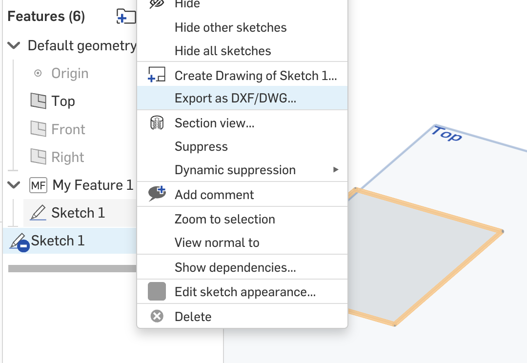

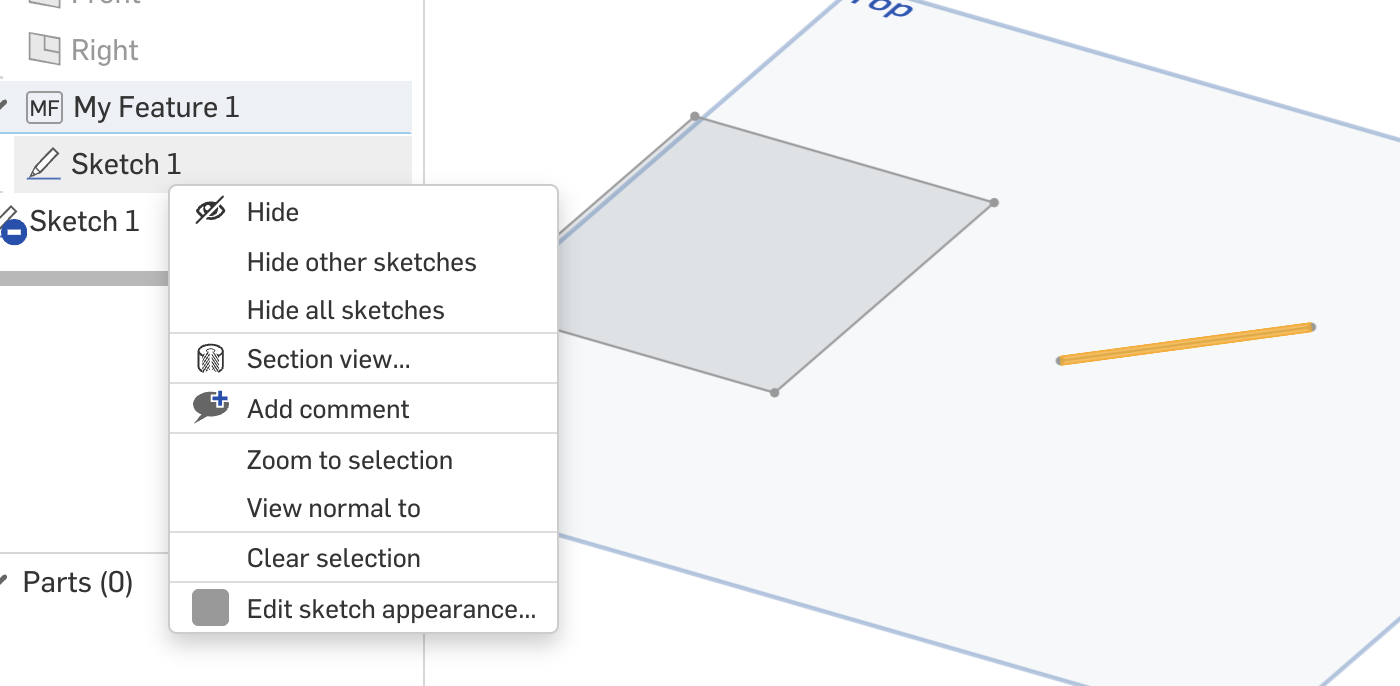

Yeah @martin_kopplow I have a stick font as you describe: true single stroke elements. The problem is exporting this data. A couple ways:
1. Use a custom feature to create a sketch. Export that as DXF. — Doesnt work. Not an option on FS-generated sketches.Here's the context menu on the manually created sketch:

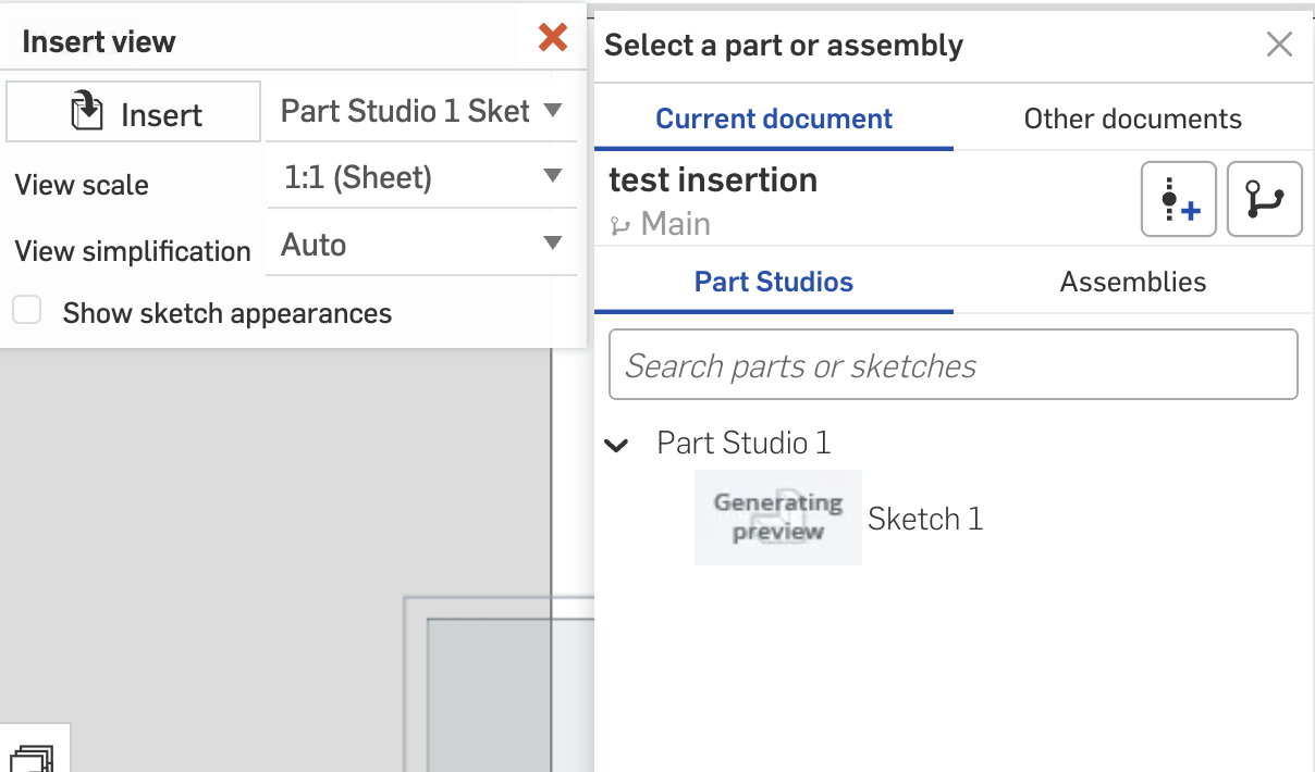

2. Import a custom feature-generated sketch in to drawing, then export that as DXF. — Doesnt work, can't import FS-generated sketches.(FS-generated sketch isn't even an option for insertion).

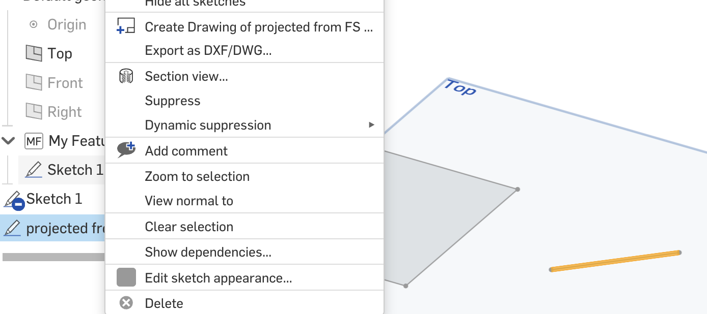

3. Use a custom feature to create a sketch. Then manually create another sketch on top of that one, and "use/project" all the sketch elements in to this manual sketch. Export that as DXF — Works but a rather unpleasant process.
4. Use a custom feature to create a sketch. Have this same tool also output (as text) the gcode required to describe those toolpaths. —- Could work, but moving gcode in to FS, while possible, is a little nasty.
If anyone has a workaround or solution to the above I'd be interested in hearing about it. The stick font I can provide with little trouble at all, but the export remains an unpleasant business. There are many ways (write my own exporter / file dumping API script / gcode generation) but i cant think of one that people would you know, actually use.0 -
Looks like you used the wrong facetype.js to convert the ttf. You have to use the one linked in the post. Due to limitations in featurescript, facetype.js had to be forked and modified. The original facetype.js won't produce a compatible json file.
That did the trick 👍️
Thanks so much, bladec.

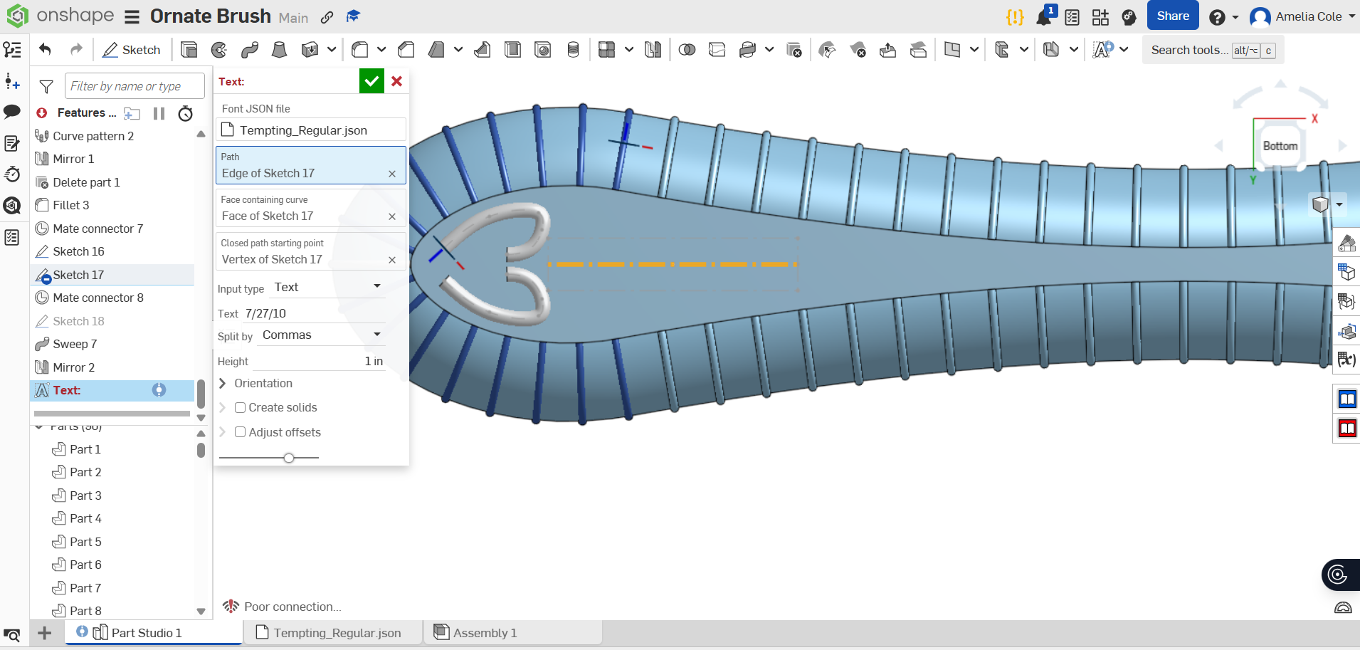

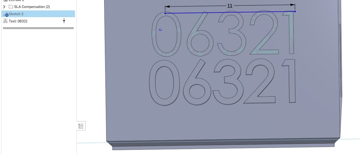

Hi everyone.
Has anyone found a way to have the text easily centered in a face / path?
That's not manually moving the path and character offsets I mean.
I'm trying to recreate the numbering below (from a model I got from Solidworks with text in Century Gothic.
Whenever the text changes, I have to adjust the path left/right1
