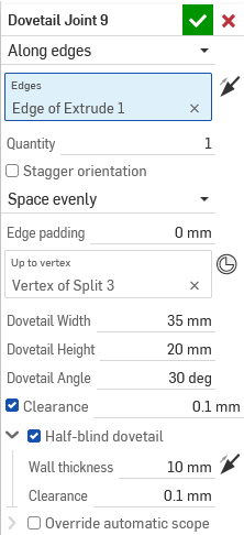

A custom FeatureScript that generates male and female dovetail joints between touching solid bodies. Tailored for 3D printing assemblies, it automates the boolean cuts and unions while providing direct controls to pattern joints evenly along edges, create hidden half-blind configurations, and apply precise clearance gaps for glue-free friction fits.
Features
  • Positioning Modes: Place dovetails manually on specific points (vertices or Mate Connectors), or distribute a specified quantity along selected edges.
  • Edge Distribution Controls: Adjust the spacing logic (Space evenly, Space around, Space between), add padding at edge extremities, and optionally alternate (stagger) the orientation of the joints.
  • Geometry Parameters: Define the dovetail's width, height, and interior angle. The total extrusion depth is determined by selecting a target vertex or Mate Connector.
  • Half-Blind Dovetail: Conceal the joint from one side of the assembly by leaving a solid wall of material. Includes controls to define the wall thickness, swap the hidden side, and add bottom clearance so exterior faces sit perfectly flush.
  • Print Clearance: Automatically applies a uniform dimensional gap to the female cut to ensure a proper mechanical fit.
  • Target Scoping: Automatically identifies the correct bodies for the male (union) and female (cut) operations based on geometry intersection, with a manual override available for complex assemblies.

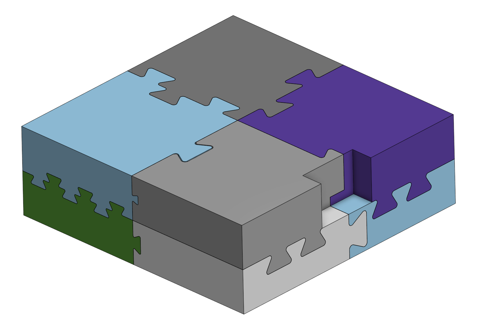

    Does it take into accout 'assemblability'*? Looking at your sample picture, I guess it is not possible to put together following the directions the dove tails require.
    *I don't have the right word for it. Here in my place we'd say 'Montierbarkeit', the property of a product to be assembled, as opposed to self- obstructing in the process.
  • Derek_Van_Allen_BD
    It does not, but in a similar sense the default sheet metal tools in Onshape don't account for that either for bending capability.

    The picture is just a testing Part, it not real so yeah you're right it's not assemblable.
    You're talking about a draft on the male part ? Male and female extrusions are straight, but in my real 3D printing experience it works great like that.
