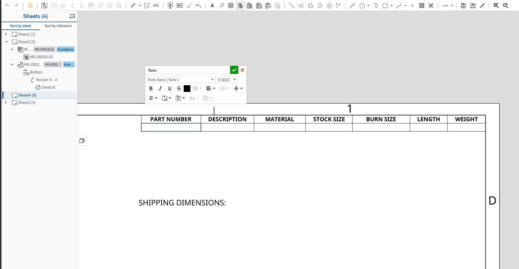

Since last week, the BOM table in my new drawings doesn't have the variables for properties/metadata.
The drawing template has the properties there, and it was working not long ago.
Did something break it?

    Is it happening on all new drawings or just this one? If just this one, double check the BOM table is referencing the model. Right click on the BOM table>BOM table properties>Reference. That should be your asm model.
    If it's not there, then go to the view of the model in the drawing, rt click, View Properties, and at the very bottom is BOM table reference. You can change it there.

    It doesn't even give me any BOM table options because it only recognizes it as a generic table.
