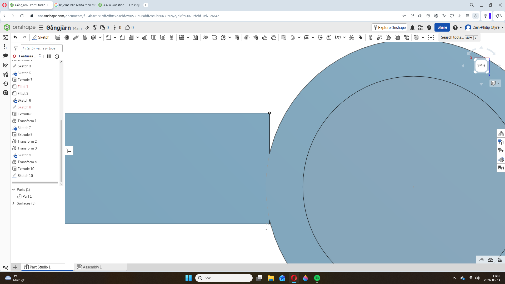

how do i do this triangel?
carl_philip_glyré
Member Posts: 2 ✭
hi, i'm new to onshape but have managed to draw a hinge for fun. but i can't get these "triangles" to be filled and go like a smooth curve. is there anyone who can help me? have tried using fill and everything else that google ai has come up with tips but they don't work. can someone show me or go into the direction and explain how to do it?

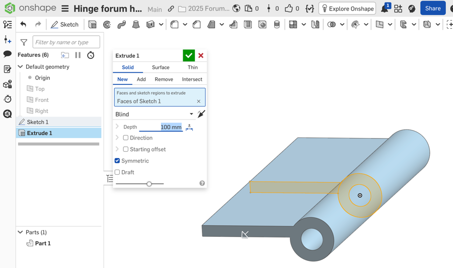

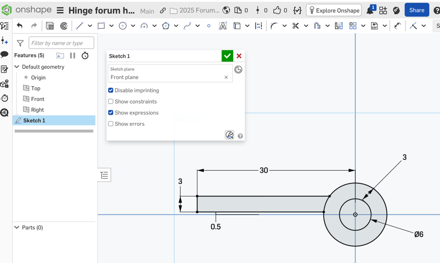

Your first sketch should look like this. The barrel and the leaf should be drawn together in the same sketch.. (you can even draw the leaf for the second half of the hinge in the same sketch, but that's more advanced).

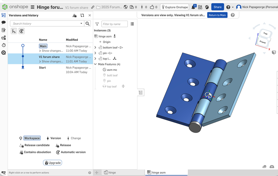

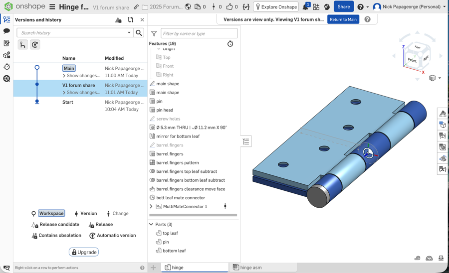

I modeled the hinge for fun too:) There are many ways to make a hinge, this was my approach. Feel free to go through it feature by feature. You probably won't know what half the things are, however, unless you do some part studio and assembly training.
https://cad.onshape.com/documents/364e2cf391a17c4415a72fce/v/2ecb0a647e2504c2359f3bc9/e/5bf4f9d9fc5ac7f648bd237f?renderMode=0&uiState=69b6c9bc94f4260e3fe4abf0
