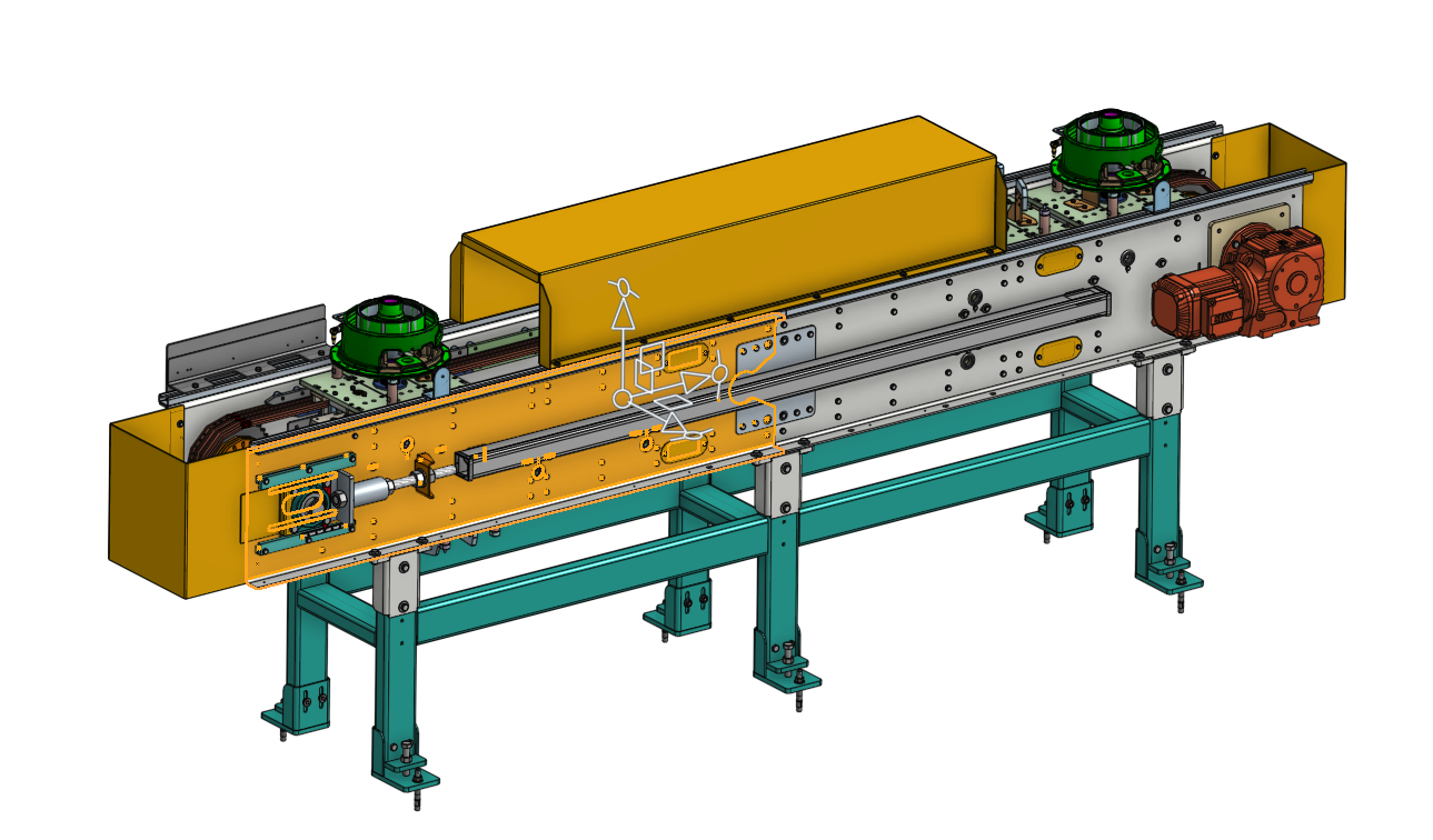

This happens all the time here. It's not just the size of the laser. It is whether or not it can be formed in the break press without crashing into the press itself.

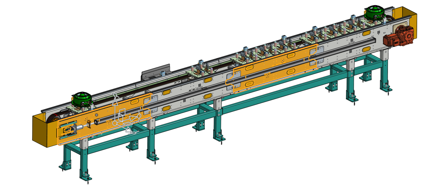

Or it is just easier to create a complex side frame and split it later based off how long it ends up being. (This is more for creating a template for a conveyor that can be stretched and automatically splice the side walls). Sometimes the frame is 5ft long, and can be one piece, other times it can be 30ft long and needs to be 4 pieces.
So, not an oops, just a design workflow that doesn't require fixing the faces/merge scopes for dozens of features. It's easier to design the conveyor as a whole, then split it for manufacturing/shipping.
