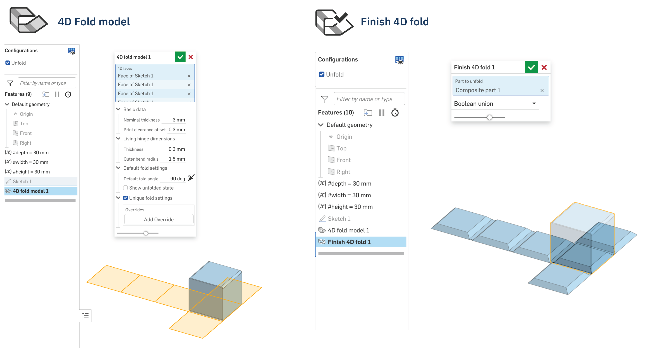

This feature is inspired from Hackaday post by Arya Voronova that showcase some really cool ways to make complex parts with support-less additive manufacturing. Its original intent is to target additive manufacturing, but there's likely more use cases, as @elijahpekaar pointed out. The idea for an Onshape FeatureScript was triggered by CAD Battle #2, thank you @Derek_Van_Allen_BD for an incredibly thought provoking, exciting and challenging competition!

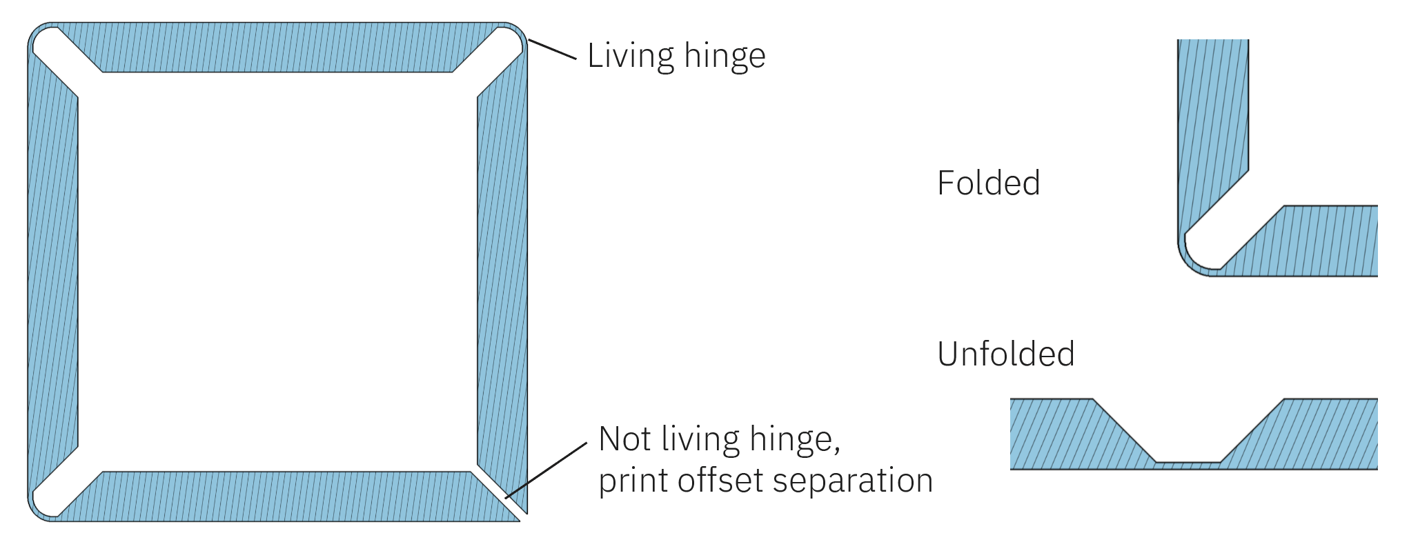

What it does
This feature is a two-set feature, alike Sheet metal model, and Finish sheet metal model.
The first one, 4D Fold model is taking a set of coplanar sketch faces, thickens them to a nominal thickness and then folds them to a desire angle across the shared edges. The order of selected faces don't matter, except that the first face selected will be stationary in space as it's folded. The second feature, Finish 4D fold, takes the result from the first feature and unfolds it back to a planar part ready to be printed.
The feature creates the folds with what's called living hinges, a thinner section intended to bent more easily. The user may have to experiment with thickness, bend radius and printer materials to get the hinge to work well for the particular use case. The K-factor is fixed to 0.5 for now. Where two edges that don't have a living hinge meet, the separation can be adjusted with a print offset variable.
One aspect of the design that may be a little counter intuitive at first; the design sections shrink in the fold-direction. The dimensions in 2D sketches are intended to be those of the part in the folded state, and as the living hinge is shorter than the theoretical sharp corner, it needs to move in slightly in the unfolded state.

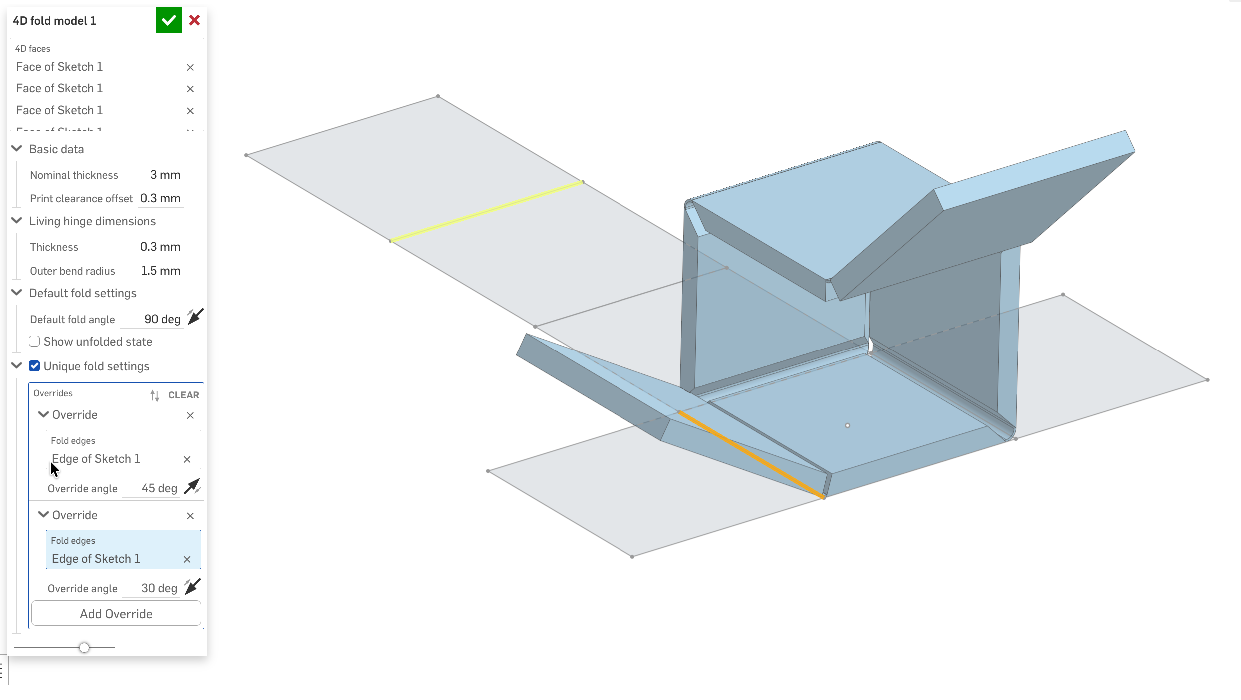

Individual edges can be overridden with unique fold angle or fold direction to make even more complex folded structures.

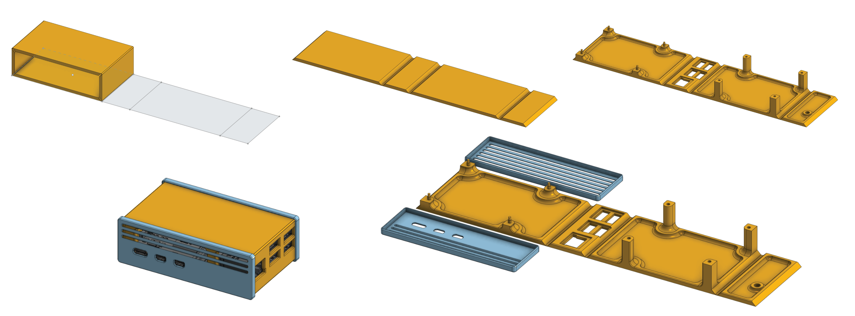

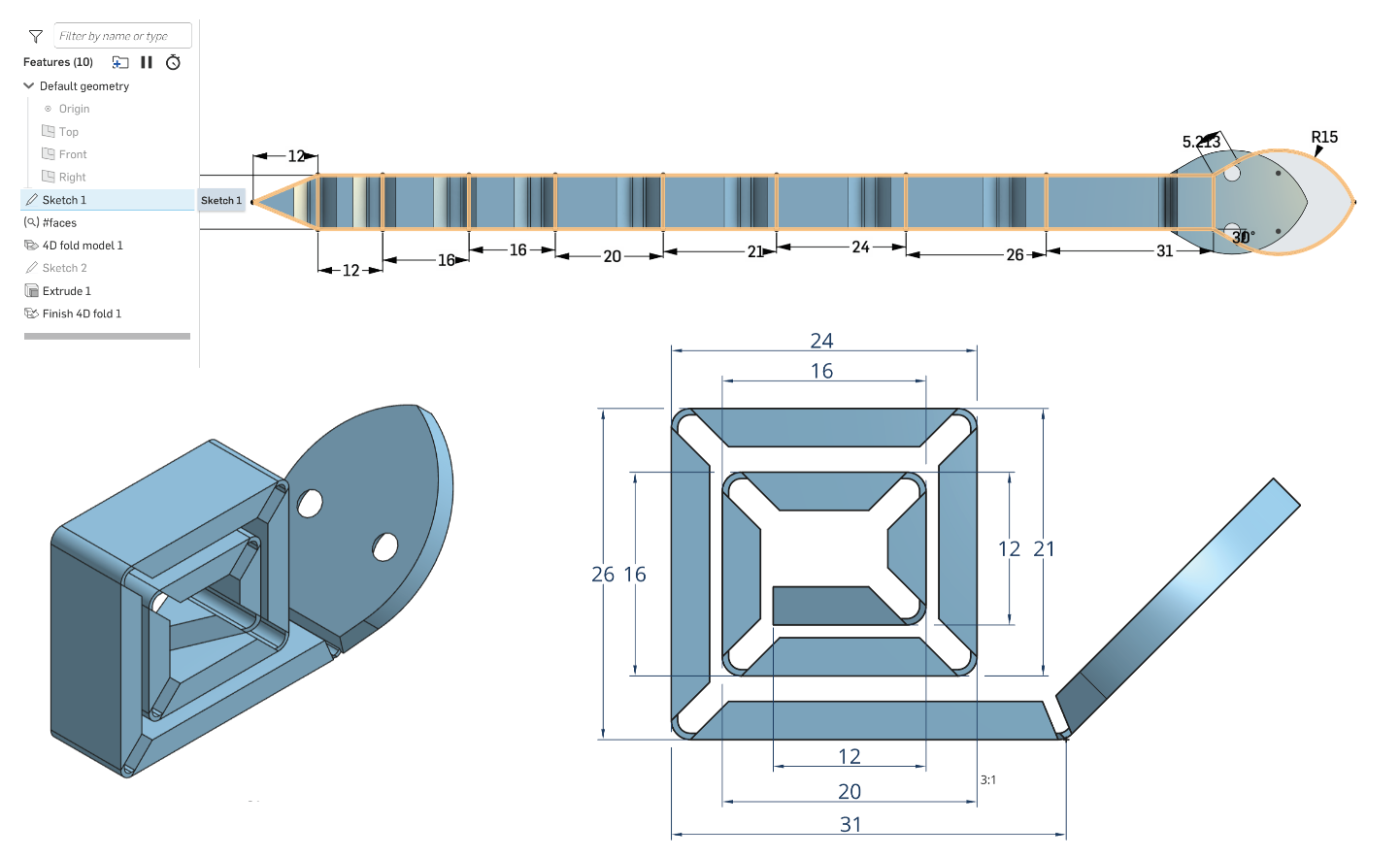

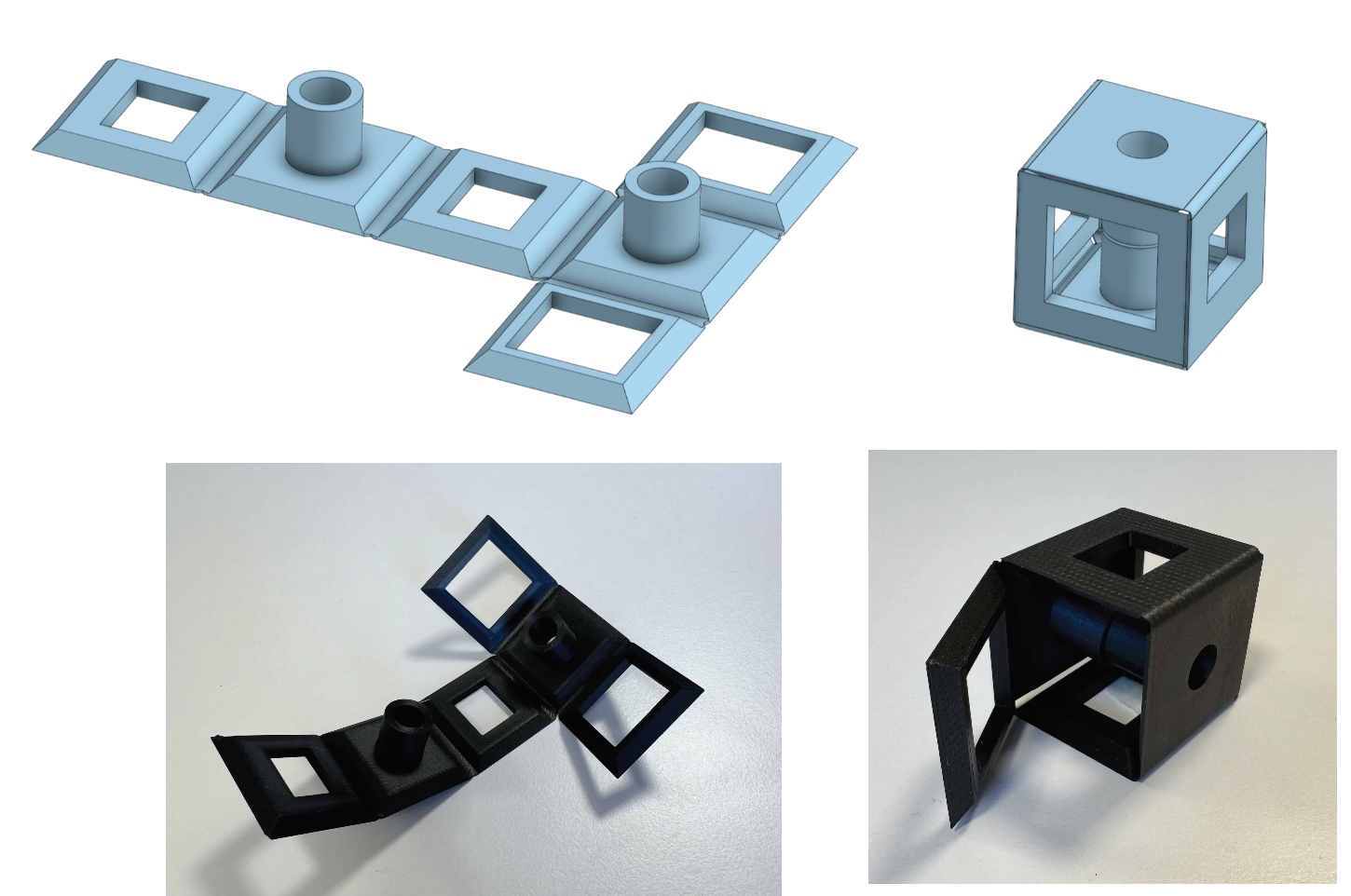

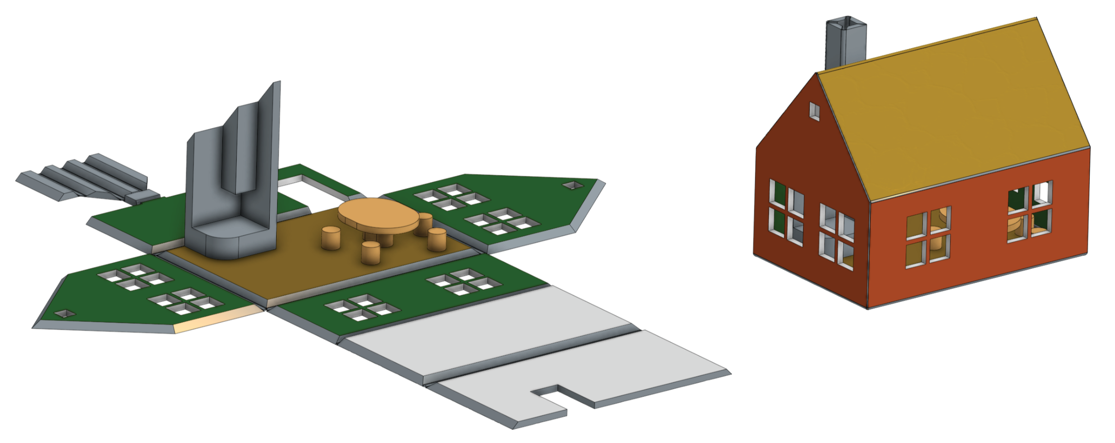

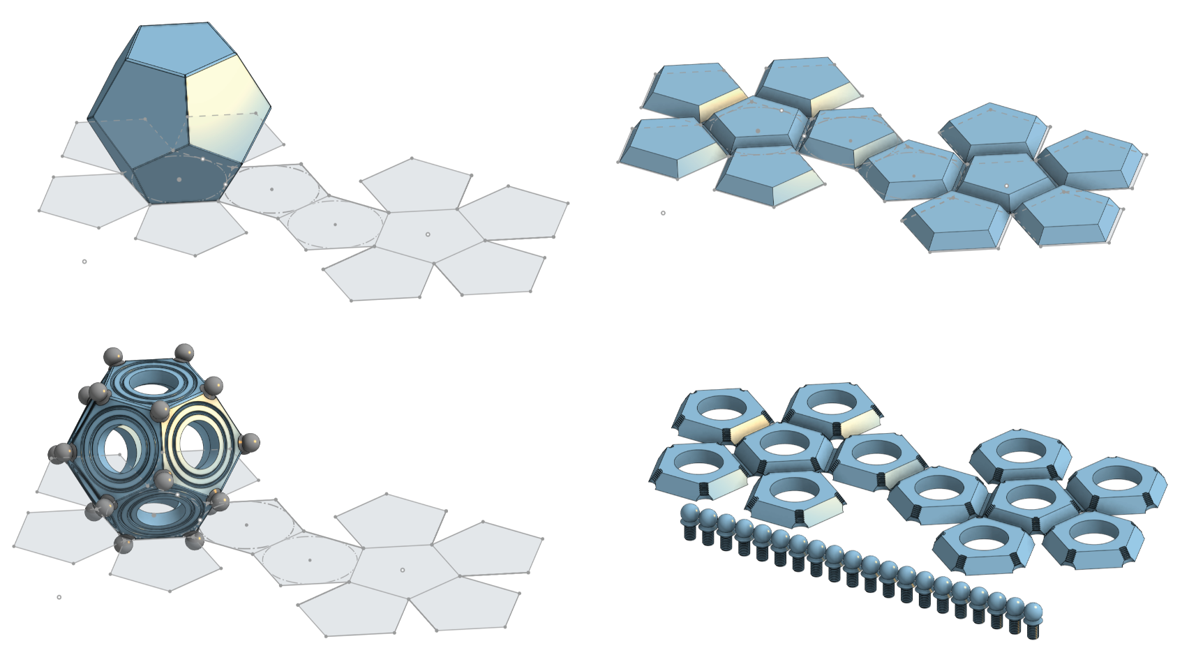

The magic

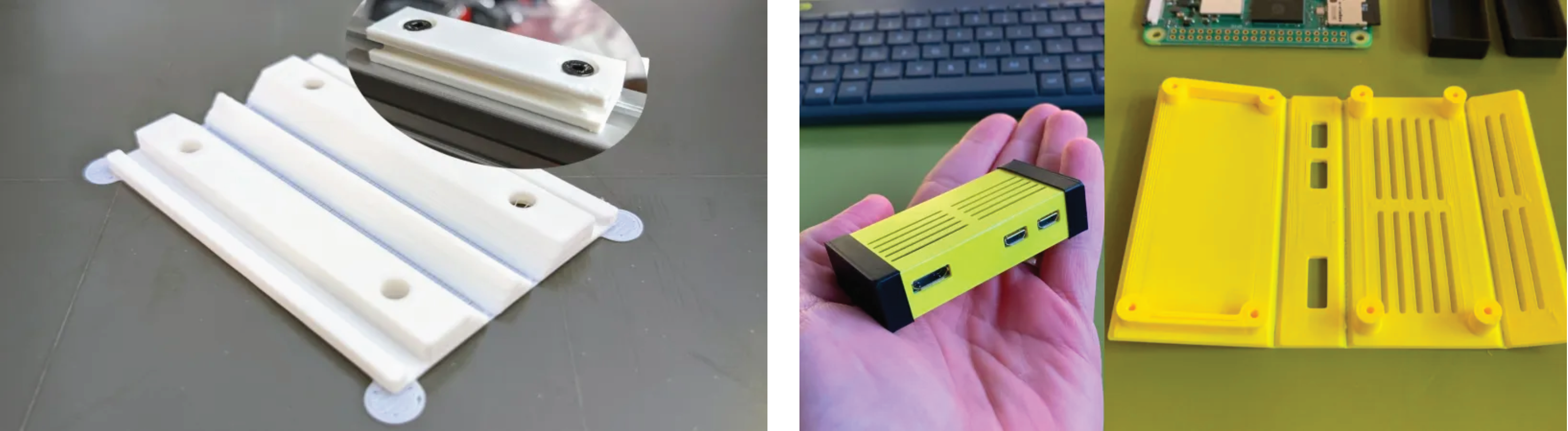

You can do any* additional processing to the parts in between the fold model and the finish fold model. Such that complicated models can be designed for support-less 3D print.

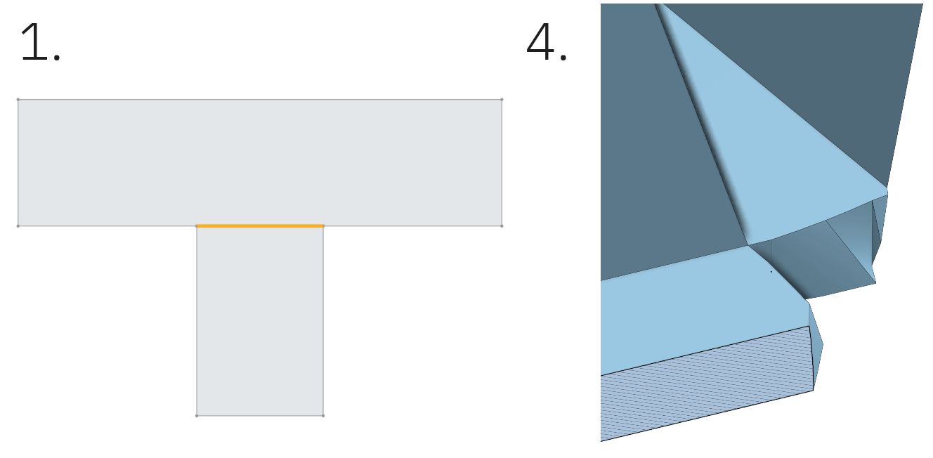

Known bugs:
  1. Partial edges are not working
  2. Too large nominal thickness will break it
  3. It assumes all faces are in the same plane, and will break if not
  4. Unfold produce weird shapes of the living hinges in some areas, hopefully not a deal breaker but not the most pretty.
  5. The folding cause loads of literal edge cases in handling of corner truncation, I’ve had a look at some.
  6. Attribute-destructive edits will break it, I’m not sure if it’s possible to safe-guard to. Warning would be nice.
  7. It should probably tell if the user has added features that interfere with the build plate after unfold, as it’s designed to target 3D printing.
  8. It can be picky about not complete edges that form the fold line.
  9. It's lacking user-facing error and exception handling.
  10. It would probably be handy with editing logic and manipulator change functions.
