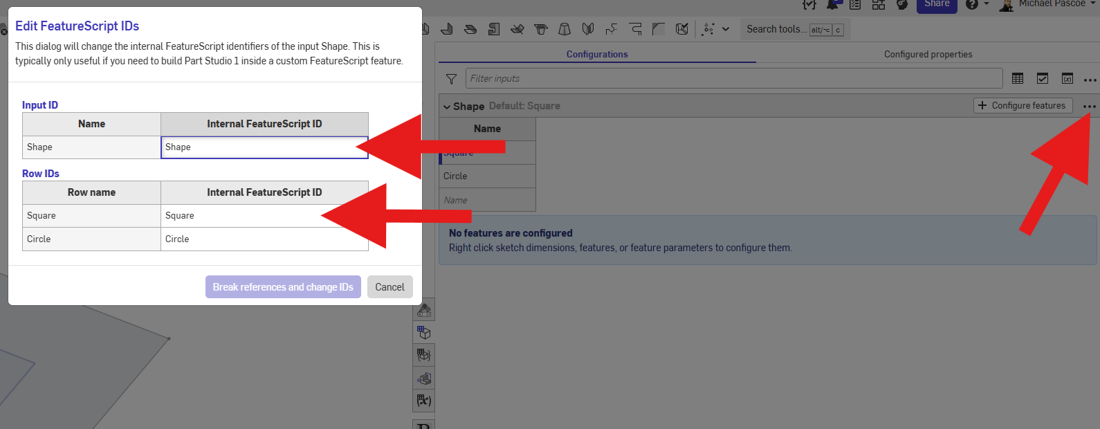

    • Set the configuration's feature id's to something you can actually type like "Shape":

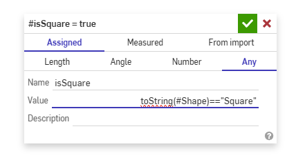

    • Create a variable "isSquare" or whatever you want to describe and use operators

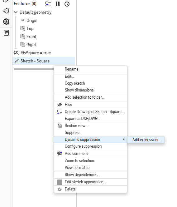

    • Right click the feature and add the dynamic suppression expression to it, here is where you can insert your "isSquare" variable.

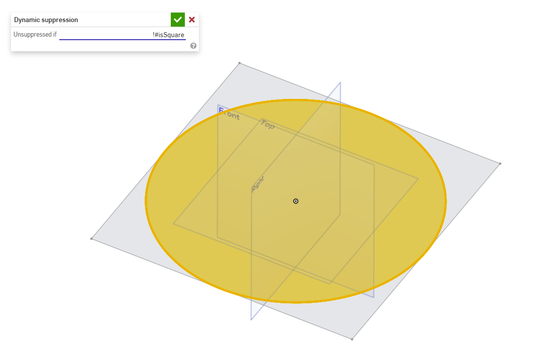

    • Do the same thing for your "circle sketch" except insert !#isSquare which will reverse the true false value.
