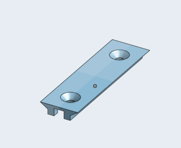

I made this model and would like to bend it for 45 and 90 degrees left or right. Is there a way to bend an extruded part similar to what the loft functions do?
Thank you in advance!

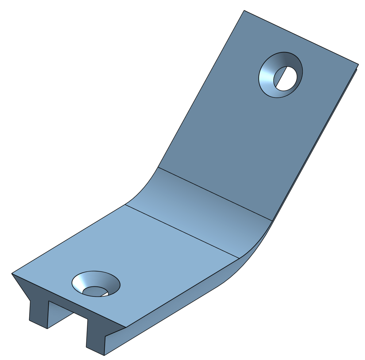

Sweep would be used. Check it out > Sweep. - Scotty
Onshape doesn't have a bend feature. And I don't know of any custom features to do it. But maybe a sweep will work for you?

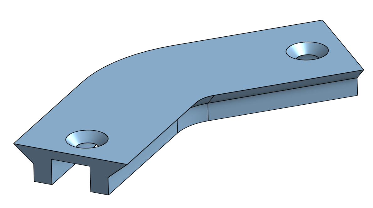

Something like that, but I would need it to curve left or right like a road, not upwards, like you did it.
I was thinking start with the Revolve function for the curved center section, then Extrude for the straight part on each end?
Ask, and the FeatureScript gods sometimes deliver.
