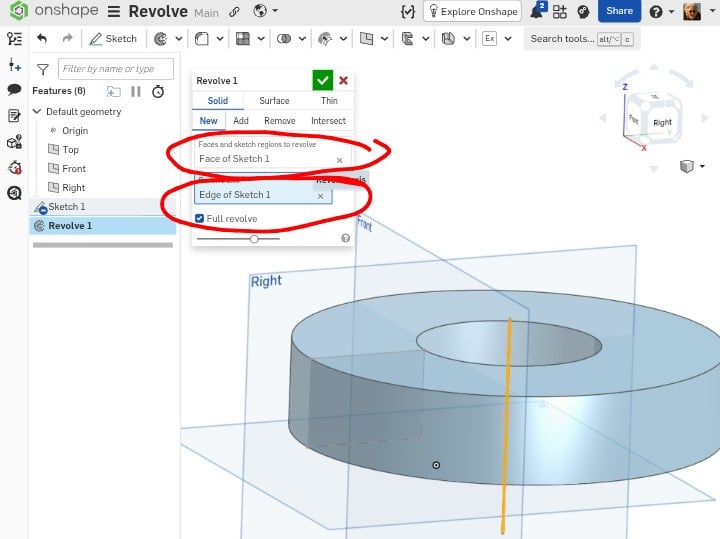

Learning Onshare on Android phone. I can extrude, easy. But I can't figure how to revolve. On front plane normal, I sketch a line and rectangle, then select the rectangle as region to revolve, and then click on the line as an axis but the message says another region selected and then asks to select axis again. I'm baffled.
  • eric_pesty
    Are you in the "selection box" for the axis when you pick the line? Active box is blue:
    Regions box selected:
    Axis box selected:
    I would recommend going through the exercises in the learning center, it will save a lot of time instead of guessing stuff like this!
    Axis box selected:

    Eric's picture showed me my error. I needed to click the axis box before clicking the vertical line.
    It's so obvious now. I did complete the revolve operation, no problem at all.
