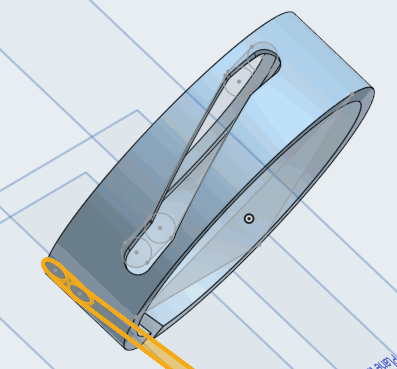

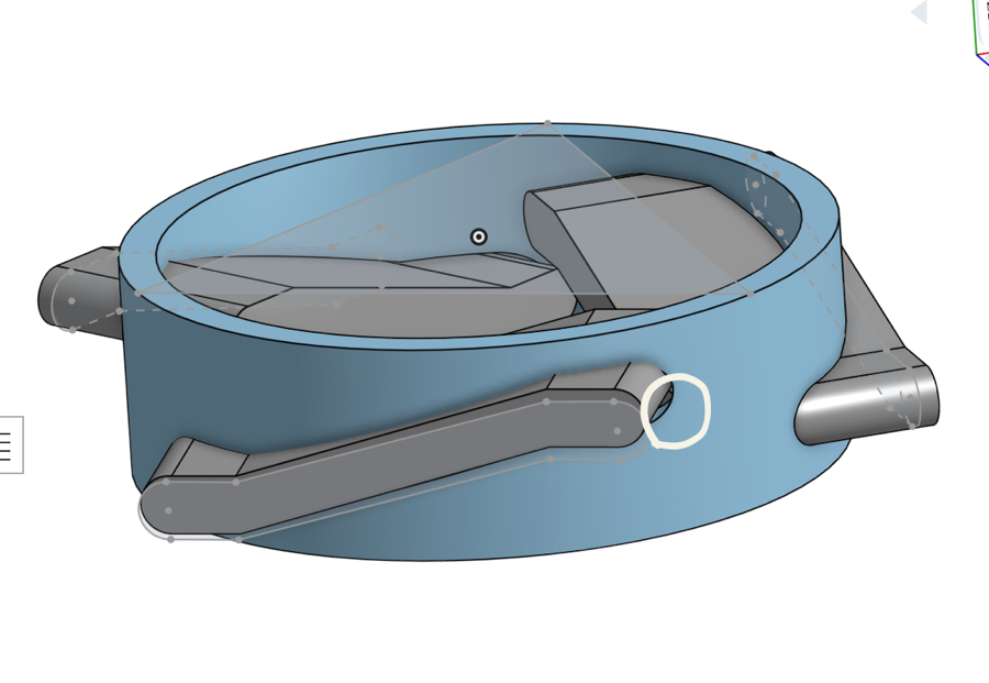

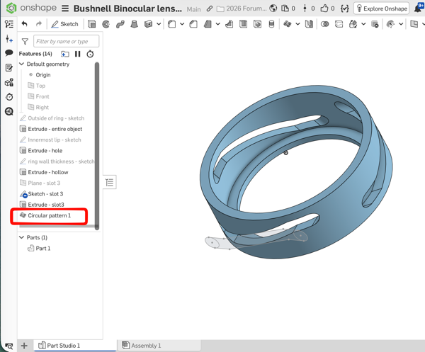

Hi, making a part.. a ring with 3 slits along the edge..
I managed to make 1 slit in the correct position (see top slit in the diagrams)

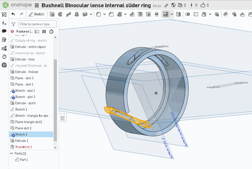

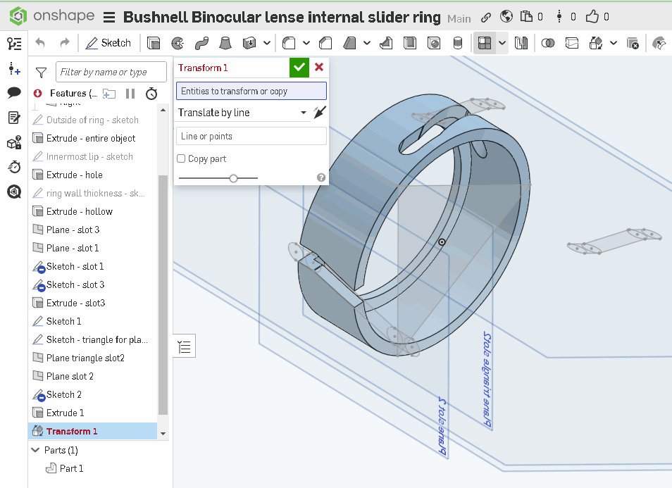

copied and pasted the first slit sketch onto another plane which touches the surface where I want it.. but I can't get it to transform and allow me to rotate/move it lengthwise.. like the first.
is this a bug? it should be straight forward, but it refuses to allow me to select sketch2 and transform.
tried it whilst edited, tried transform and selecting sketch2, tried selecting sketch2 lines.. nope..
am I doing something wrong? is it a bug? How can I achieve the result I require? (I need 3 slits evenly spaced around this ring)
Can you 'convert' a sketch into a separate part maybe.. and apply/transform that?
thoughts?

    "transform sketch" is to move/rotate/scale lines within an "existing" sketch on the same sketch plane. You can't move an entire sketch "feature". You must first be inside of the sketch and then you can transform any or all lines within it by selecting them with a mouse window click, and then pressing the sketch transform button. Note there is a "sketch transform" within the sketch toolbar, and a "transform" for solid parts in the normal toolbar. They are different. Here is the help on it (it looks like the video has a glitch and the screen cutoff the title bar): https://cad.onshape.com/help/Content/Sketch/sketch_transform.htm?Highlight=transform%20sketch

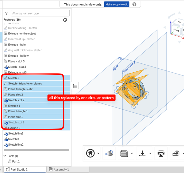

    Transform is the wrong tool for this job. Use circular pattern instead. Pattern the solid feature, not the sketch.

    You really went about the whole design the most convoluted way possible. Here is how you should have done it. One single circular pattern would replace all planes you made, sketches you made, sketch transforms, extrudes, etc. Plus the way you have it now, if you need to adjust one of the cuts, the other two won't adjust with it. Its not good practice to do it that way.

    Hi thanks for the tips guys.. got it working.
    FYI.. transform would not work at all on the sketch when it had circles in it??
    I removed the circles and replaced the ends with curves.. once I did that, the transform tool worked just like it says it should! hmm..
    I needed to flip the slots, the mirror function did this, then just delete the original sketch lines, leaving only the flipped image.. transform to position it!.

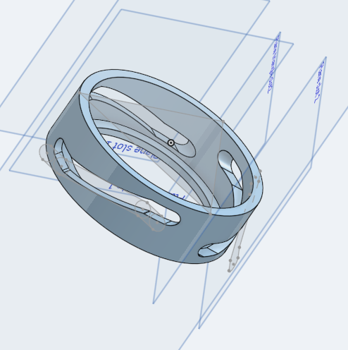

    @anthony_johnston295 Did you intend for the 3 slots to be the same and equally spaced? It's my understanding that is how camera lenses work, but I may be wrong about that. I know my Canon has a witness mark to line up the lens before rotating it… Your 3 slots are NOT equally spaced if that's what you intended. See the picture:
