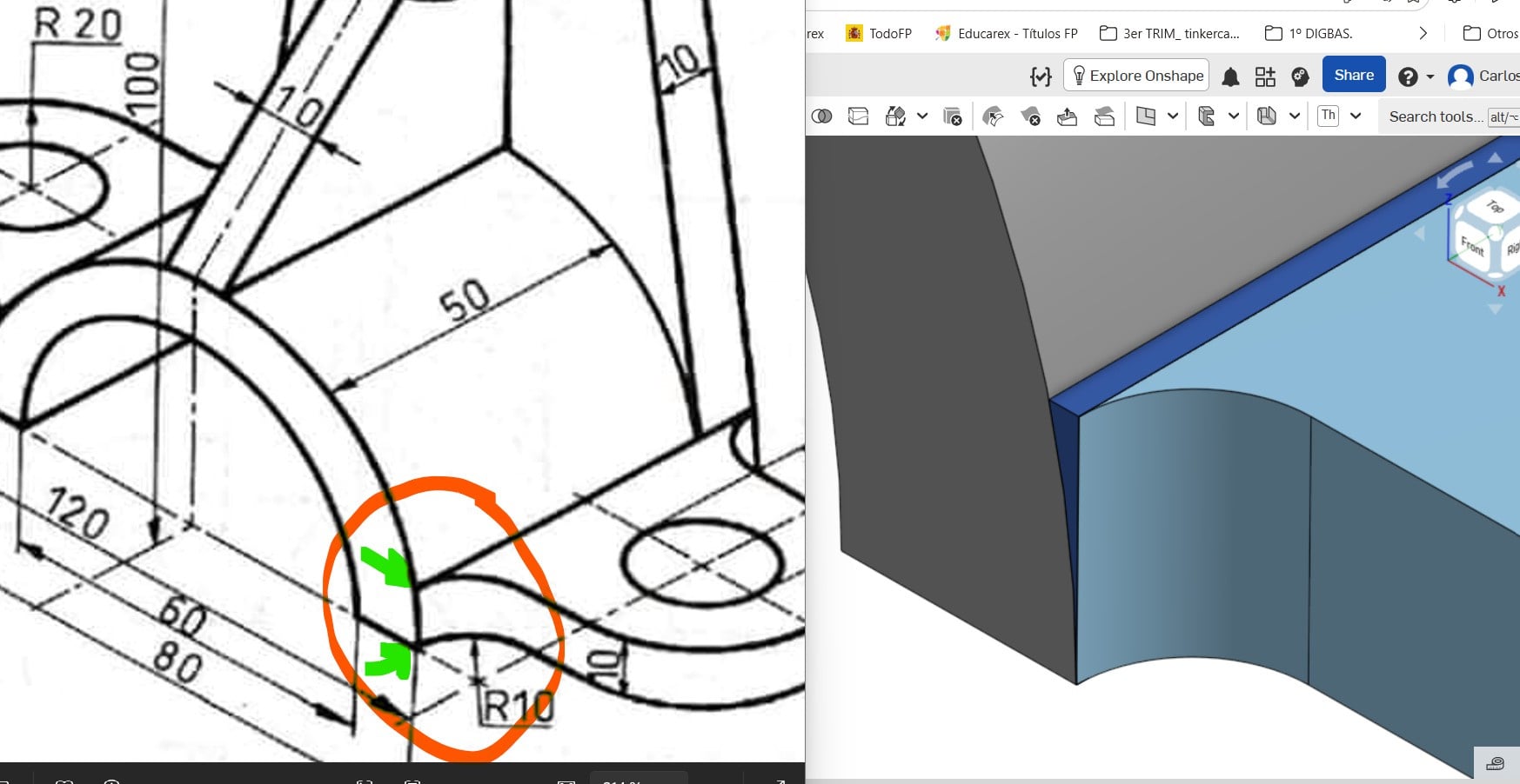

I can´t model the joint. Could anyone kown? Fillet doesn´t work. Thanks in advance

    Hello Carlos. Not sure how you modelled that ear. I think the fillet was the result of a sketch face that was extruded. What is needed is to have the ear and that tunnel joined as one part and then apply the fillet. This document has a couple of methods to attain that. - Scotty
    S1mon Member Posts: 4,588 PRO
    It also looks like you have several parts, not one. You want to use “add” with your subsequent extrudes so you get one part.

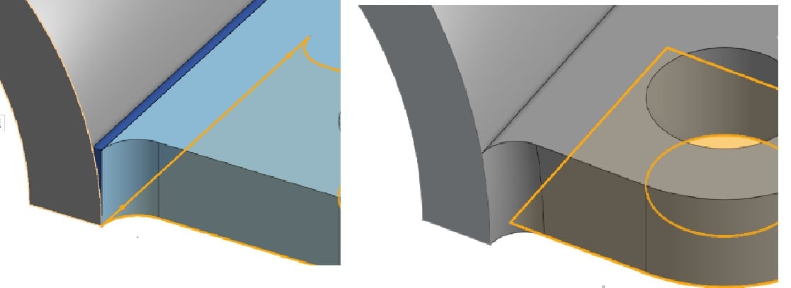

    Thank you so much, Robert and Simon!
    Your answers cleared up my doubts! I made a mistake in the first sketch, and thanks to you, I realized it.
    On the left, you can see my first (incorrect) sketch, and on the right, the second (correct) one.
    Thanks again!
