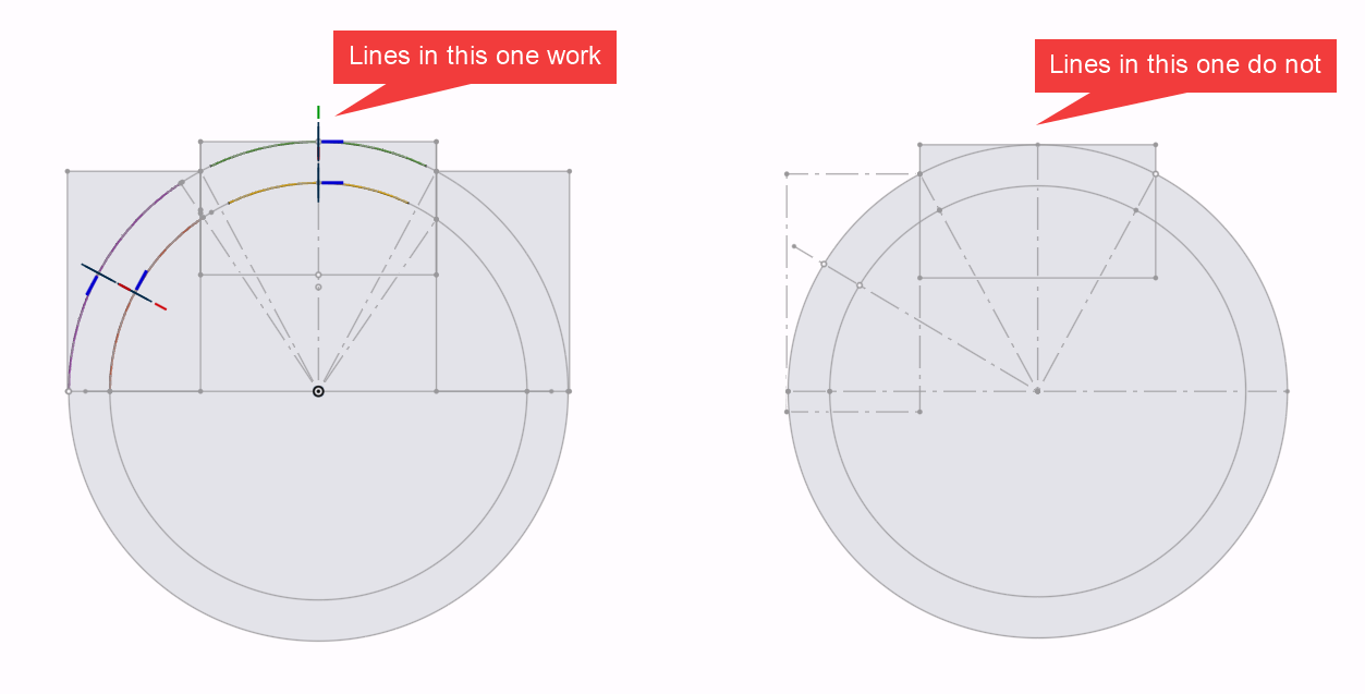

I am having trouble getting a line to work as a revolve axis. I have created an initial sketch with a circle and need to update it to an ellipse so I've create a new drawing on the same sketch and planned on simply changing the revolves I created with the circle. However, when I go to select the revolve axis on the new ellipse the line is not selectable. I've tried many things and ensured I'm selecting revolve axis but hovering over the line in the ellipse does not highlight (the old sketch is still available however so it seems that it must be something with my drawing). I've done this a number of times with other curves but always with circles, does it matter that the line is not from a circle?

    Revolve is by definition circular, if you want to follow an elliptical shape, you need to use the sweep feature instead.

  • joshtargo
    as Eric said, but also these entities, as per the docs:
