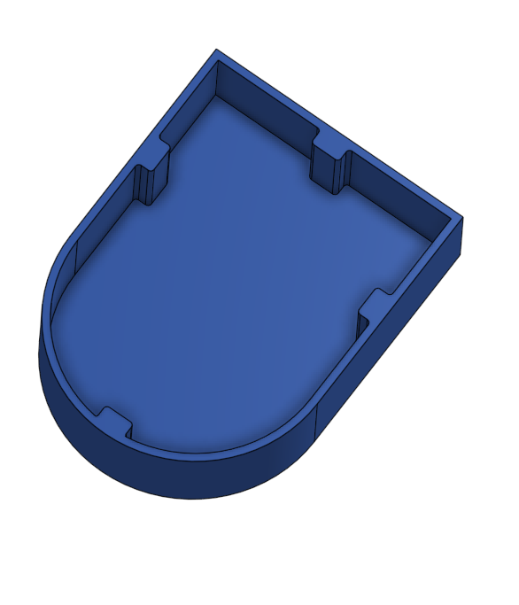

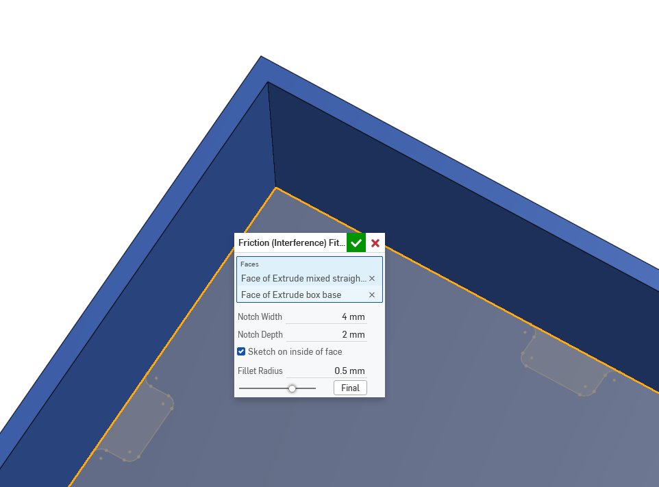

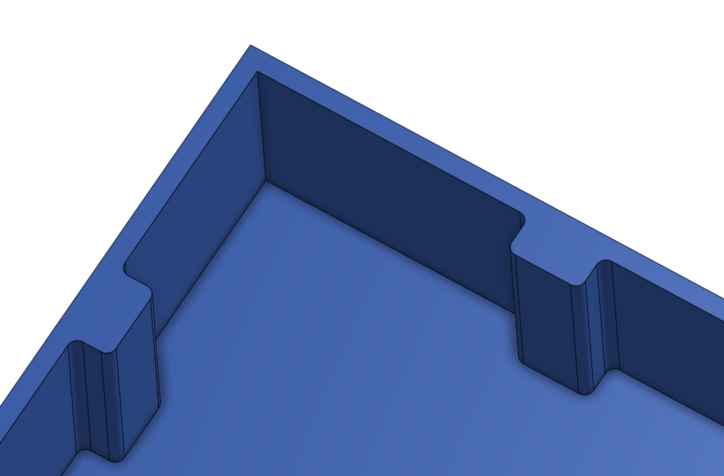

I started adding a small ridge or notch in items that I need to fit together snugly but where I don't trust the tolerance of my printer. I found it tedious to manually sketch 2-4 small ridges to extrude up the side of every box, so I have created a feature studio that does this automatically, adding a sketch to the centre of every edge of a selected face.

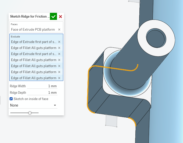

    Updated to version 7 - now adds "exclude" box which allows specific edges on a face to be deselected.
