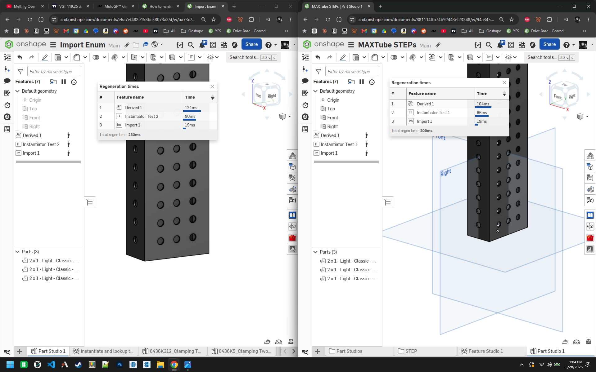

    np, i tried with a typical part from another doc, and then tried the same test inside the doc with the part (but pulling from the Version). times are similar between the two. If I derive from the active workspace, it's a little slower, the other two don't change.
    Is your Instantiator neither a derive, nor an import? Is there a normally available feature or workflow that uses Instantiate? It's faster than derive for pulling in part studios (rather than STEPS via my Import). And I love that yours has a dropdown list, which is what i've been wanting to do with ImportFS
  • EvanReese
    Instantiator is at the core of Derive, but I don't know what else Derive is doing to drive the time up. I'm interested to know if the difference you see is additive or multiplicative. In other words, is the difference always 28% or 34ms? I suspect the latter is closer to the truth.

    Yeah, instantiator is the FeatureScript-name for Derive. Same thing under the hood. Time-wise I believe it's mostly just doing so many additional checks and balances as a native user-facing tool, that a custom instantiator-tool never bother with.
