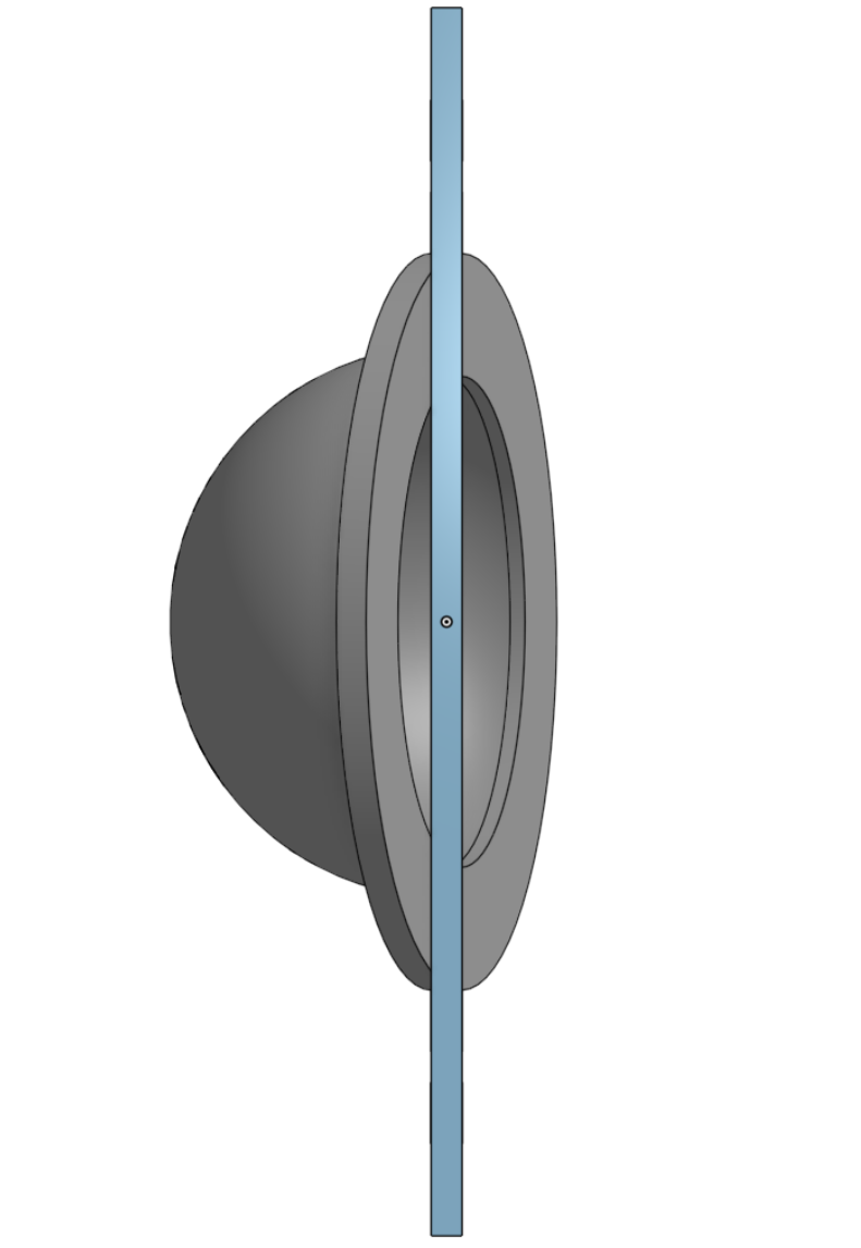

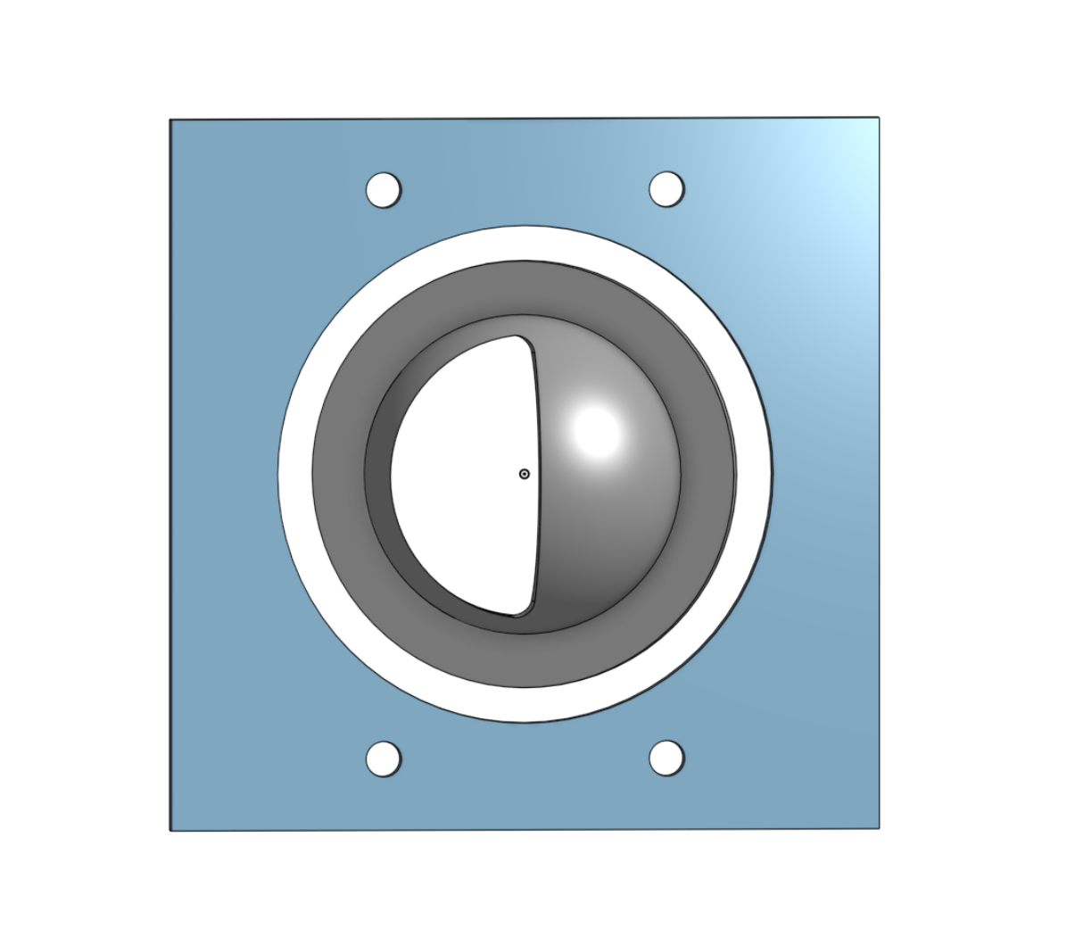

How do I blend the two inside faces too each other? I can't seem to get face blend to work. Plz Help
https://cad.onshape.com/documents/c5684b823c04af1ec354a756/w/4360f2a9b3dae329827ae9f2/e/e1df25300d4c
I want to blend a face between the outer perimeter of the center piece to the inner perimeter of the outer piece and can't seem to setup a face blend. Am I doing it wrong? is there a better function to use? any help would be appreciated.

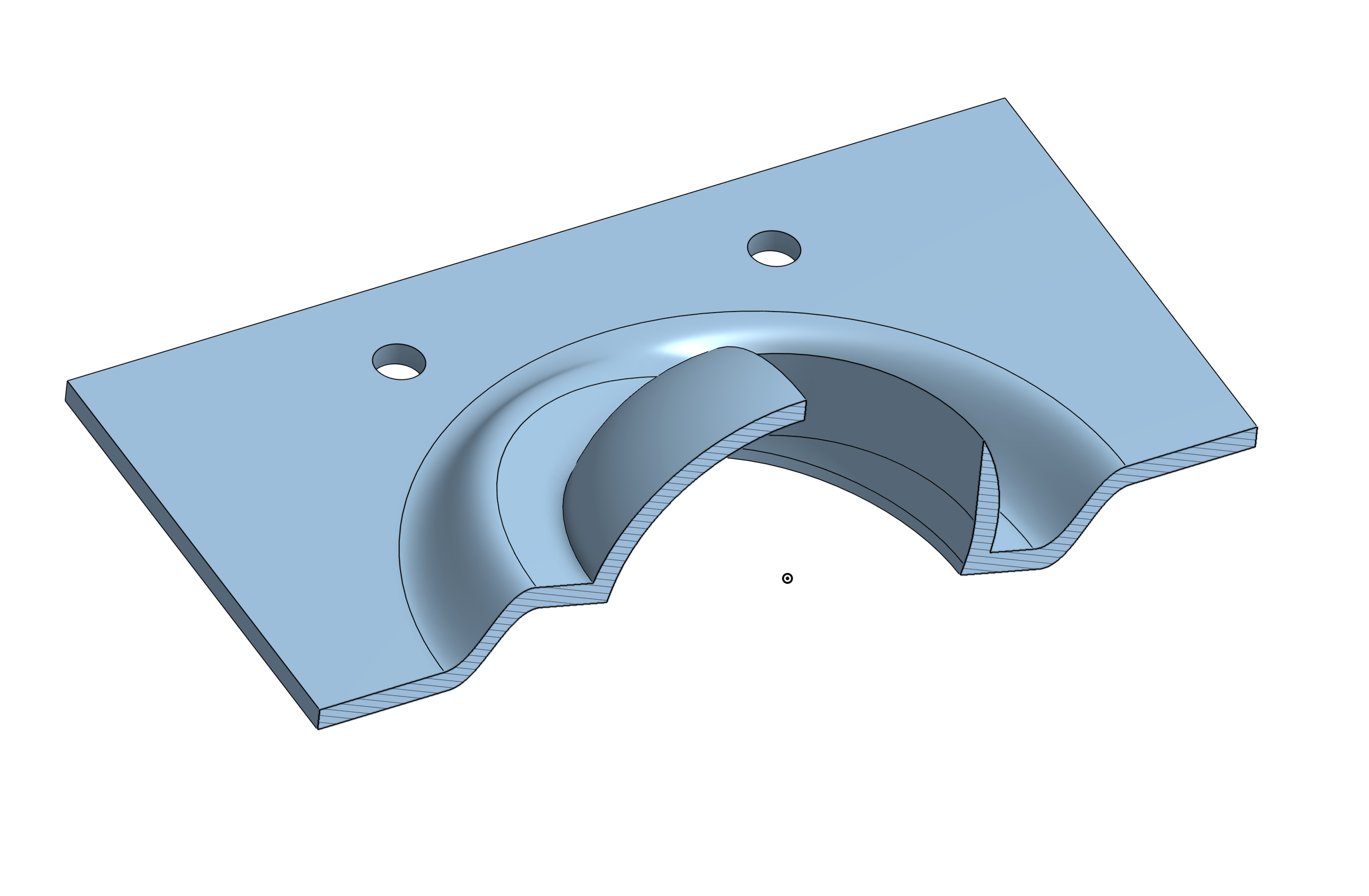

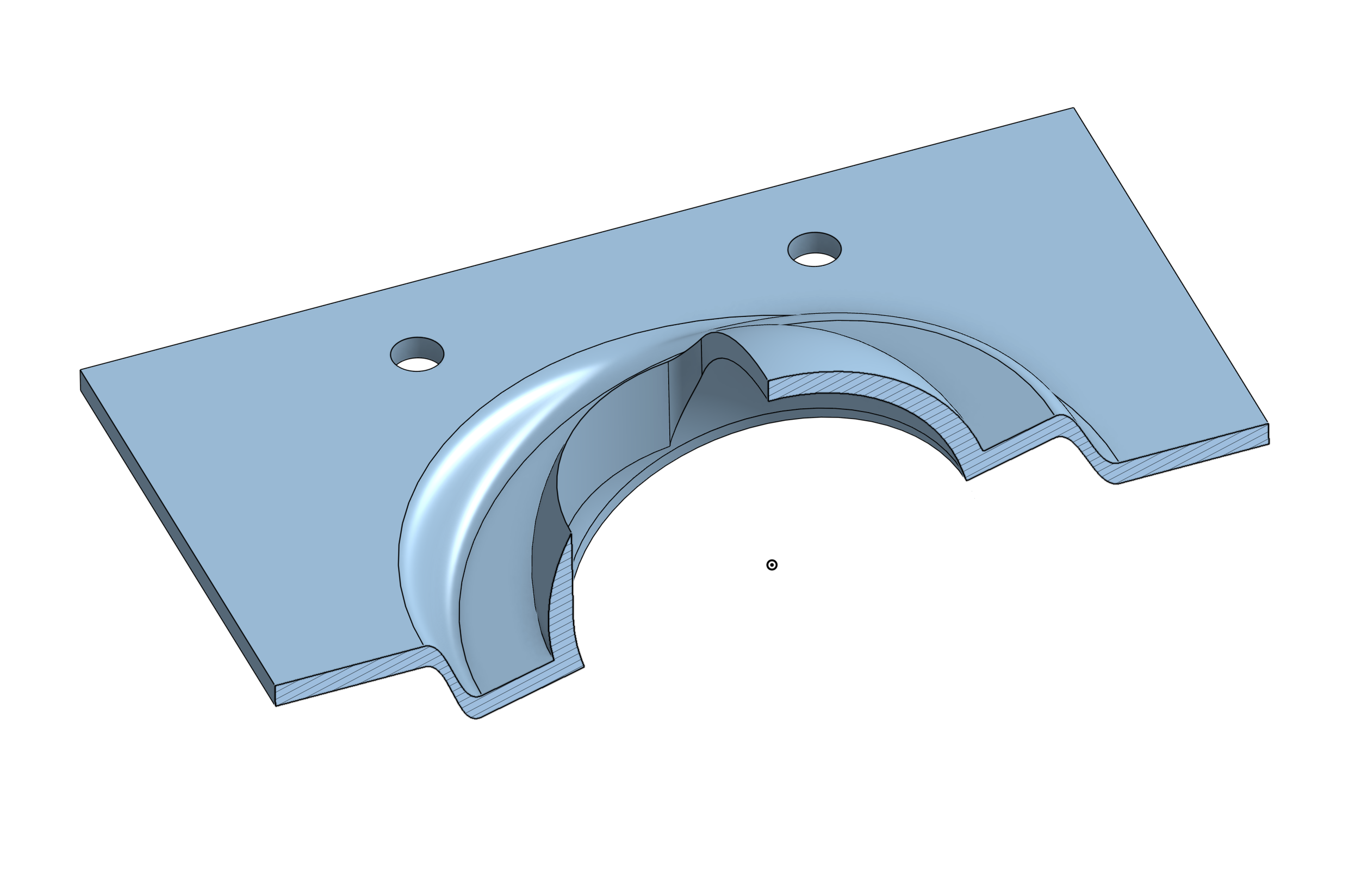

Hey! Surface Blend is a surface tool—it does not work with solids. You would need to delete the inner faces first…
and then I’d go with a simple surface loft for the top side and another loft for the bottom.And since everything is quite tight… if you want to end up with the same wall thickness, some more modifications are needed :)
See my versions here:Greg Brown also has a video about a similar problem: https://www.youtube.com/watch?v=Rk3U3slQ9tA&t=930s

Thanks a Million. I appreciate the how to and the model for clarity. It really helps in learning the software!
very welcome! and it is an interesting problem.
And i'm sure there are better solutions than mine:)0
