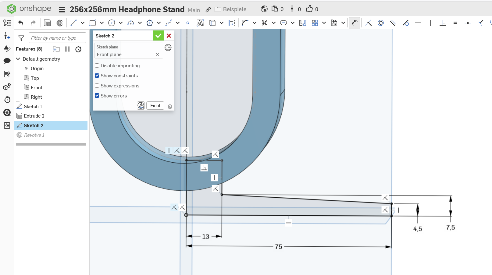

That does already look like the thing. Next, make a new sketch for the foot, on the same plane:
It might be a good idea to make the top point congruent with the inner face of the loop.
Then revolve the foot sketch around the center axis:

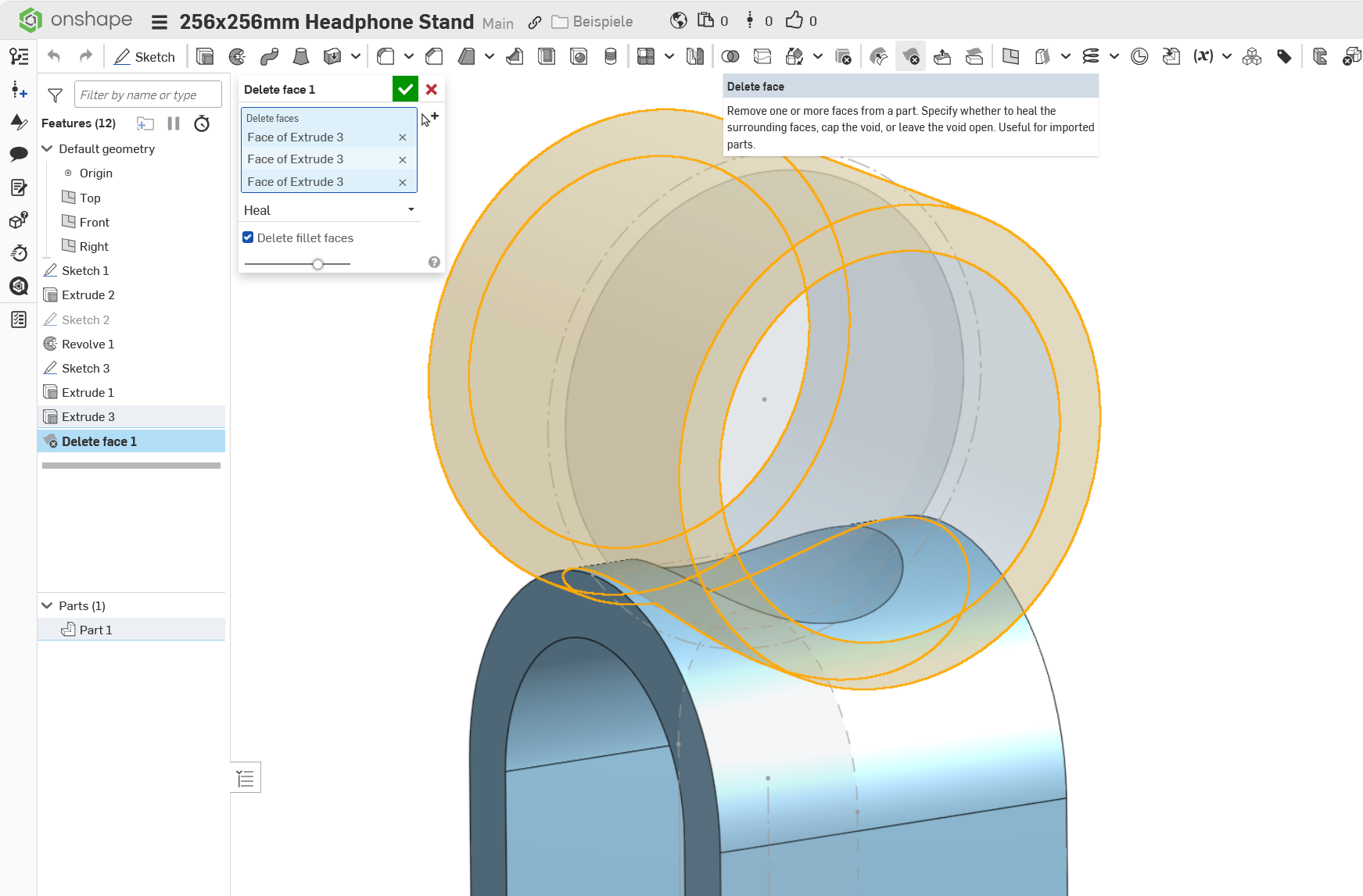

Now, you need to make a cutout and the part that replaces the cut away material:
This can be done by REMOVE-EXTRUDING the sketch.
Then we need the part that closes the gap:
Here, a THIN EXTRUDE is used. limited to the outer faces of the loop. This creates the material needed, but too much, of course. We can gemove that faces we don't need:
You could add a little chamfer all round for good measure.

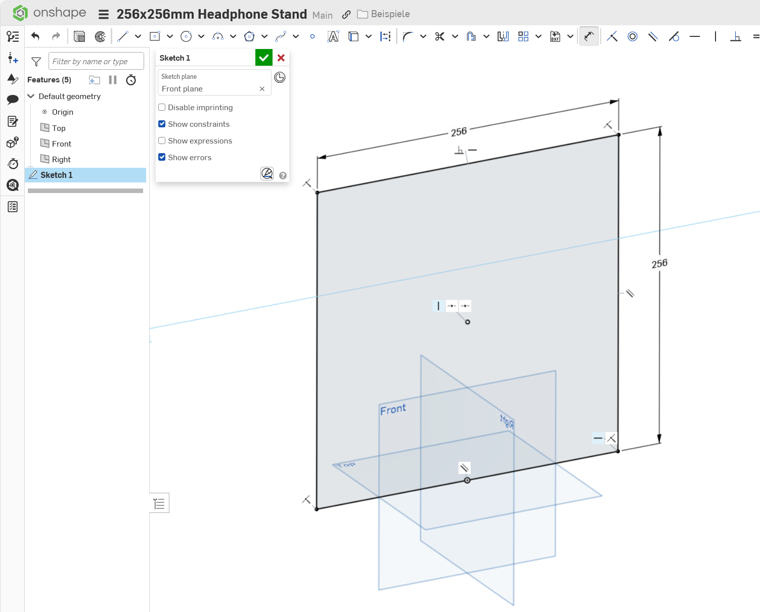

Create a sketch on the "Front" plane.
Draw a square and dimension it to 256 x 256mm

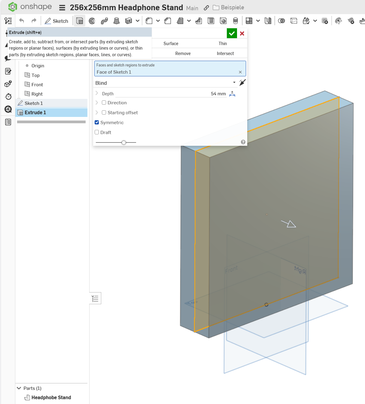

Extrude the square by 53mm, using the "symmetric" option
Name the resulting part "Headphone Stand"

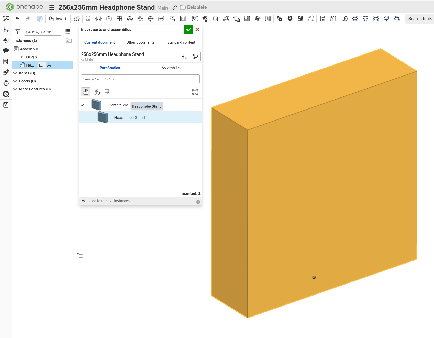

Create an assembly.
Insert the Headphone Stand into the assembly.

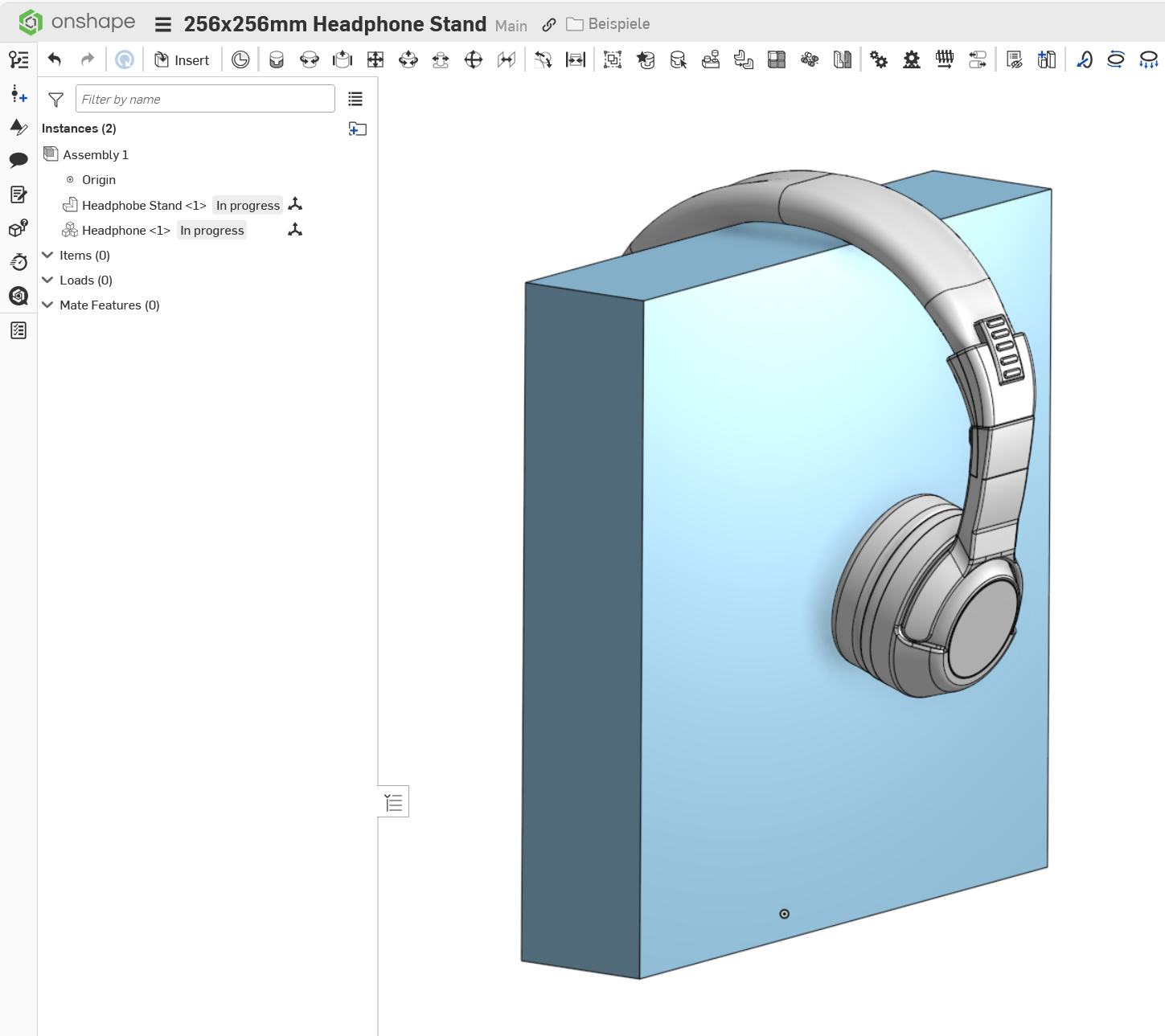

Hang your headphones.

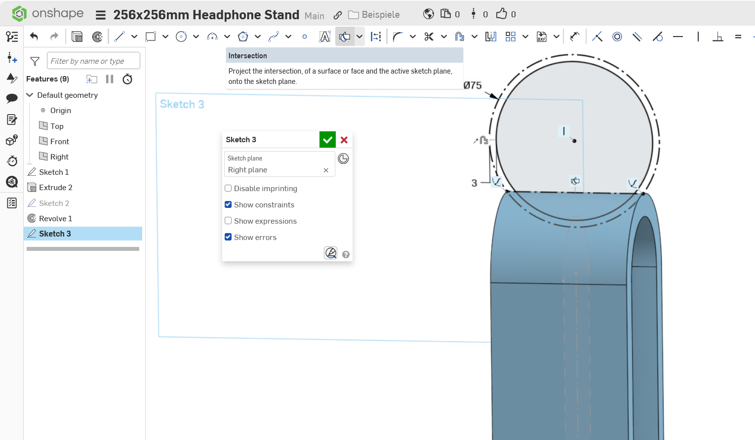

Next, take care for the recess that takes the headphone, make a sketch on the side plane:
In this case, I used an intersetion line as a reference for the construction circle. The inner circle is done with the offset tool. This will lock the diameter to the width of the loop, for later edits.

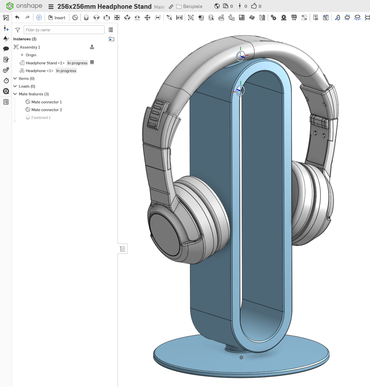

Then, you can create an ASSEMBLY and hang your Headphone:
Have Fun!
