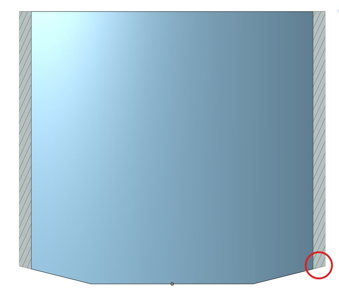

I cannot get this shape right
I am not a newbie and have a some experience with Onshape, but I am running into issues getting this shape right. It is a rectangular shape with 2 straight and 2 curved sides.
The bottom is where I am running into issues. The way I am trying to do it, is giving me unnecessary facets:
I just want the bottom edge to run smoothly from the corner to the bottom edge of the curved sides where it becomes horizontal again.
Any ides on how best to do this?

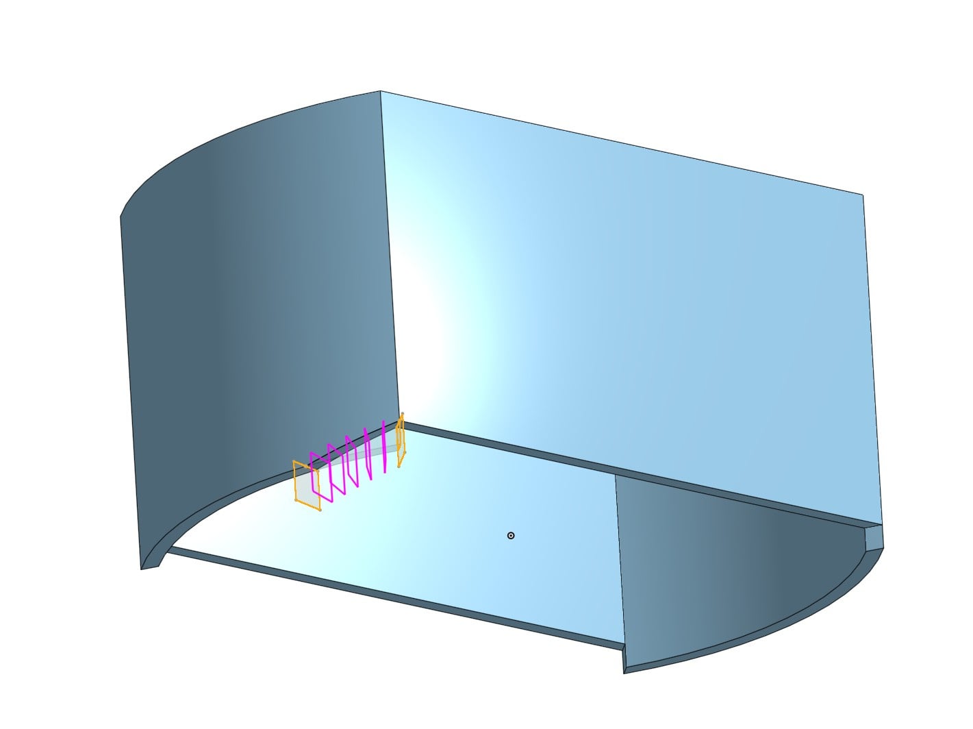

Hi Matt,
Thanks, but I had tried that as well already. Issue is that it creates a slope at the bottom.It got me thinking however, and I realized that I can by doing a remove loft with a path.
I now only have to mirror the feature a couple of times and have the shape I was looking for.
Sorry, double comment
Hi Matt,

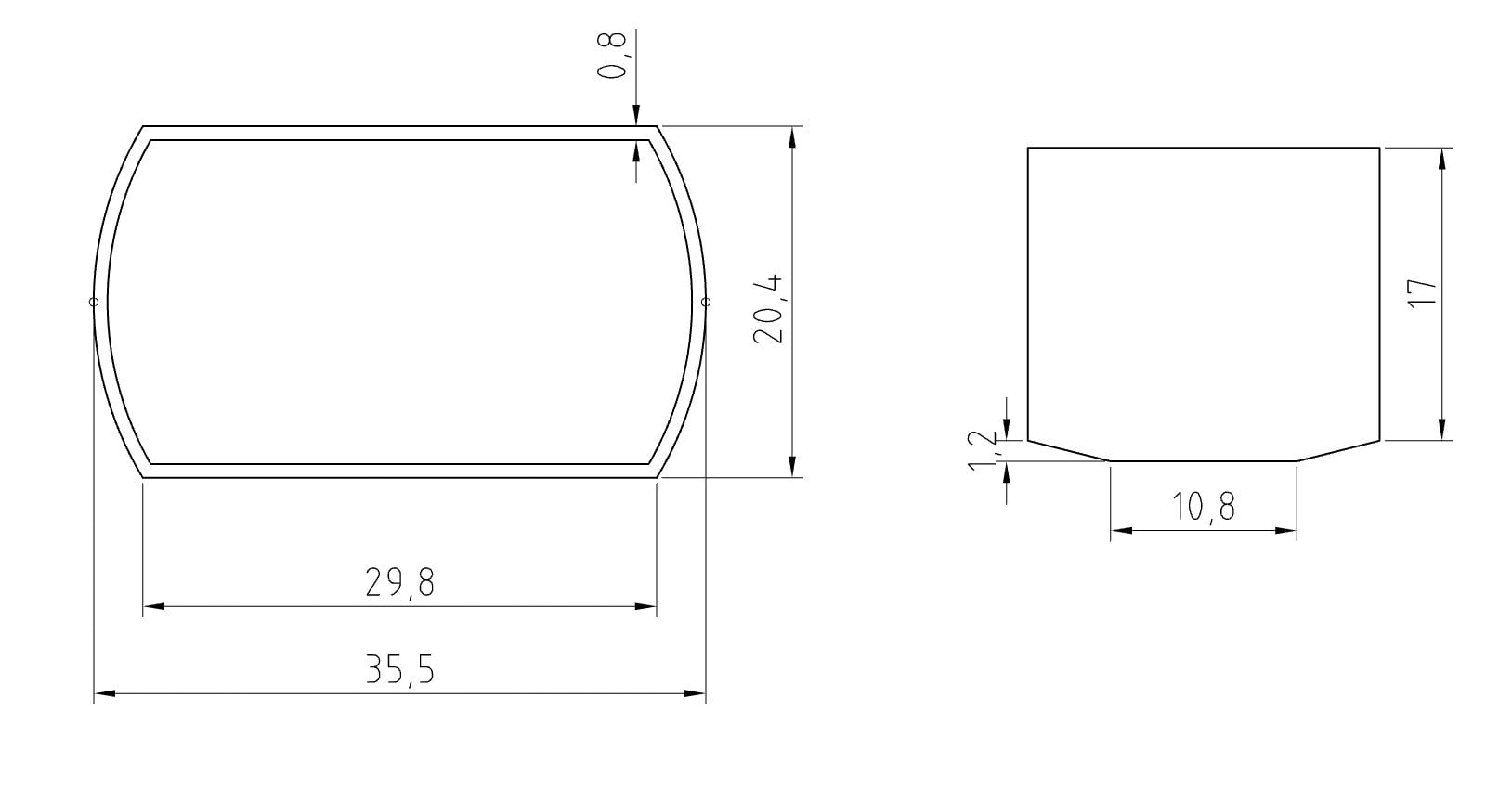

I went through your document and I'm confused at the final shape you want. You have a lot of features to make some sort of lip at the bottom. Is there another part that will attach to the bottom or elsewhere? Do you have a hand sketch perhaps of what the final design, with all parts if more than one, is intended to look like?

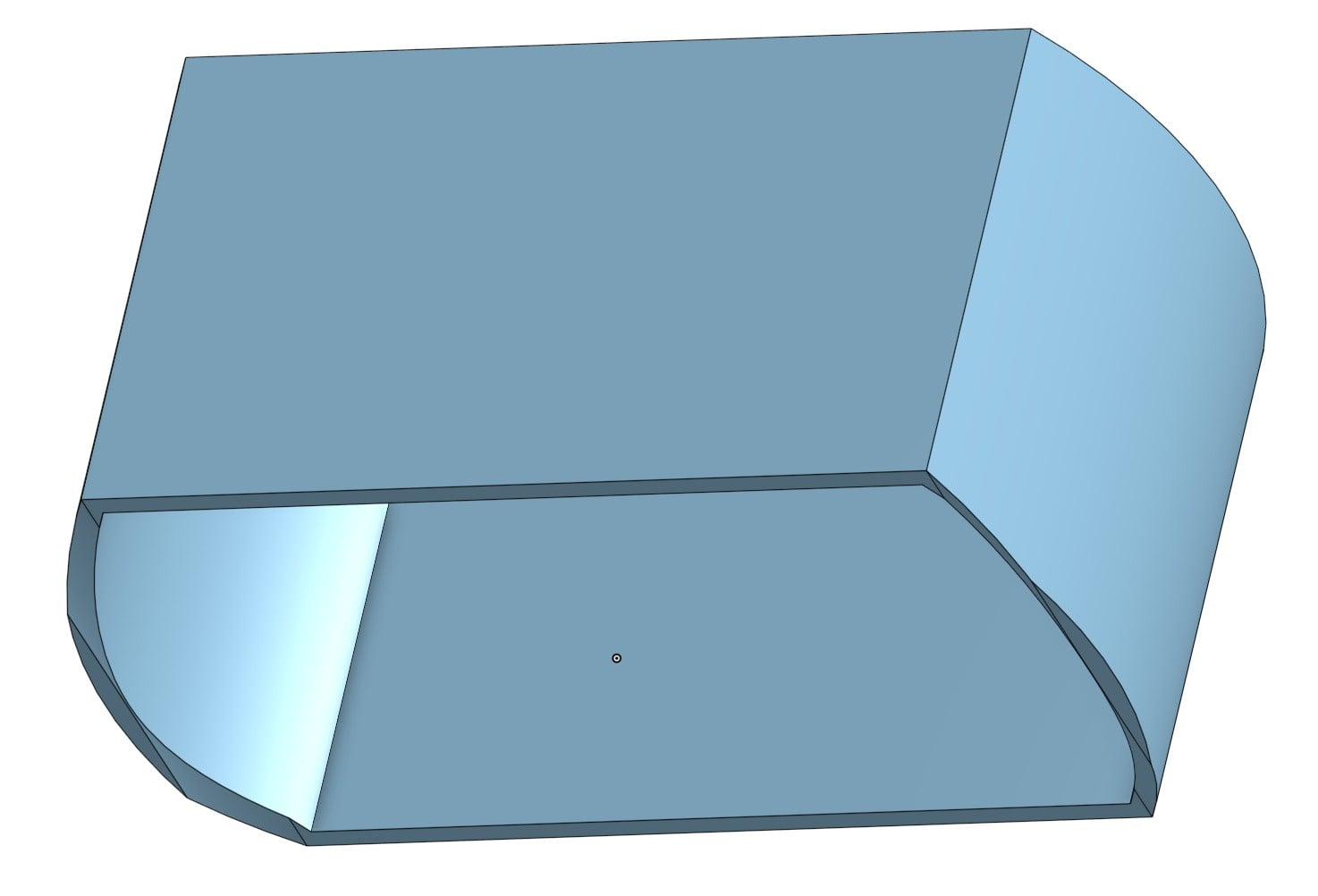

Here's maybe a much simpler way of doing that?
1 -
Hi Eric,
That is very helpful, thanks! You have shown me a lot of new options here.
Cheers, Jeroen
