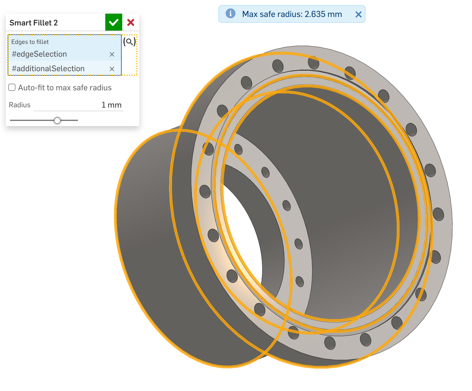

Smart(er) Fillet: a FeatureScript that figures out your maximum fillet radius before you do.
The intention of this FeatureScript is not really to replace the current fillet tool, at least not right now, but to share an idea of how features can be computationally smarter and more user-friendly. It came up from some thinking on the cache trick by @Derek_Van_Allen_BD (here), as well as finding some fun functions in STD called startFeature/abortFeature. I’m curious if anyone else has used startFeature/abortFeature for probing geometry mid-dialog. I'd love to hear what you've built with it!
What it does

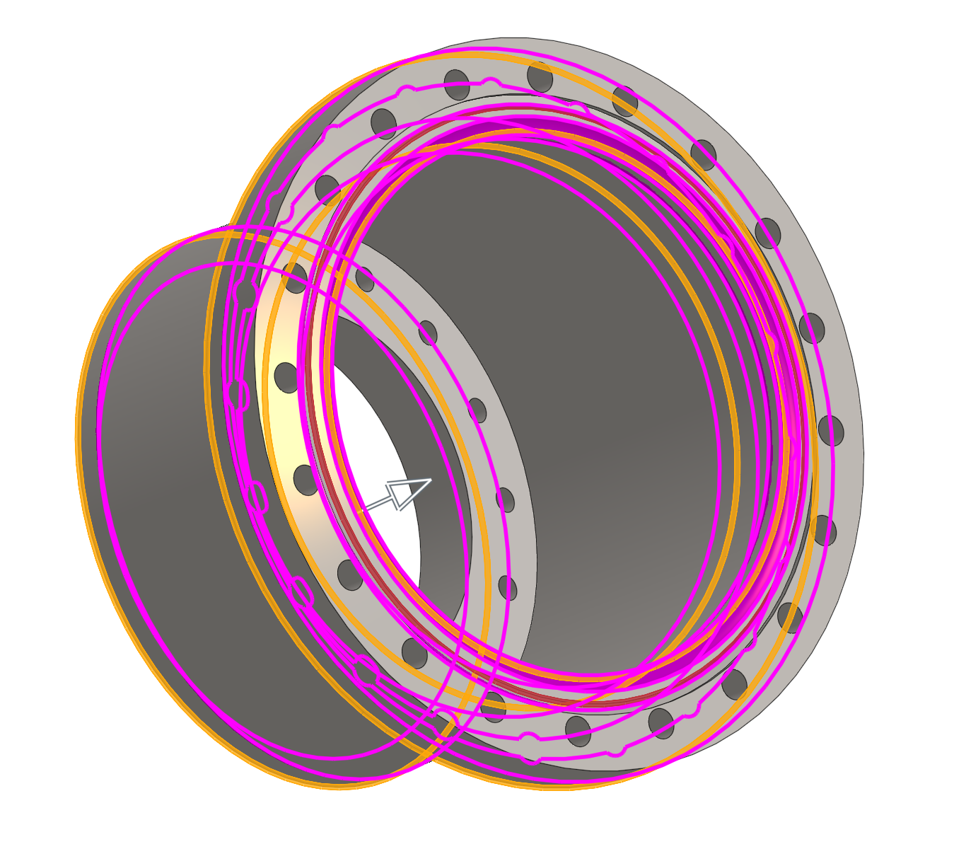

Has this ever happened to you? You select some edges, type in a radius and it computes just fine. Add a few more edges and all of a sudden a massive hairball of magenta fillet errors. Halve the fillet dimension. Red error again. Halve again. Eventually something sticks and you move on, never quite sure if you could have gone bigger. What you're doing by hand is a binary search. So I built a quick FeatureScript that does it.
Smart Fillet is a simple representation of the standard fillet. Select your edges, and while you're still in the dialog, before you've committed anything, it tells you the maximum safe radius right there in the feature panel. Feature still fails red if fillet is too large and can’t compute; but it tells you how to fix it.

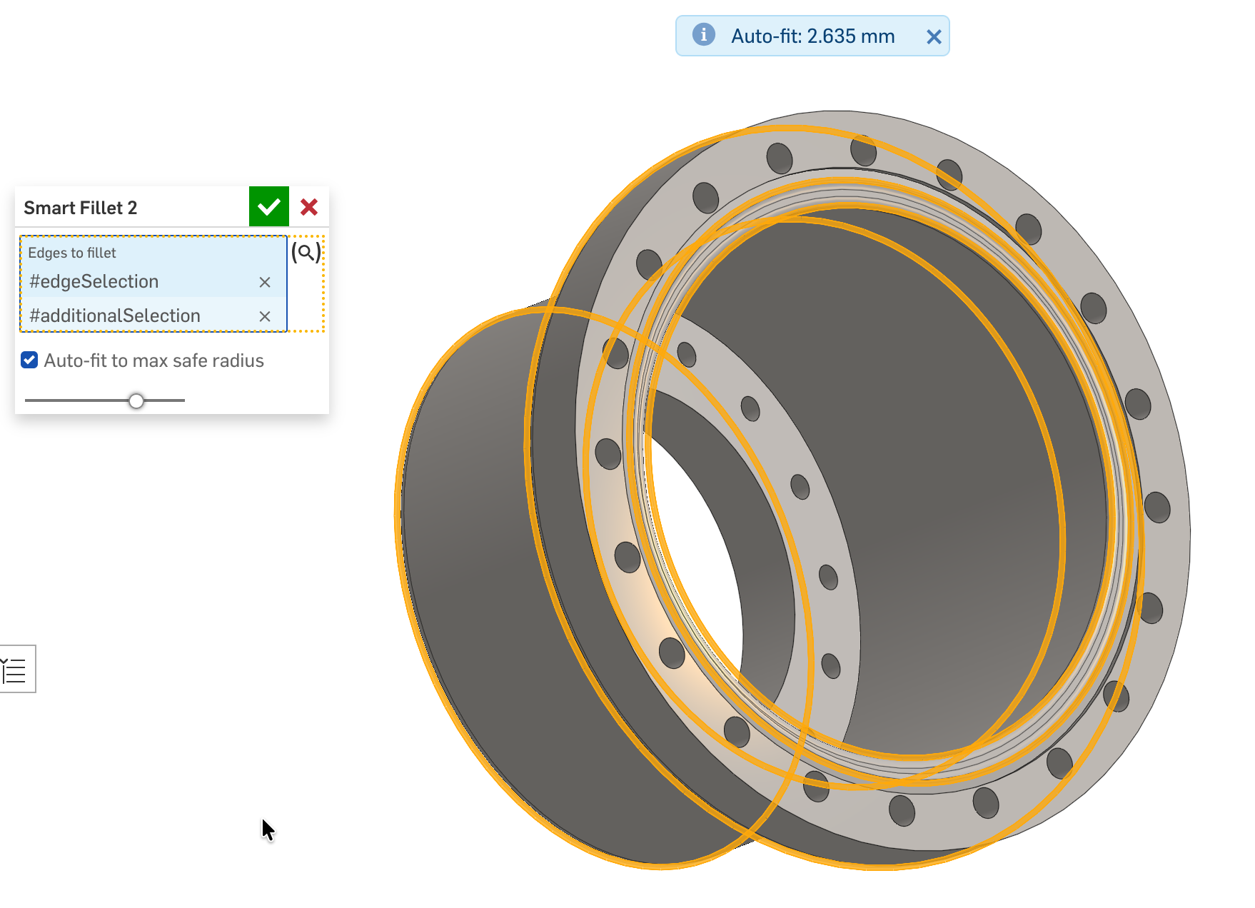

There's also an auto-fit toggle. Enable it and the radius snaps to the new max safe whenever you change the edge selection or edit the part upstream.
The magic
FeatureScript has a mechanism called startFeature/abortFeature, a geometry transaction that always rolls back. Inside the editing logic function, the feature secretly attempts the fillet at a candidate radius, checks if it succeeded, then rolls it back completely. No artifacts, no flicker, like it never happened.
Run that probe 12 times in a binary search and you converge to the max safe radius. The search exits early when the gap between the last safe and first failed radius is under 0.01 mm, so typical cases resolve in 6 to 8 probes rather than the full 12.

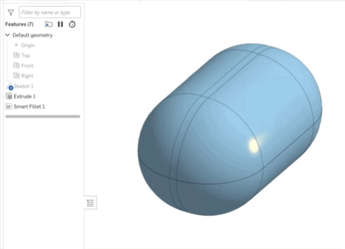

    On the editing logic, it does actually compute out-of-date cache and if so re-compute the max fillet without user intervention. See the gif, sorry for it being slowed down, for some reason the gif converter also slowed it down. There may be smarter ways to gather and check cache data?
