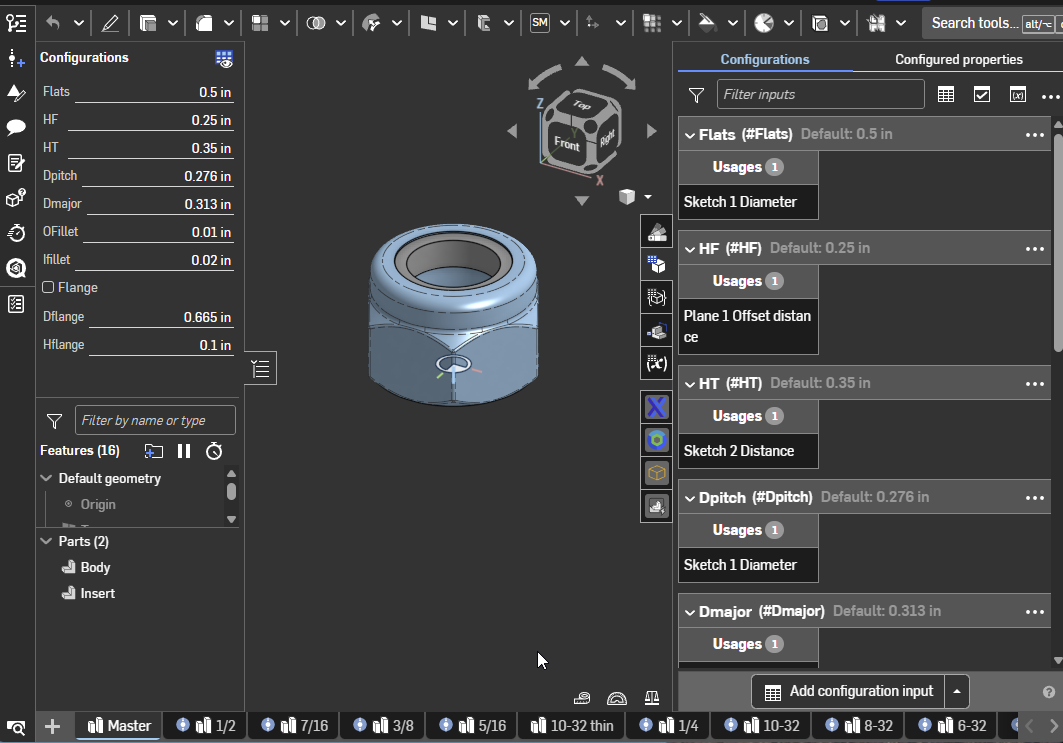

Is there a way to make an assembly configuration list that picks different parts studios/parts. I'm trying to make an assembly list that will pull different sizes of custom nuts, each size is in its own part studio, so the assembly would have a pulldown with all the sizes and once selected Onshape pulls the part from the part studio into the assembly. I suppose I could put all the sizes into 1 part studio and use the part studio for the size and configure suppression but don't want to have too many configurations in 1 part studio.
  • eric_pesty
    The performance issues are when you have multiple parts in a part studio and only "some of them" need to be configured.
    In this case a single nut model (built with variables etc) is likely going to give you better performance than getting a single part from multiple part studios…
    A good option would be to create a "universal" model setup with configuration variables and then derive that in a separate studio to create a subset of configurations (deriving a version instead of the workspace is a good idea for performance reasons).
    Here's an example of what I mean. I have a "master" model driven by a bunch of configuration variables that can be used to generate any nut sizes:

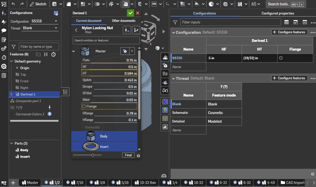

    Then to keep things a bit more manageable I created one part studio for each size by deriving this in. Most of the configuration variables are "set" in the derive dialogue and just the relevant ones are configured:
    Note that I could have added a configuration input for size and configured the other values there. A side benefit of deriving like this is that because it is coming from the same original model, you can do a "replace" in an assembly to change the size and the mates don't break.
