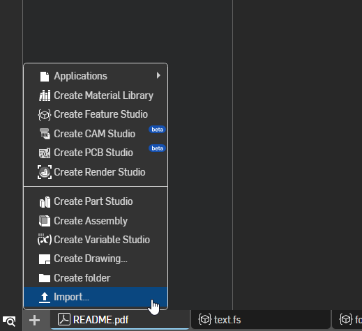

- In the bottom left of the document select "Import" and import that json file.

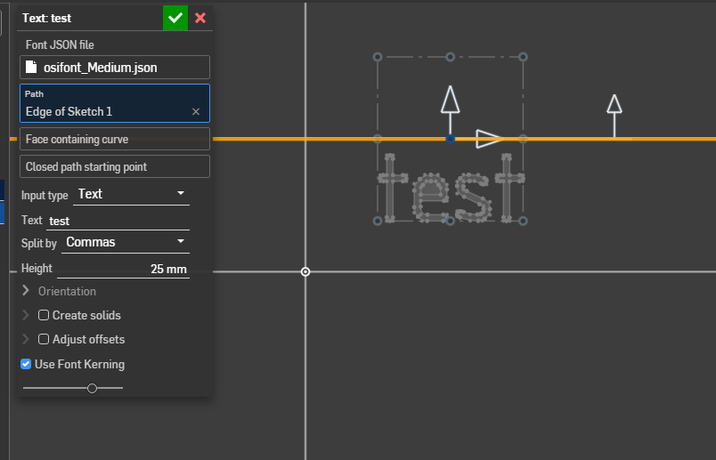

- Create a Custom Font Text feature

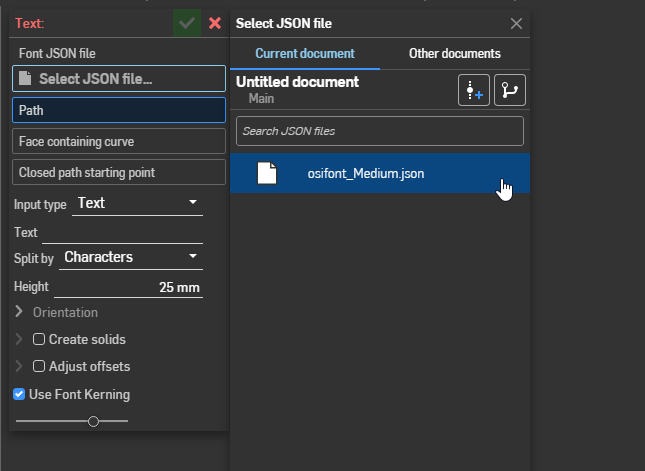

- Click the "Select JSON file…" option and select the imported font
- Click "Path" and select the sketch line
- Add some text
