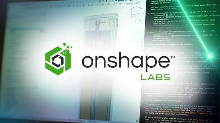

ONSHAPE LABS
Onshape Labs is a new initiative for rapidly developing and testing cutting-edge capabilities, including AI-driven tools, directly within the Onshape cloud-native CAD and PDM platform. By combining early customer feedback with rapid product releases outside of Onshape’s standard 3-week release cycle, Onshape Labs creates a faster path to deliver advanced tools.
NVIDIA SIMREADY PUBLISHER
Onshape Labs introduces the NVIDIA SimReady Publisher, available in the Onshape App store.  Go from CAD to advanced simulation faster with direct publishing from Onshape to platforms compatible with NVIDIA Omniverse, including Isaac Sim. Define robotics behavior within your Onshape assemblies, export simulation-ready OpenUSD data, and keep simulations synchronized as designs change. A robust feedback and update loop between design, simulation, and controls development helps robotics teams iterate confidently as hardware evolves.

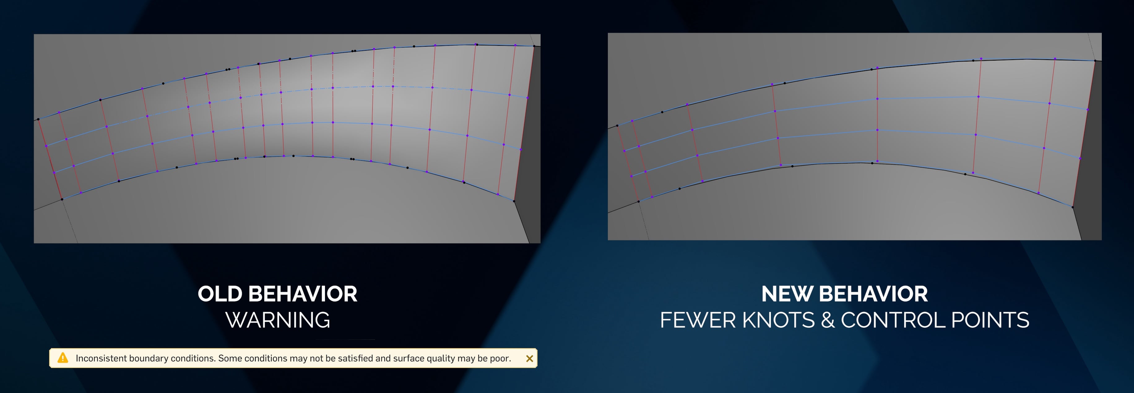

BOUNDARY SURFACE APPROXIMATION FAILURES
The underlying algorithms for the Boundary Surface feature have been updated. While the user interface remains unchanged, the update yields higher-quality surfaces and reduces 'inconsistent boundary conditions' warnings. The distribution of control points and knots is also cleaner using the new algorithm, improving boundary surface workflows.

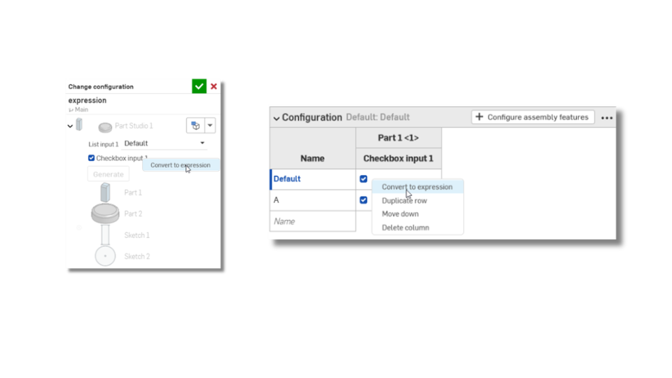

CONVERT TO EXPRESSION IN ASSEMBLIES
Instance checkbox and text configuration inputs can now be converted to expressions via right-click when changing the instance configuration and in configuration tables.  Note: Assemblies currently do not support dynamic suppression.

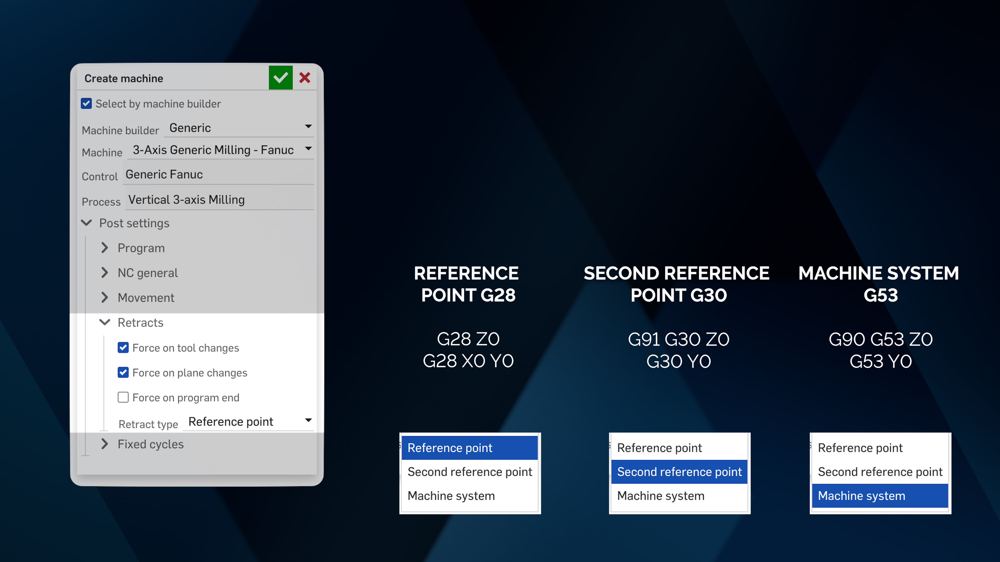

POST SETTINGS FOR "MACHINE RETRACTS"
CAM studio now offers the ability to set default machine retracts for the following post-processors:
  • Generic Fanuc
  • Fanuc 31i B
  • Tormach PathPilot
  • Penta TCPC-Kinetic
  • Datron Next
  • Haas NGC/CHC
In post settings, users can now choose reference point G28, second reference point G30, or machine system G53 on tool changes, work planes that change orientation, and program end.
  • Reference point G28: G28 Z0 / G28 X0 Y0
  • Second reference point G30: G91 G30 Z0 / G30 Y0
  • Machine system G53: G90 G53 Z0 / G53 Y0
We will continue to update existing post-processors to include these options in future releases.
Machine Retracts Menu

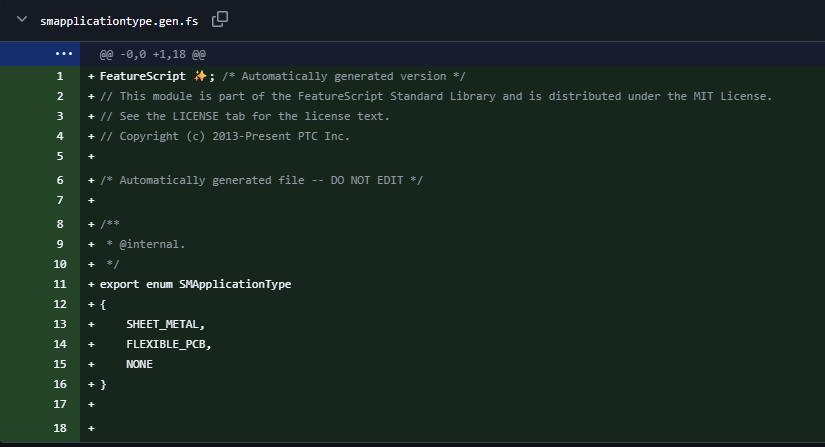

    Been a few months since I combed the diffs looking for breadcrumbs (since the javawizard mirror has been out of date) so I haven't been able to look for clues to future updates since then. I did just scrape together my own featurescript mirror that shows the last few updates and spotted this little addition to the sheet metal roster.
    Looks like we're getting some support for non-sheet-metal flexibles in the future. I've got whole classes of bendy things patiently waiting to see the new updates to the sheet metal engine, none of which are made from sheet metal.
    I also saw that the sheet metal bend feature appears to have been completely refactored, I'll have to wrap my head around how that change affects things and whether it opens any new possibilities or if it was a simple re-base.
