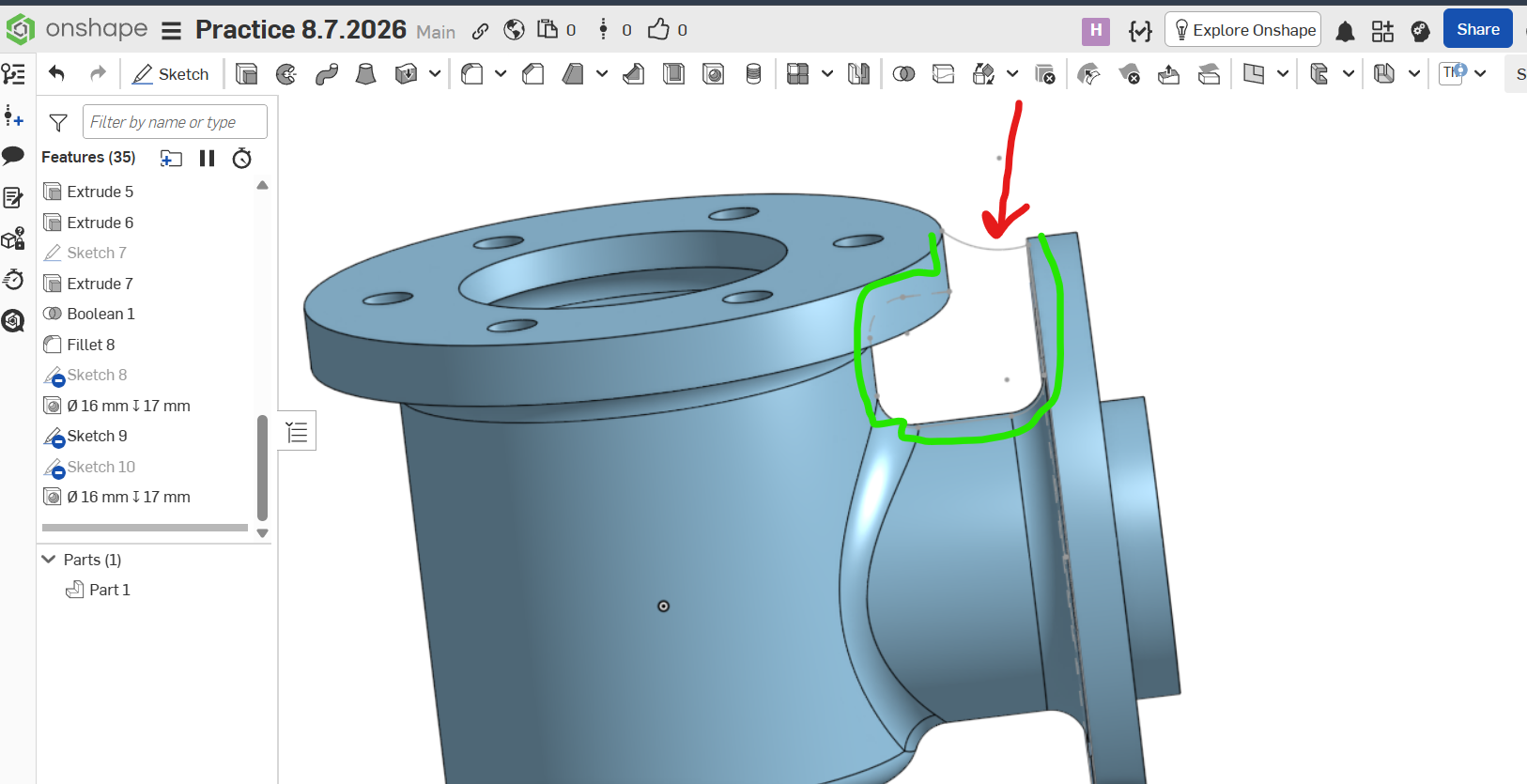

How to make a rib towards the direction of red arrow and upto both flanges?
  • harinderjit_singh
    harinderjit_singh Member Posts: 4 ✭✭
    Neither a rib is generating nor extrude is happening
  • robert_scott_jr_
    Hello. I see only one line of a sketch. Does the rest of the sketch also include other elements that enclose the area that would make the rib? If so, is it a closed shape? - Scotty

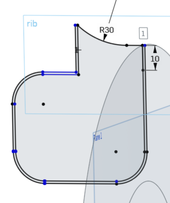

  • robert_scott_jr_
    I completed the rib shape in sketch 9 (now named 'rib') by use of the Use tool. However, there were some very small gaps between the ends of two lines. After closing them the sketch became fully closed (turned grey).
    The Extrude Add feature of the sketch resulted in an error. Suspecting that the extrude and Part 1 were not overlapping some place, I went back and offset the edges of the sketch that were touching Part 1 by 1 mm. That resulted in a successful rib generation.
    - Scotty
