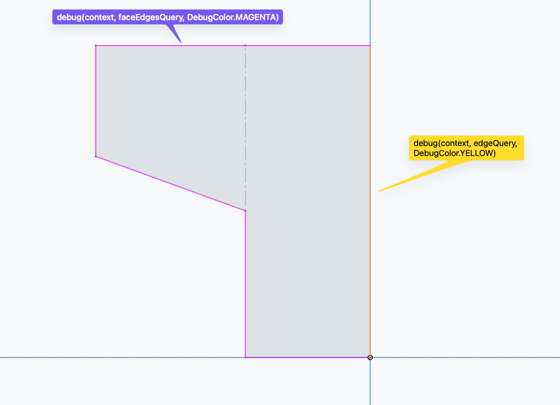

I'm developing a simplistic feature that takes two inputs:
  1. A face
  2. An edge
My only constraint is that the edge belong to the face. In other words, if I query the face for all edges, I expect that the edge selected will also be in the set. To accomplish that, I've written a simple FeatureScript function called faceContainsEdge

The problem (obviously) is that this doesn't work. I can see via the addition of debug lines that both the edgeQuery and faceEdgesQuery evaluate correctly:
If I try to print the two queries, I see the following:
  1. Each faceEdgeQuery in the loop is a map with structure: Query 1: { queryType : TRANSIENT , transientId : JIV }
  2. The invariant edgeQuery is a map with structure: Query 2: { queryType : UNION , subqueries : [ { flatFilter : NO , queryType : SM_FLAT_FILTER … ]
And the function returns false always. How is this areQueriesEquivalent supposed to function? Do I need to convert the results of evaluateQuery in some way? How can I make the comparison meaningful?
  • NeilCooke
    Correct - a Query (the "search" term) and an evaluated Query (the result) are not the same thing, If you find the edges of the face using qAdjacent then all you need to do is check if qIntersection(edges of face, selected edge) is empty or not.
  • charles_randolph
    charles_randolph Member Posts: 15 ✭
    Thanks Neil. I interpreted the evaluated Query to be a list of sub 'search terms', one of which would have an identical 'term' to that being sought. I think I still have to get used to working with queries a bit.
  • lana
    Sketch face has a certain peculiarity. The sketch segments you can select on the screen are wire bodies. Edges of the sketch face are not selectable.
