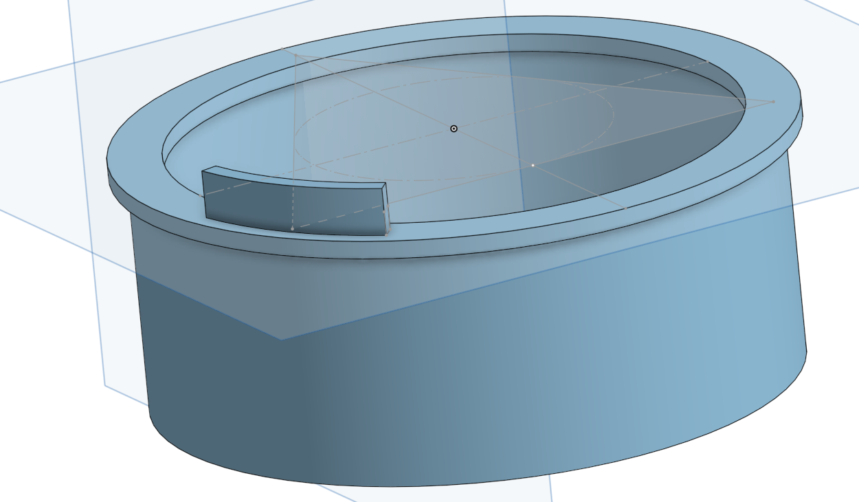

Hi,
I’m a complete beginner and could use some help here.
There need to be three locking tabs 120° at the end of the tube (like a bayonet mount),
but unfortunately, I can't create a sketch on the curved surface to draw the profile and then cut it out.
Does anyone have any ideas?
https://cad.onshape.com/documents/528b8b14746ae29e76853ae2/w/799bbc55f53fd5a5f3db90fe/e/530cc1ba297a018955d0408f

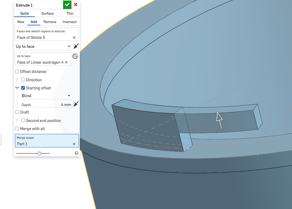

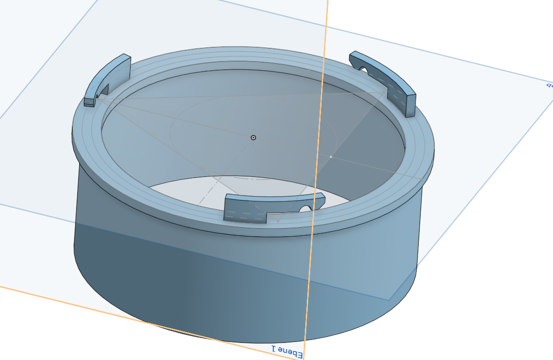

    Try drawing the cutout shape on one of the main planes then using the Wrap feature to wrap that sketch as the tab. You should be able to do it in a single Wrap without needing to subtract material. Once a single tab is in place, use the Circular Pattern feature to pattern the wrap feature 3x around the tube.

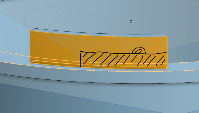

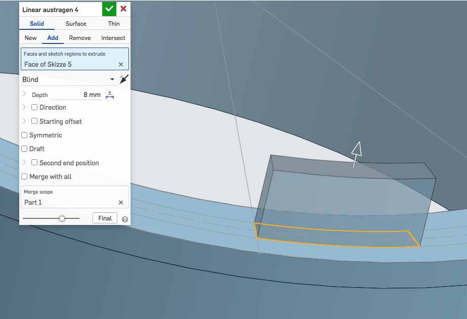

    Maybe this…
    Screen Shot 2026-07-22 at 9.24.14 AM.png Screen Shot 2026-07-22 at 9.26.01 AM.png Screen Shot 2026-07-22 at 9.46.39 AM.png
    … then circular feature pattern.

    Unbelievable! It worked xD

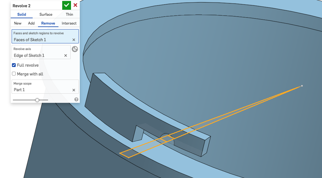

    I actually did the hole differently than you described because I have no idea how to select the right axes for it.
    I created a new sketch on the underside of the latch, drew the cutout on it, and removed the material.
    Then I added some fillets, and voilà! Thanks a lot for your help.
