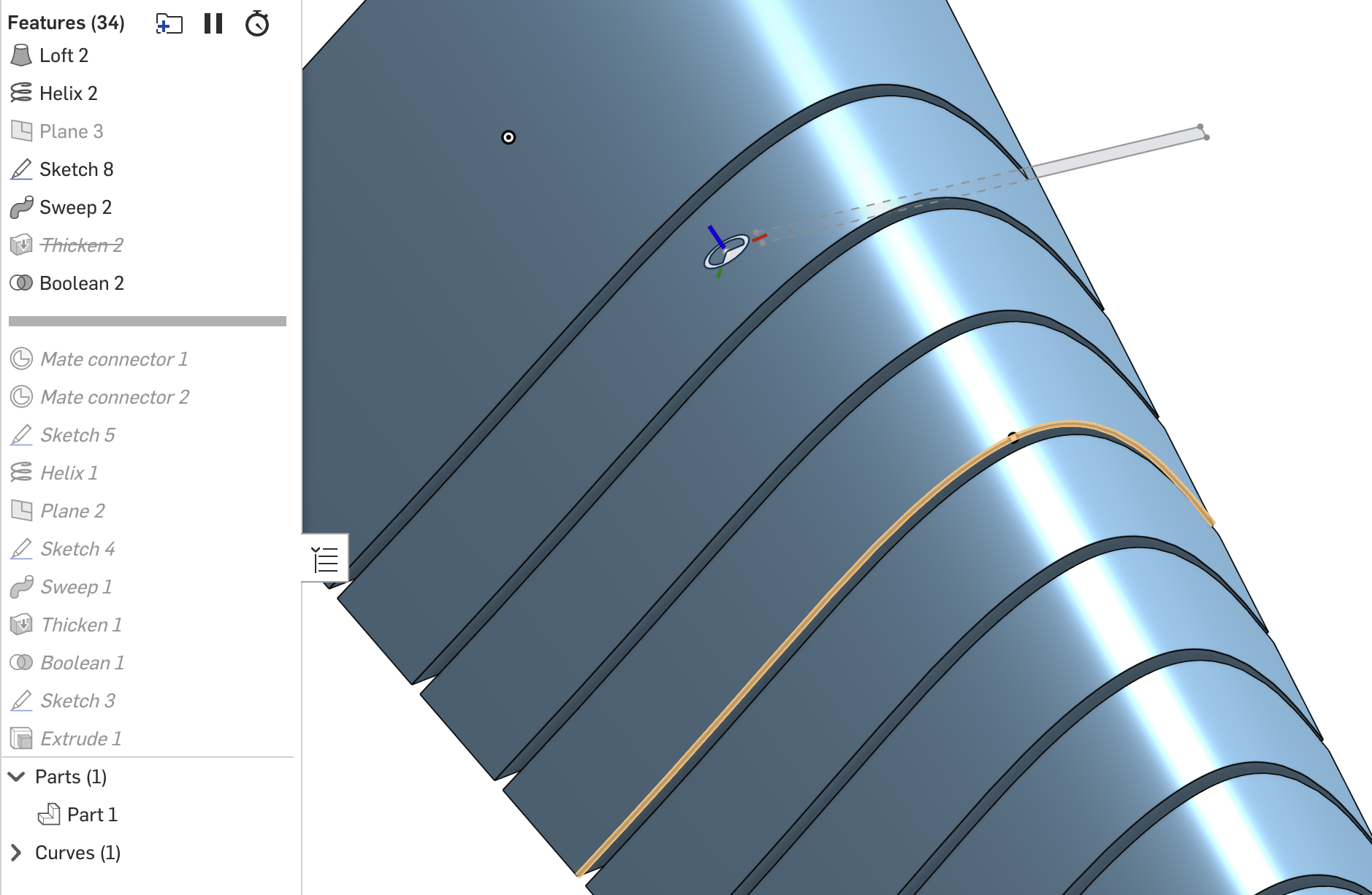

My boolean operation failed to return a valid part

I can't seem to understand why….

    It looks like you might be making non-manifold geometry with the resulting solid. It works if you turn that sweep into a solid, rather than sweeping the surface and thickening.
