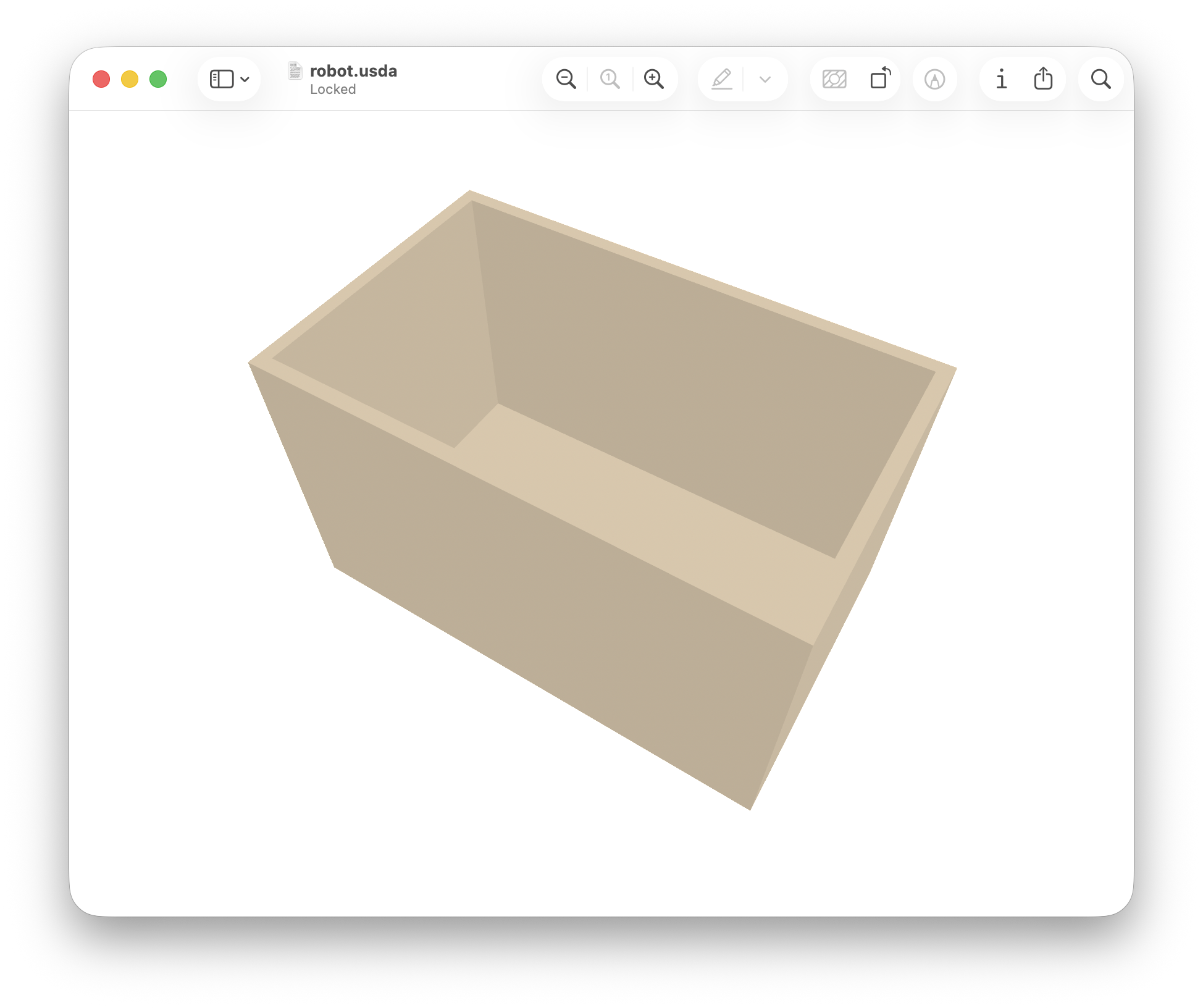

    I gave a try with the model you shared (the public link is helpful!) and Omniverse Publisher appears to produce valid USD inside the .zip package, with the .usda file in the root specifying the composition of the asset, plus the meshes/ directory with .gltf sub-asset geometry.
    After unzipping the package, I was able to view the USD using macOS Preview:

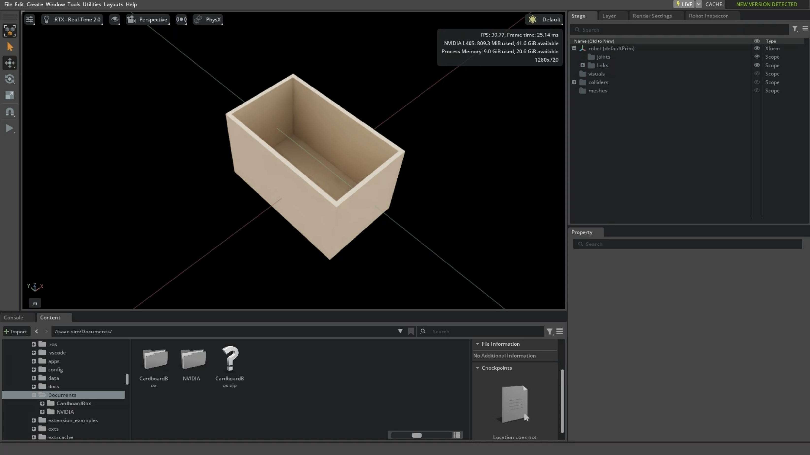

    I was also able to open the USD in Isaac Sim 6.0.1 NVIDIA Brev Deployment:
    I have previously tested Omniverse Publisher using NVIDIA Isaac Sim™ Development Workstation (Windows) (when the workstation came with Isaac Sim 5.x) from Microsoft Azure Marketplace, but for your model I only checked in macOS Preview and NVIDIA Brev Isaac Sim 6.0.1.
    So, my hypothesis is that there may be some trouble with the Docker image you're using, or perhaps something else about the system configuration. It may be worth trying an alternative official way of installing and running an up-to-date version of NVIDIA Isaac Sim.
