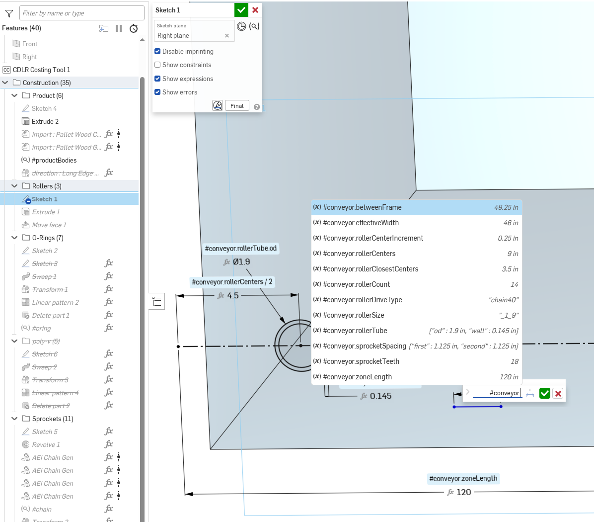

Map Variable Auto-Complete
Users can now more quickly reference the values from a Map variable by their key name by typing the name of the variable, followed by the period or an open bracket. Then, all the user needs to do is simply select the appropriate key-value pair from the drop-down list saving time when using these types of variables in Onshape.
https://onshape.wistia.com/medias/dmubsjdlvw?embedType=web_component&seo=false&videoWidth=960

    That map variable change is gonna be huge for quality of life. I've been avoiding using them because I've always found them clunky to set up and clunky to use, but it's the best data structure in a lot of cases.

    Yessss! I am so here for the little quality-of-life things. To me it is symbolic of care and attention to detail, and not only developing things that make sense as a bullet on marketing materials. It's design for the people who have already committed to Onshape as much or more than it is for the not-yet-users
    Map autocomplete is something I've wanted since I knew you could use maps in variables. Suddenly it becomes a useable and preferred workflow for grouping variables instead of a neat party trick.

    I THOUGHT I WAS THE ONLY ONE USING MAP VALUES! This got me so bloody excited I can not even explain. I feel so seen! For those of you who haven't used them before or have fallen onto configurable variable studio's, I can say from literal professional experience, map variables are a much more intuitive and simple workflow;
    I work in joinery and I use the architects nominated material tag (ex. LM01) as the variable name and I assign different material parameters based on the stock we order:
    assignment →
    LM01
    {"name":"Laminex - Polar White Gloss","thickness":16mm,"laminate":1mm, "max_width":1190mm}
    use →
    LM01.thickness

    Awesome! Map auto-complete!
    I use featurescripts to build and manage a map of parameters and use those across multiple part studios. It was always a pain having to type out and memorize all the keys and how many levels deep. This will save a bunch of time!
