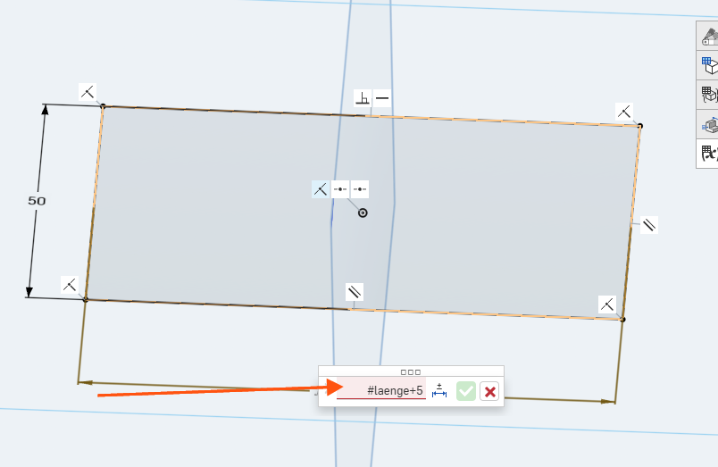

Calculating with variables only works with * and /. When I try to use + or -, the field turns red. What am I doing wrong?
Example: #high+3
    S1mon Member Posts: 4,636 PRO
    All dimensions are “values with units”. Try #high + 3 mm
  • EvanReese
    Simon is right. Here's a video I made a while back that will hopefully help build an intuition for it
  • _anton
    edited August 10
    Kevin also wrote a good explanation for units way back when:
    If it helps: internally, everything is in base units (meter, radian, etc.), so, if you write 2 in, that evaluates to 2 * 2.54 * centimeter = 2 * 2.54 * 0.01 * meter = 2 * 2.54 * { "value" : 1, "unit" : { "meter" : 1 } }. Math operations check at runtime whether they're valid and error out when an unsupported operation occurs, like adding a unitless 5 to a length. Multiplication, of course, is valid, except when you end up with stuff like an area in a length field.
