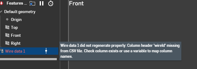

Hi I am new to using the custom feature for wiring created in OnShape. I have been stumped because I am unsure what I am doing wrong.
Importing the CSV that I made from Excel works fine, but I keep getting the regeneration error when I try to import Wire Data into the Part Studio.

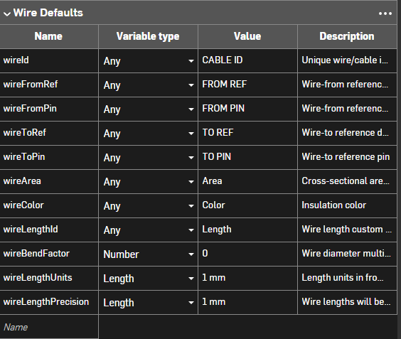

I have already created a Variable Studio that I added to the Part Studio to define my column headers, so I am unsure as to what I am doing wrong.
Error Message:

Variable Studio:

    Please attach the csv file here so I can take a look - make sure that you exported from Excel as csv and not UTF-8 csv.

    Hi Neil, thanks so much for your response and advice. Sorry for not seeing this sooner. I was able to get it working by changing the names from for example, "CABLE ID" to "Wire ID". I copied all the names in the tutorial and that seemed to fix it. Not sure about the reason, but it's working. I initially wanted the column headers to be the same names as the ones the electrical team uses in their cable schedules, but I can't seem to get that to work for now hahah Thanks so much for this. The wiring itself is intuitive and very helpful for us.
