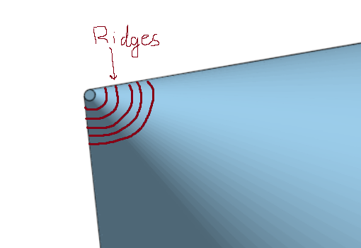

Hi, I'm working on a school project where I need to model a bunch of tiny steps onto a nose cone. The finished product will basically be a nose cone with a bunch of concentric ridges (1000+). I have the nose cone modeled, but I'm having trouble creating the little ridges. I've tried using feature pattern, but it doesn't seem to work. Can I have some help?
Link: https://cad.onshape.com/documents/7391e5a0490b42447ce0ff5b/w/53872c7c5b423e4986a5c184/e/04adc8ae18645be2e5e6e869?renderMode=0&uiState=6a978080c791f3c69a051e4f
(apologies for my bad MSpaint drawings)

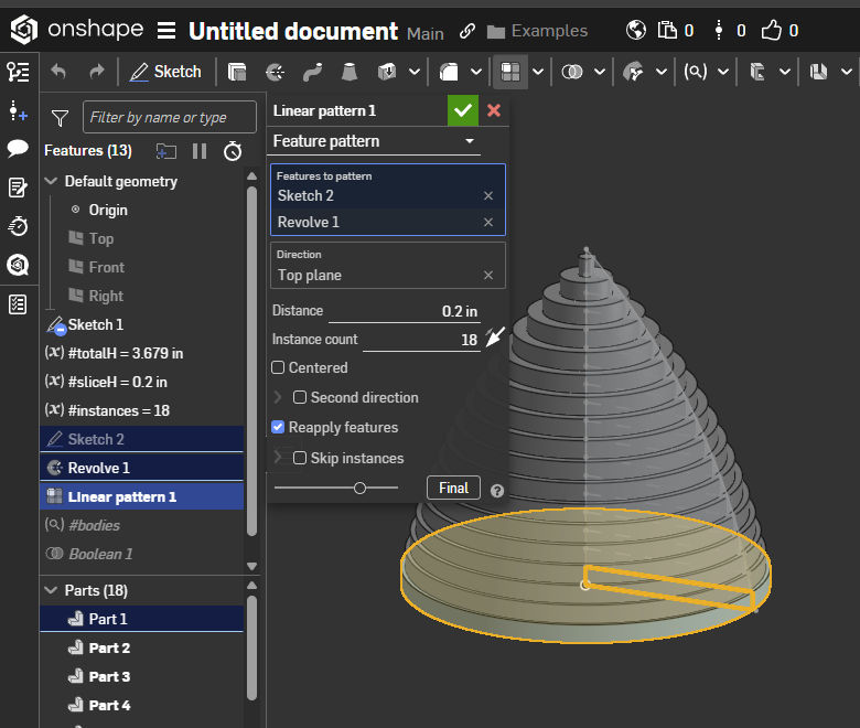

The example above was for even vertical steps, if you want even radial steps you can start from teh top like this:
2

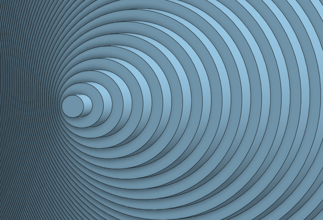

Hmmm ... not sure what purpose these ridges serve and what rules they are to follow. Constant ridge angle? Constant slope width?
A crude approach could be like:
If we knew what rules apply, there could be a more parametric approach.

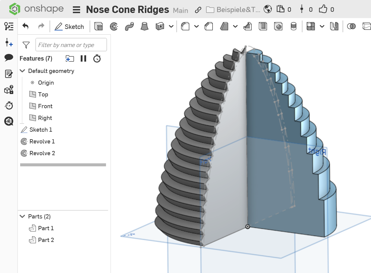

This would be a pretty simple Custom feature to write. Like a basic slicer - I think a few people have done so in the pas (and I know this guy "Claude"….)
1 -
Yes, probably a Feature Script. I think it would need to be a bit more elaborate than a basic slicer, because delta Z would possibly have to be modified for each slice.
maybe I could help if you actually let me copy your document.
I was going to suggest using the Topographinator FS but it's kind of the "reverse" of that…

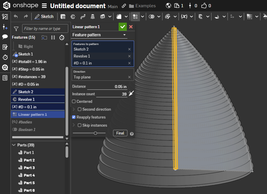

It could be a good starting point to create an FS for that.I think this could also be done with a pattern and variables though, as shown here:
Yes, that's also nice, with the corner of the copied rectangle always being trapped on the curve.
