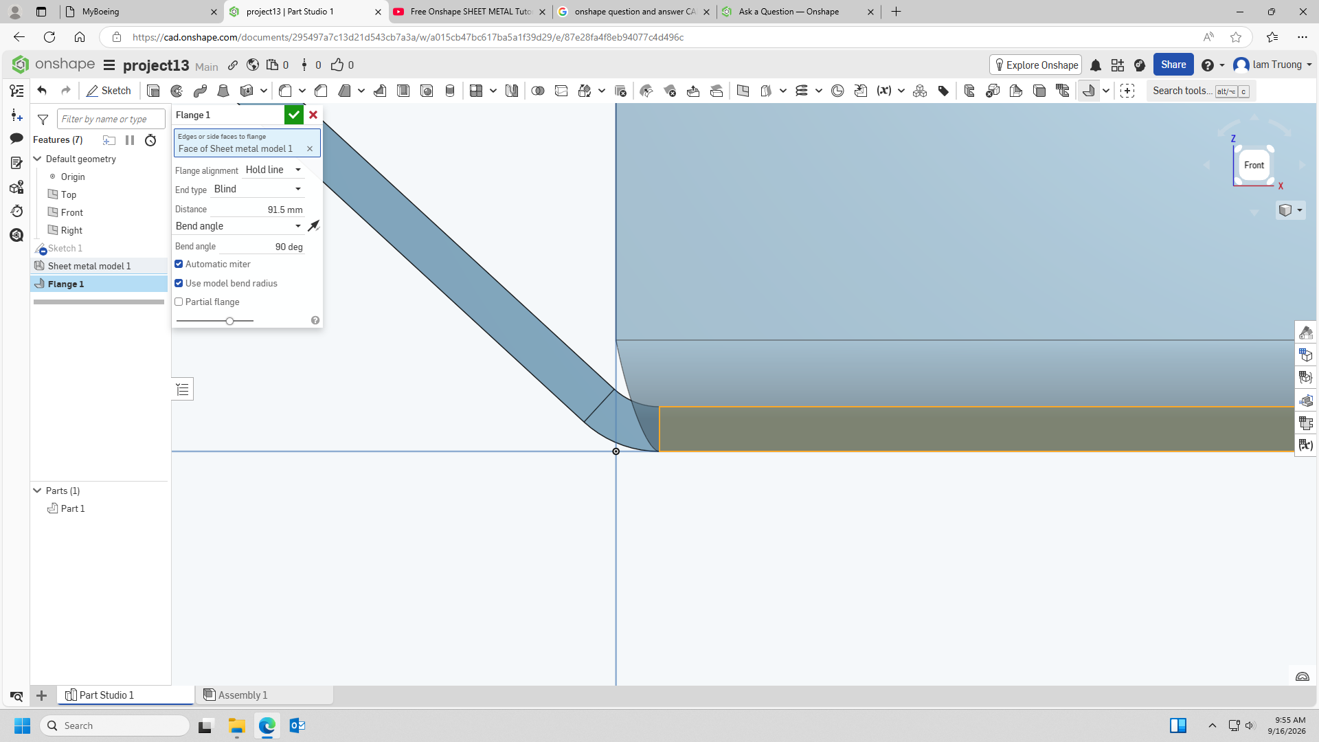

Hello everyone, I just started learning onshape follow youtube videos. I want to create a flange which go straight up from the line that I picked, but seem like it keep create an angle close to the origin point. I tried to switch Flange alignment option from Hold line to Inner, outer and middle, it was pretty close but still not what I expect. Please give me some help to fix it. Thank you very much everyone.

I think it's the "corner type", you can either create like and add a corner feature, or probably the better option is to go back and edit you sheet metal feature and specify the corner type to "open".
