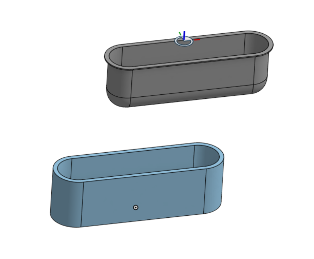

Hey folks,
I'm trying to create a screen that would live against this filter material seen here on the inside.
Screen can be anthing such as surface with lots of holes in any patern or shape. The only need is that the screen is seen as the support for the filter material (seen here) as the air will be pulled through the filter from the inside of the oval. Think Car or motorcycle filter.
Without support, the filter material would simply get sucked into the engine! Make sense?
To be sure, I've tried several ways and have always failed. I'm just not savvy
enough with OnShape to figure it out.
https://cad.onshape.com/documents/e8bc2dfa352d44864b7ddb79/w/c4d8feaf25428ee3d6f7714c/e/0417076a5c7a010722e8685f?renderMode=0&uiState=6ab41db8dbbe68c66cf329ff
Thanks in advance.

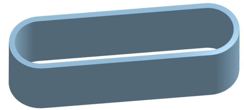

    Hey Price. Ah, now I see what you are after. This Document is my hack for achieving something that may be of use. There's gotta be a more technical way to do it other than adjusting variables to get something of use.
    I first made a cylinder and made a sketch of holes to Wrap on the cylinder's face and, with the Remove option, created the holes in the cylinder. The cylinder was split using a previously created plane and then the cylinder half was Mirrored using the same plane.
    Another sketch of holes was created on a plane tangent to a half cylinder face. The rectangle containing the holes was made Using the edges of the opposing cylinder halves. It was then extruded the Extrude Feature was Mirrored to get the other side.
    That's the gist of it. although something of a hack, it may have a method or two you might be able to employ. - Scotty
  • robert_scott_jr_
    Hello. So, you just need a filter with a lip to keep it from getting sucked in? - Scotty
